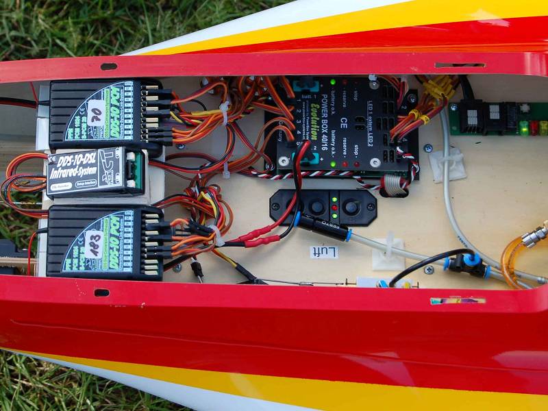

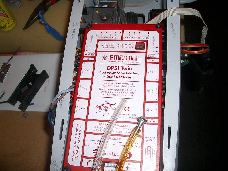

Well I now have the Emco system manual and taken a look at their web site. Yes it looks a good system BUT has some immediate shortcomings:
It is only an 8 channel unit.
If using two frequencies it APPEARS that they must be on separate bands, eg 35 and 40 (40 is only for surface models in UK). Its not offered on 36 MHz. but perhaps the frequencies are defined by the actual receivers, not clear on that yet. They do not offer a single, dual frequency, HF unit which can be plugged into, say, a 10x.
At 369 Euros to which must be added the cost of the two receivers, it is no significantly cheaper than the Weatronic DR which in its current form still offers a vastly greater range of facilities than the Emcotec.
I will research further. inc the ACT DSL system In the meantime I am committing to the Weatronic system.

Just a precision about the DPSI twin it does not request a seperate band if using two freq's, well in fact it depends which twin HF module you would be using. If you would choose the Emcotec twin HF module then yes you would need to plug two different band rx's. If you would choose the ACT twin HF module then you could plug to rx's in the same band. This is specified by the TX not the RX. As said before I don't think any of the 2 systems use proprietary RX's so you could use ACT twin HF module to run DPSI-TWIN. For the 8 channel limitation I wonder about if this is an issue in case of interference that you would be unable to lower your tailhook ? Seriously as long as you have all vital controls plug on those 8 channels and the remaining channels on either rx directly I don't see it as a BIG shortcoming but again this is a fact and I don't discuss it.

The Emcotec DPSI-TWIN is a nice unit. I will switch to the Weatronic or the ACT (most likely the ACT) when available on my band.
Some people will like the fully integrated Weatronic system, others (like myself) see big advantages to being able to seperate the receivers (and their antennas) remotely in the planes. I can then plug servos into whichever receiver they are closer to.
Also, I am pretty sure the ACT T3S system will allow transmitting on 2 channels right now, on any band in any combination.
