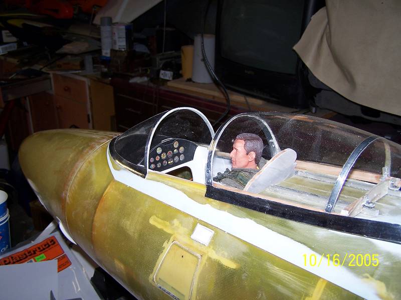

It is gonna be more work than it was on the Ziroli. But it should look better due to the separate canopy frame. You will need a 3 5/16" air ram from GN models some 3/16" brass or Aluminum sq tubing, 4 -1/16" dubro ball links and some 1/16" aluminum stock for the open front of the canopy. refer to the pictures of my Ziroli

Thanks Terry, but where exactly are the rails and where do I find them? I never did this job before. Want to try it in my cat, the way she take off and land was with the open canopy if I'm not wrong. I saw some pics of the AW cougar tha may help.
What servos are you plan to use in yours?

In the pictures above there are 2 rails behind George and one on each side of his shoulders. The ball links that are attached to the front of the canopy frame slide in the rails on each side. (by his Shoulders) and you can see the frame, I built, that goes across with the other 2 ball links that slide in the rear rails. The cylinder is not yet installed in these pictures. It goes between the rear rails, which are covered when the canopy is closed, and all are visible when open. AS per full scale.

oops! I looked the pic again and saw them. Are those the 3/16 sq tubin for?
