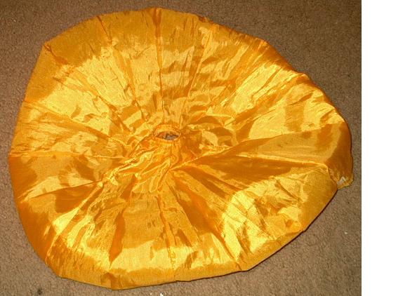

Well guys I have been trying to come up with a drag chute for the BVM F-4. matt Carroll and Paul Bagaman came up with the info originally. This was the info used in the design of Joe Grice's chute according to it.
The good part is I have one complete chute in my hands and all that is left is to rig it and perfect a coouple small things. I am hoping to have this worked out by the end of this weekend. The other good news is that I have found a seamstres who is willing to do the work. So it will just be a short time before I can bring these things to life for those of you who are interested. They are rather labor intensive, but the results speak for themselves I believe.
I won't let any go until I get some basic testing done on inflation and such. This shouldn't take long.
John Redman
Team BVM, Jet Cat USA, Shultze Chargers
One other note guys, have patience. When I have this project complete I will post it here and will let you know cost and delivery lead time. This will take a little time, so just hang in there with me please.

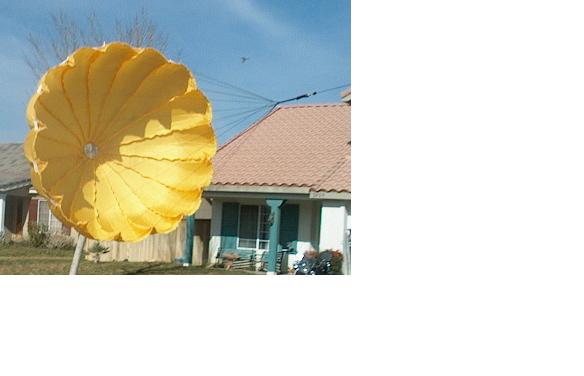

Default Drag Chutes
Well guys the basic testing is complete. Chute inflates well at 20 mph all the way to 45 mph. I have the main leader breaking away at 55 mph. I will continue this testing to ensure it occurrs every time. Won't sell any untill I am positive this will work every time.
As for coming in white, that is no problem. The problem lies in that you cannot dye this material according to the fabric store ladies. They say it will come out blotchy due to the high polyester/silk content.
The color of the yellow I have is too dark for the standard chute color. I have Bill Brundle checking things out in San Diego for a more corerct color. If I have to I will make a trip to the garment district in LA to see what we can come up with there.
The chutes are sewn together with a Surger machine to give the best wear capability in the seam department. Both the edges of the spill hole and the base of the chute canopy are hemed over for a nice finish and less chance of snagging.
Still refining the tape sets between each gore to get the most correct/nice looking opening on the canopy during inflation.
The current colors that I can do are all white, all yellow (as pictured) red, white, and blue (thunderbird type and I think the Navy squadron "The Sundowners used a multi colored chute for show work), and blue and yellow (blue angle type), and red and white (not ever used that I know of but it looks cool). The multiple colored chutes will run more money than the single colored chutes.
Current pricing will be listed if the moderators give me permission to (I will wait for their response). Other than that you can email me off line for pricing. Guys I will say they aren't going to be too cheap as they are labor intensive to make. They will come fully rigger and ready for use in your model.
Also I am headed off to the post office to get the wieght of the chute for info purposes. My guess right now is the entire chute is coming in at under 2 ounces.
John Redman

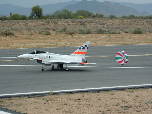

The Euro lands slow, but just looks great!! and very efective

What size is the chute you are using and how many panels (16) ?
Ian
Old 05-15-2003 | 06:23 AM
My Feedback: (8)
Posts: 2,317
From: Lancaster, CA IL
Default Drag Chutes
I can help you out there Ian. Geronimo's chute is a 16 panel chute which is classed as a sport chute. The 20 panel chute is the same diameter but has more panels for a more scale look. The 24 panel chute grows to a diameter approximately 1.75" larger.
The 16 panel sport and 20 panel scale chute are close to 16" in diameter when inflated.
The 24 panel chute is close to an 18" diameter when inflated.
John

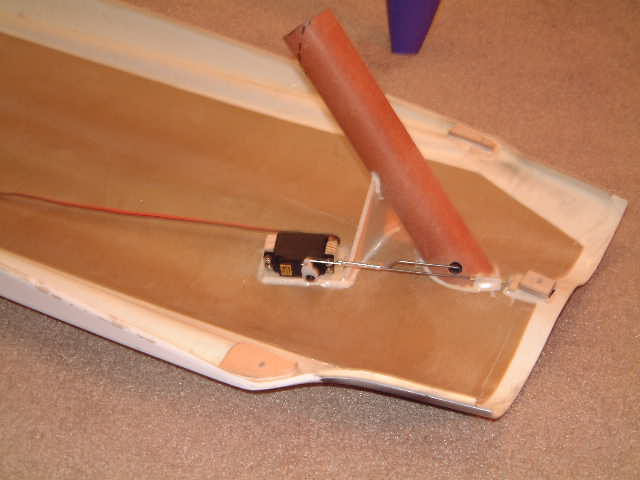

Here Is The Way I Install the Chute on the Euro,(Iam using Tam's Bifurcated pipe) and the chute Install Kit phenolic tube, the bottom door is made from polyply ,and there is an 'eye hook on the scale deploying point of the fuse, rigth below the rudder, and that's it, Works Every Time!

so it deploys out of the underside. I thought on the full size it came out under the fin where you have the attachment point.
Did you try at the fin position and it would not fit or work from there ?
