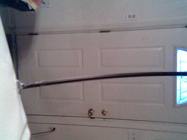

I fly a baby boomerang with mw54 MKIII, great engine by the way.
My issue is that on every approach about 12-15ft my plane gives me a nasty twitch for a split second, enough to require a change of underwear. It always does it, every approach.
My radio is brand new futaba T6EXAP.
Has anyone any ideas/suggestions,
Many Thanks,
Nick, jet rookie.

Default RE: Twitches
What i did is went to the car section at Hobby town and found an antenna $1.00 tube and a $2.50 mount. I didn't cut my antenna, just slide in the tube and place the rubber cap and you don't have to worry about cutting or lost signal unless you have a bad RX.
This works for me on all of my turbine's.

Old 09-18-2006 | 06:15 PM
My Feedback: (51)
Joined: Jun 2003
Posts: 207
From: JACKSON, MS
ORIGINAL: G-ROOKIE
