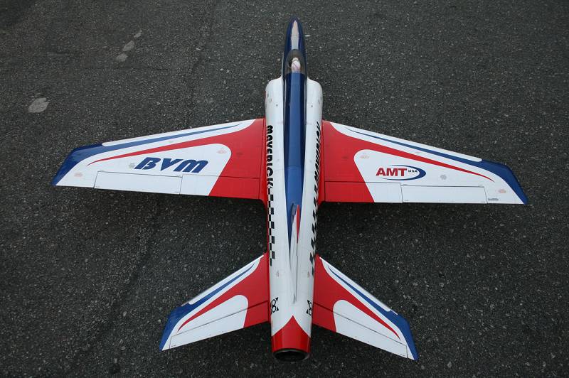

Has anyone used Gary Muellers conversion with inlets,tanks and pipe.

Ha,ha ddue where were you 2 weeks ago.
I had a Mav that went down with the inlets, Bypass, tanks all the works. I decided to build another one.
I did not do the original conversion (turunurn was the one who did it). it came out great and the plane flew fine with a 12lb Simjet 1200.
I think the inlets were form a BVM Bandit though. It was a pretty straight forward conversion. Plenty of room for Jet Tech tanks.I will start Mav2 soon.
PM me if you have questions, or go to Brain directly as he is an expert on this issue (a.k.a turnburn).

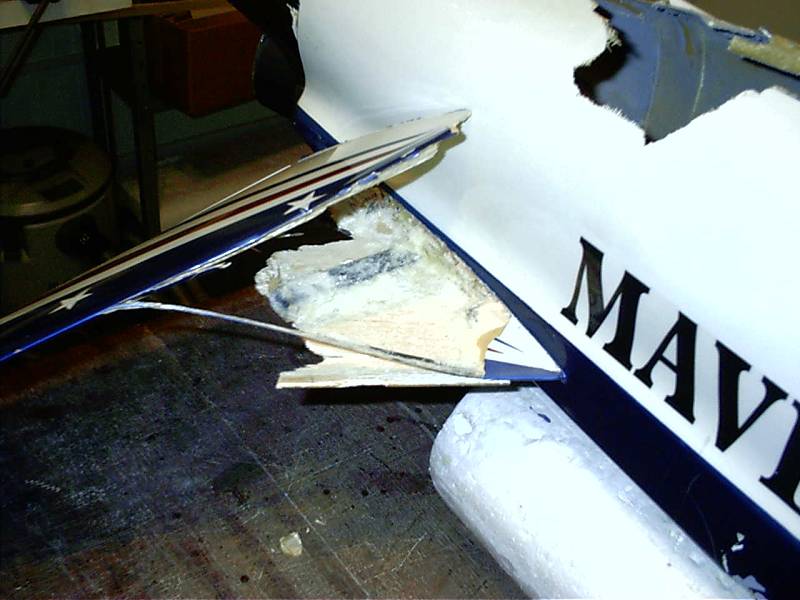

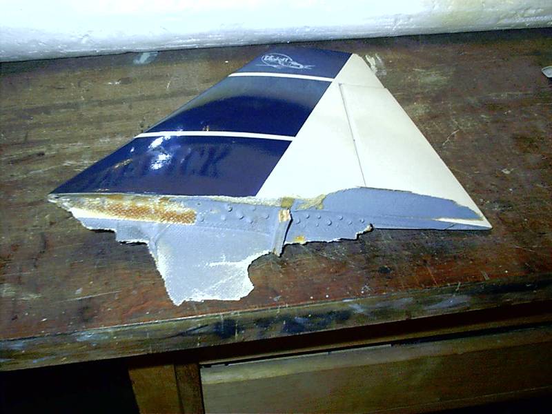

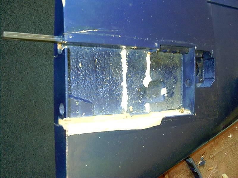

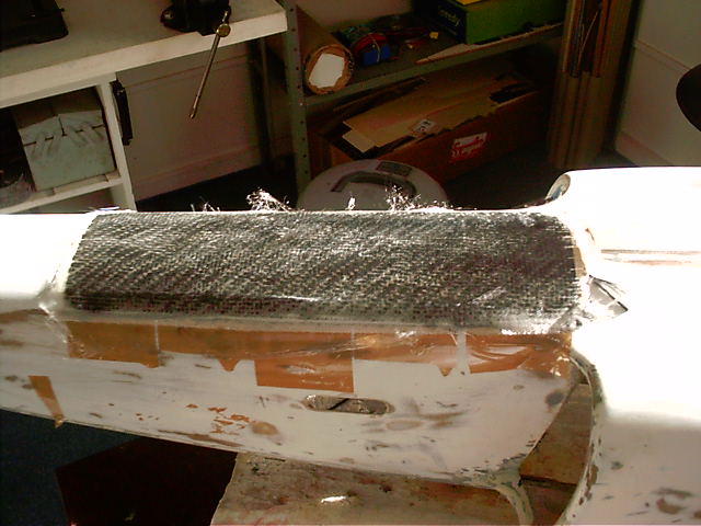

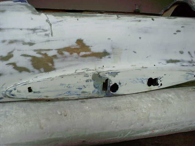

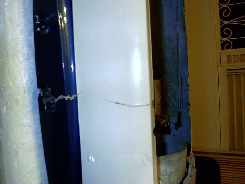

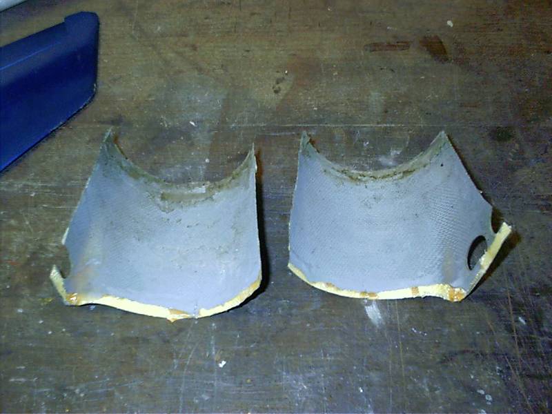

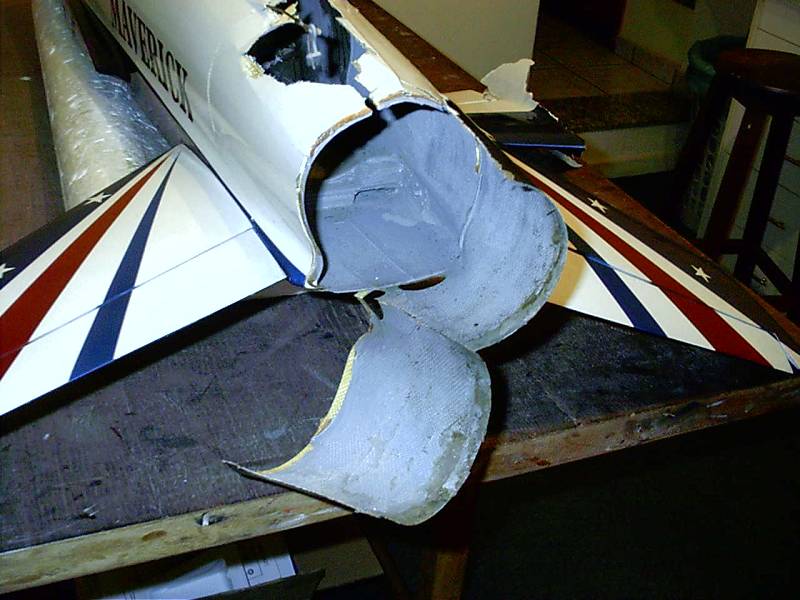

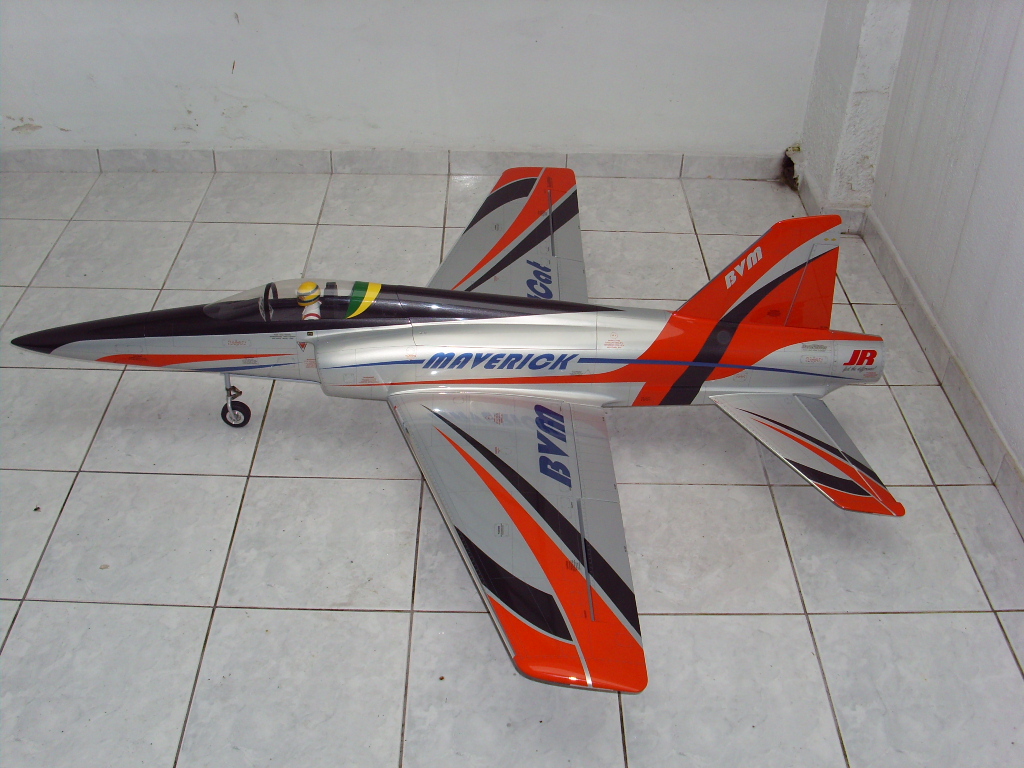

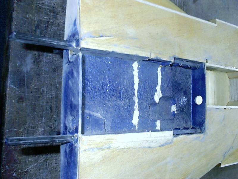

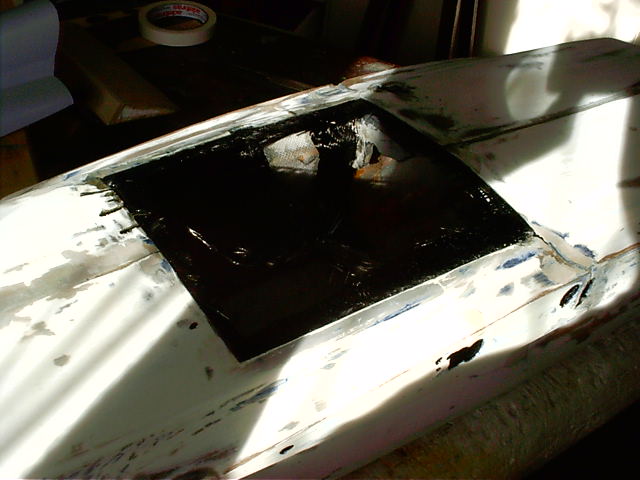

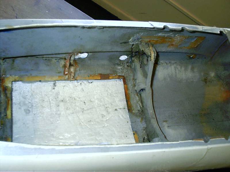

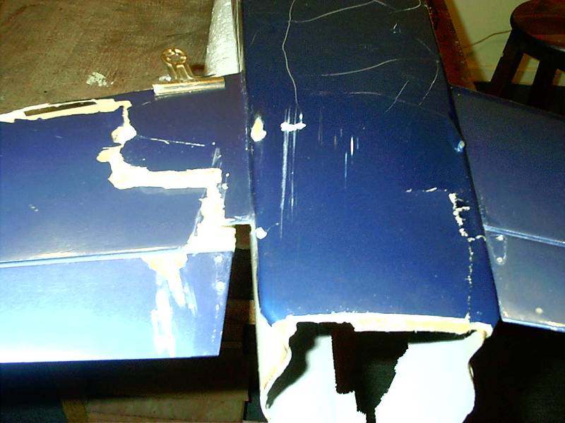

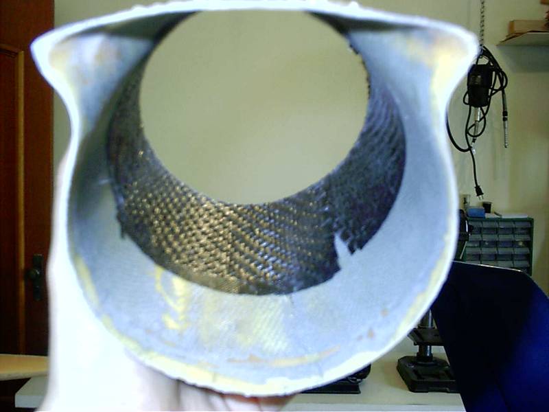

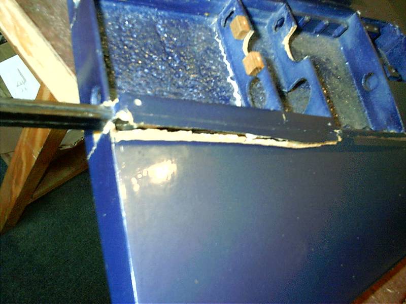

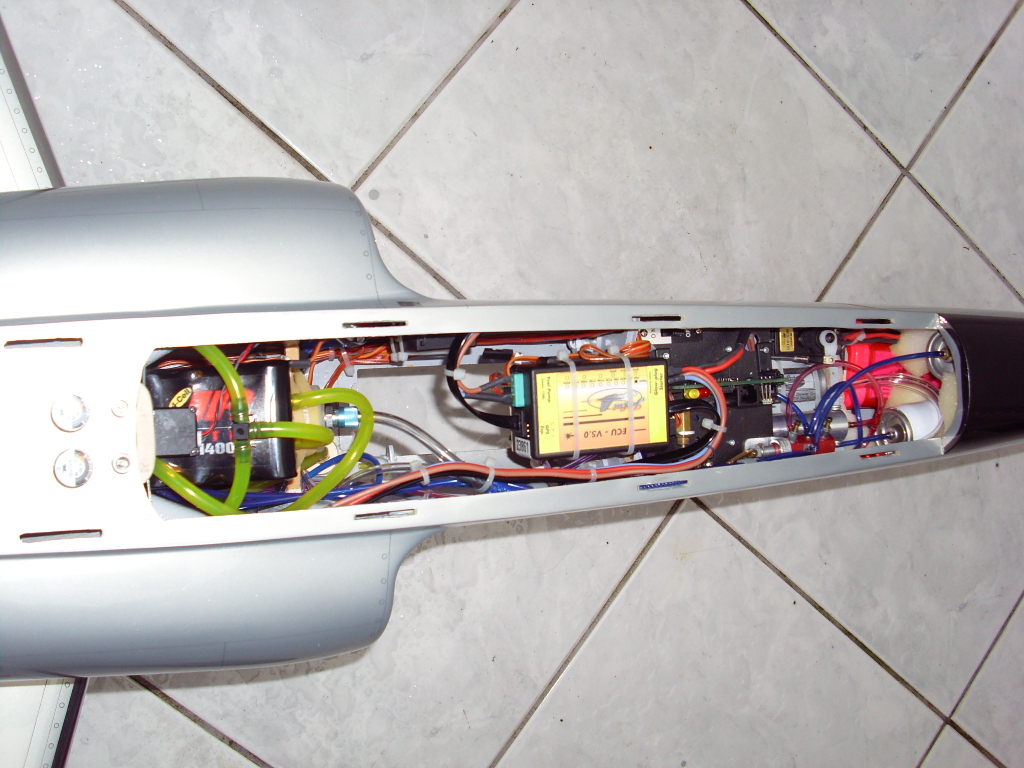

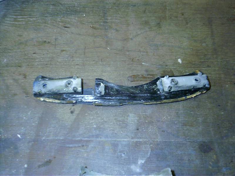

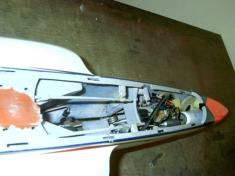

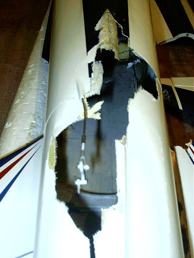

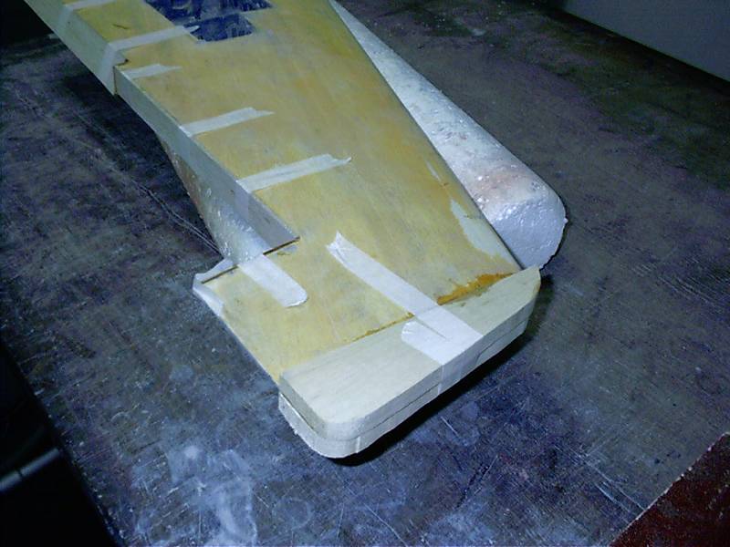

so here´s the story, a client that is a friend as well arrived with a battered mav with fan, and said, could you convert her to turbine? i looked at the poor looking airframe and said, only conversion, no make up on this terrible paint job ok? then he bought everything and kept flying the plane. when Gary Muller conversion kit arrived with the bvm new strnger struts, wheels, brakes etc, he made a last flight with the fan, on the final approach the engine quit and the plane made a roll over a wall, the results will be shown at the pictures....
he came with the remains and asked me to made the conversion! i said, no way, the airframe is lost, i am terribly sorry ! he argumented that spend a lot of money with the conversion extras and had nothing to do with them.....a really sad story indeed.
i had a deep thought and said, ok, i´ll re-do the whole plane, but no time line and no pressure, just forget her here at my workshop ok? he got the deal, after 2 years i´ve finally finished her...below a few pictures of the plane. looks like i´ve managed to make it decent...

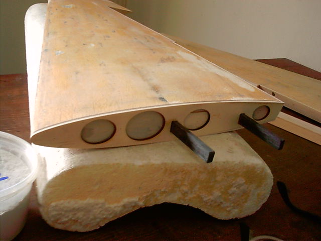

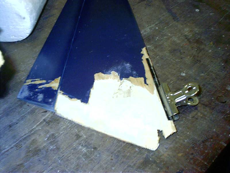

Old 06-07-2007 | 10:39 AM
Posts: 401
From: sao paulosao paulo, BRAZIL
Default RE: Jet-Tech Maverick conversion

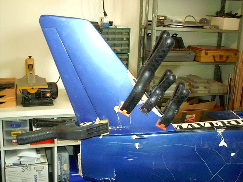

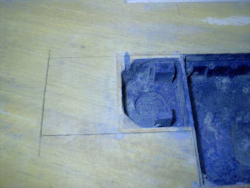

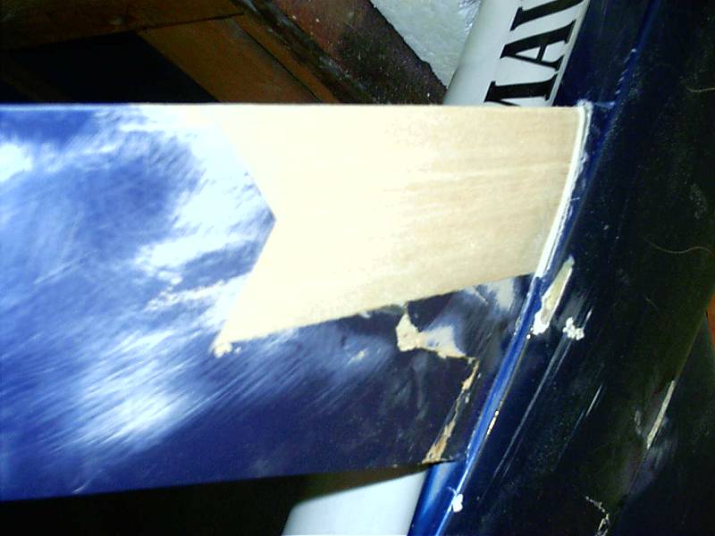

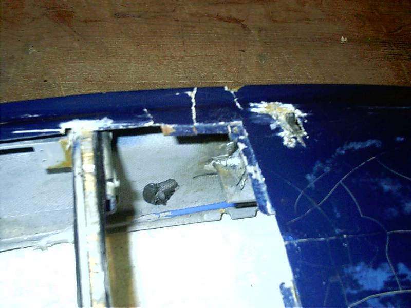

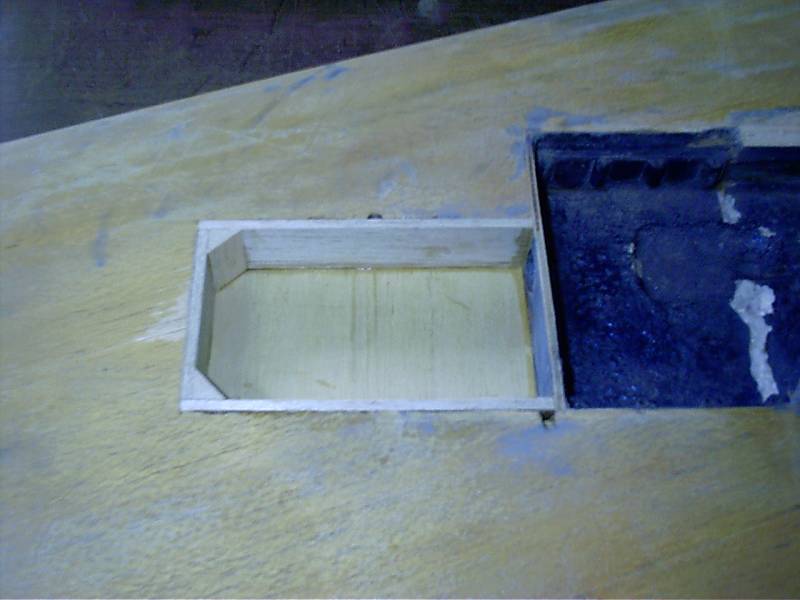

now pictures of the work in progress , as you can see, the first builder of the plane dosen´t care for much quality and cleanliness

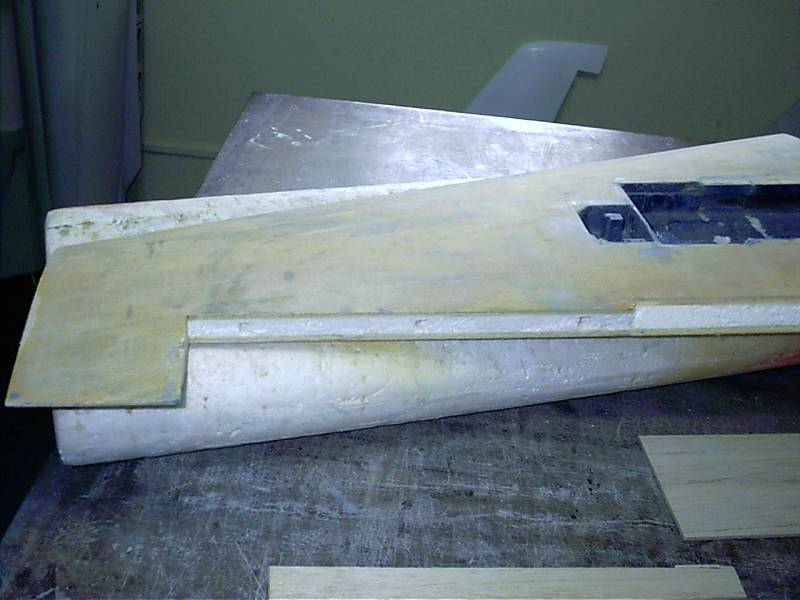

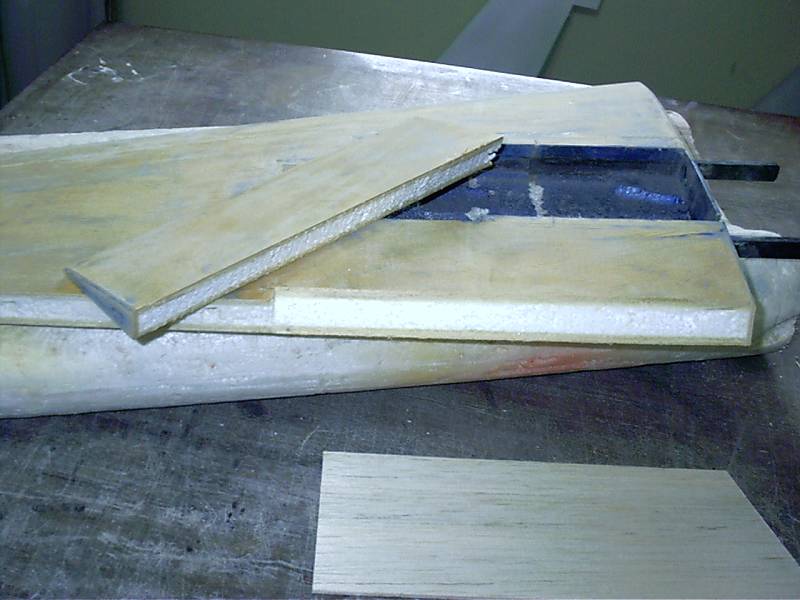

Old 06-07-2007 | 10:44 AM
Posts: 401

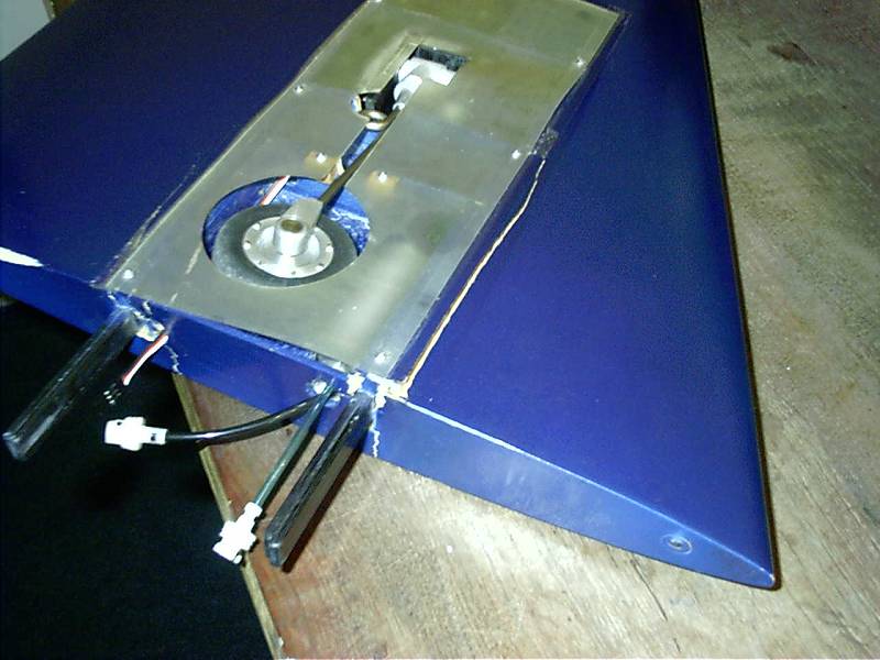

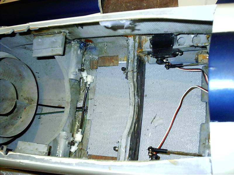

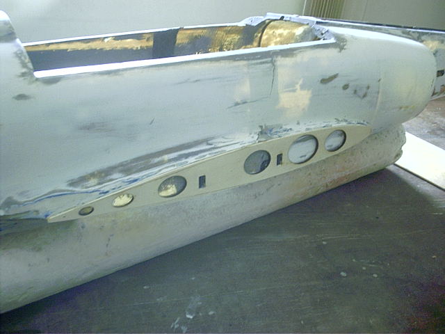

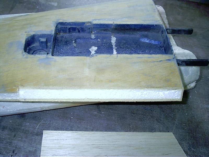

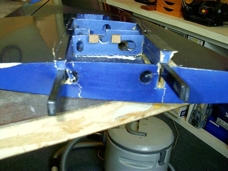

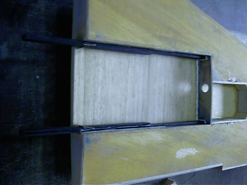

now working at the wings spars and gear bay, that looked really terrible the way it was finished before...take a look at the fuse cracks, everywhere!
i´ve ordered a new top hatch and canopy hatch from bvm, and replaced the wing spars holders with new ones.
flaps where added and new stilysh wingtips, as the squared ones are really bad looking

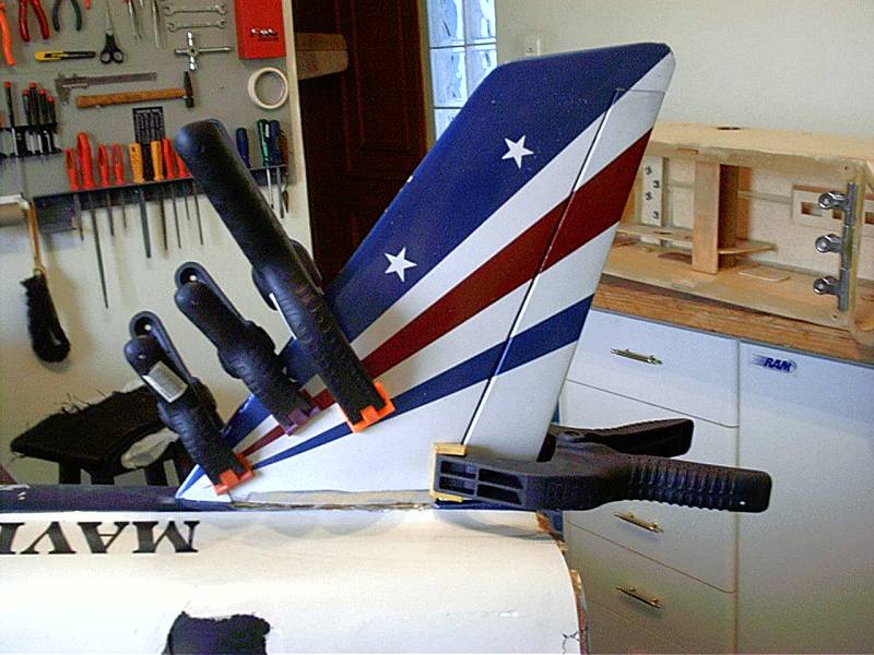

front gear door being molded and wing roots and fuse wing root capped with new laser cut 1/8 ply reiforcement, as the fise and wing root where really cracked!

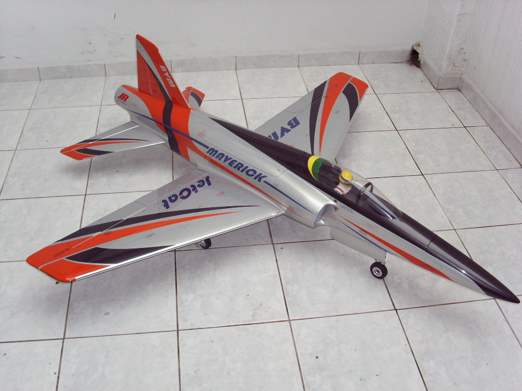

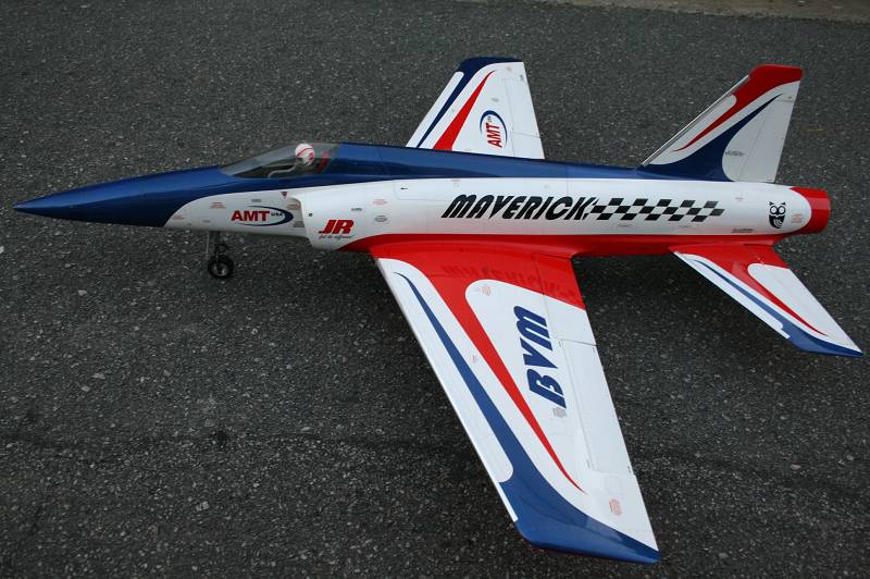

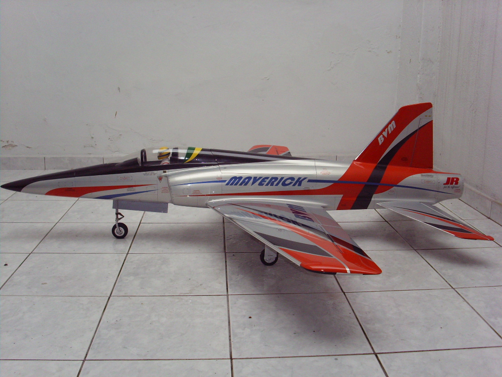

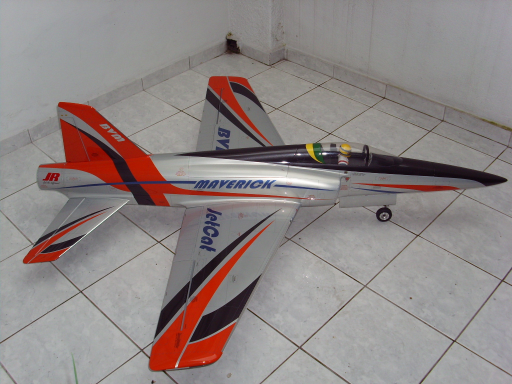

Old 06-07-2007 | 10:58 AM
Posts: 401

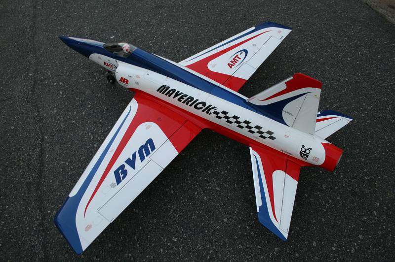

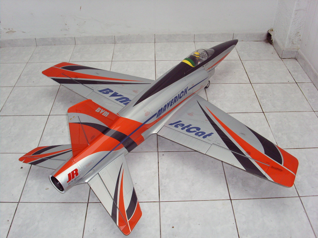

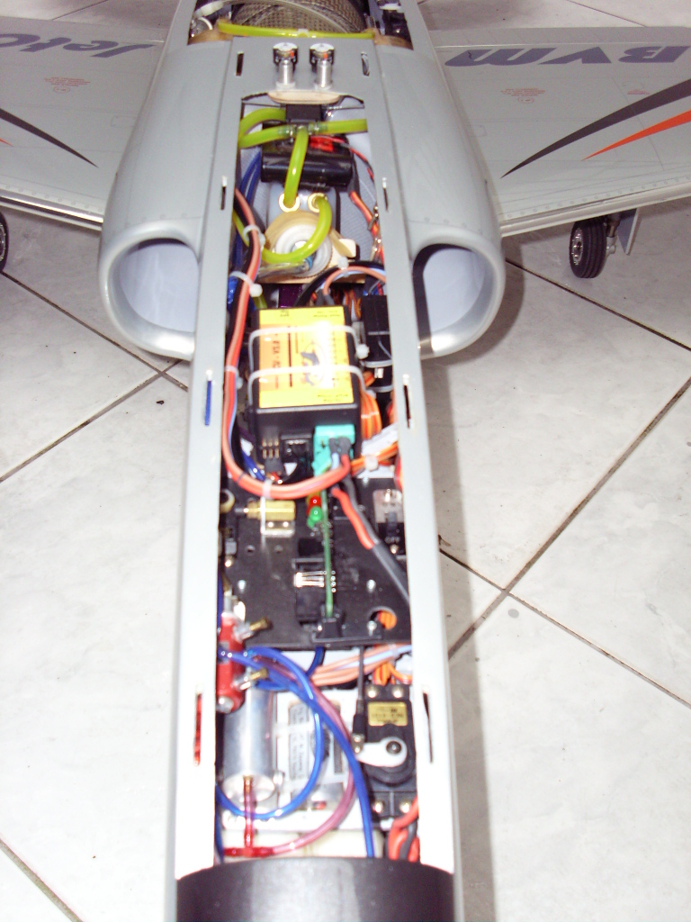

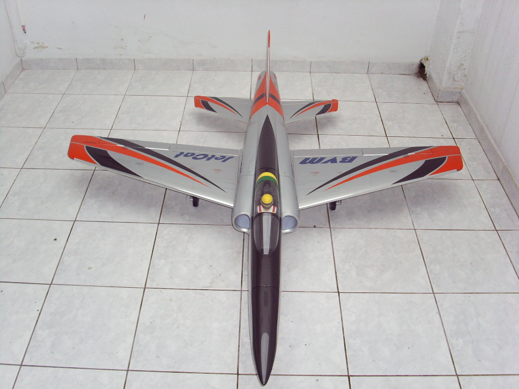

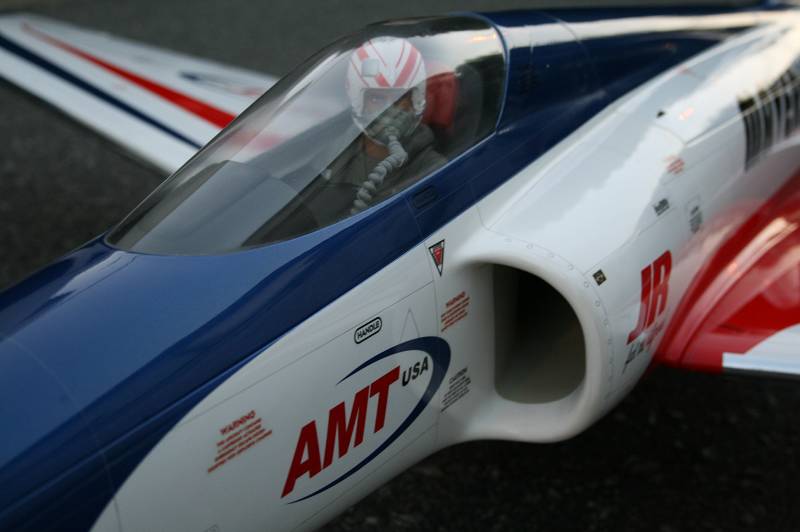

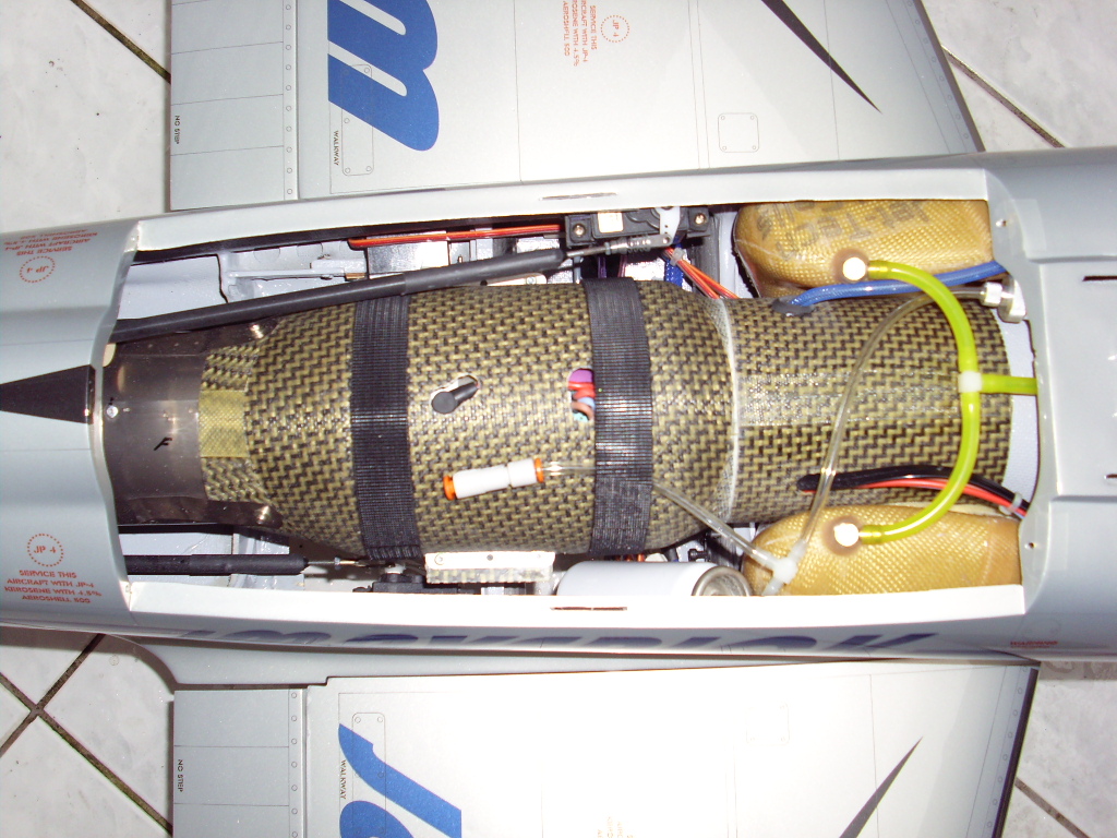

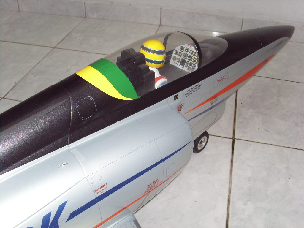

then i gave up taking pictures.....

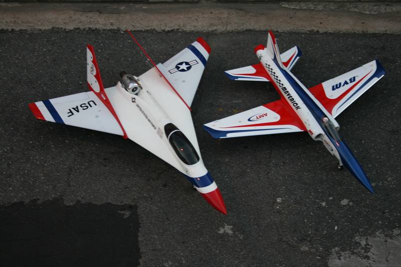

here´s mav finished and ready to go, along a newly finished hotspot

Old 06-07-2007 | 11:21 AM
JetCatJimmy's Avatar
Joined: Mar 2007
Posts: 462
From: Phoenix, AZ
Excellent job! I WISH I could build as well as you. That is incredible.
Old 06-07-2007 | 11:57 AM
My Feedback: (49)
Posts: 2,987
Received 20 Likes on 18 Posts
From: Plymouth, MI
Facmaster,
Great job! That's similar to what I went through, except I managed to find a new fuse. Just need to paint mine and install everything.
Please post pictures of your turbine and equipment installation.

Old 10-17-2009 | 04:25 PM
Posts: 401
a new conversion has been finished! this time with a jetcat p-60
maiden will be within weeks!
