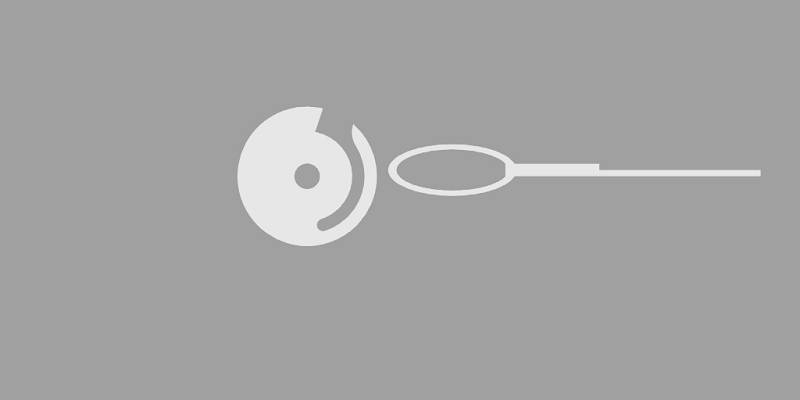

Hey guys, I will be starting a new project soon (SU-27) and wanted to get some ideas on how to make the release system for a chute. I have never had a plane with a chute . I would like to know what works? Any info would be great. Thanks, Billy

Hi Billy,
on my F-4, I kept trying to come up with a system that would break away if the chute released in flight, but it would always break on landing. I ended up using one of John Redman's chutes and it worked but I think it would not have broken off the plane if it came out while you were flying.
Also, with my F-4 it needed about 3/4 throttle just to taxi with the chute out so I really think you might want to be able to release the chute on command. You can of course design a system that opens the chute with a servo, then it releases the chute with more travel. That was not practical on my plane. Also, I did not have any more channels to have a release, but I had an idea to do a release with no extra channels.
You could have another servo for securing the chute to the plane and tie that to the flap channel . When the flaps are up, if the chute inadvertantly deploys it will just fly off the plane. When the flaps are down, it would lock the chute to the plane. After you land, you raise the flaps and release the chute.

As Matt stated the chute I have is so light it stays fully inflated during taxi and the model can be hard to taxi back. The best thing to do is to release the chute after landing. David Ried deployed my chute behind his F-4 a couple of times in flight (by accident) and it left the plane every time. It will break away if the speed is above 60 mph.

you can use a servo and Y it off the throttle. Then when you have throttle movement you can release the chute at what ever throttle setting you desire. That way if it comes out in flight,a bump of the throttle and it is gone. This is what I use on the B-58 and it works great.

Hustler58, that arm looks very good, but does that small thin section hold the parachute on and nothing else? Or does that arm fit through another slot or hole that stabilizes it? Anyway it is a slick idea, very good

Mr_ Matt , the servo arm holds fine. Never had a problem,planes weight was 50# and the chute was 36". Just make sure the servo is mounted good. The line did go through a bulkhead to stop the side to side motion. Sorry I don't have any good pictures of how it worked. Butch

Thanks guys for all the info. This is the beauty of this forum. All these ideas from different ways of building really get the juices flowing. I will receive the plane next week. Then maybe with parts in hand I can figure something out. John I will call you when I get a chance. Thanks, Billy Edwards
Hustler, I like that design of the servo arm. I will try something. Thanks alot
