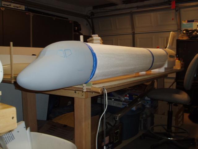

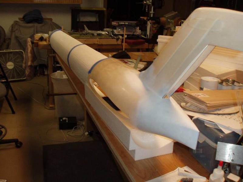

The Rauch airliners are a great place to start with something this large vs from scratch with only a 3 view and 144th scale model.
At least thats what I told myself when I sent a wire to Germany and 3 weeks later the parts were delivered for My MD-80.
I plan to include robart 630 retracts, robostruts, tamjets wheels w/brakes, Wren 44 gold turbines and as much scale detail as I can get built.
What I am starting with is just like Bob says the nose, tail and nacelles and a small drawing (in German) with dimensions for locating just the basics.
Not shown but should be added to the instructions are the LE & TE stock, landing gear bracing, hinge locations, hatches, servo and radio placement, component location, just like a scratch build you deside where everything is going. I wouldn't recommend one if your an ARF flyer there is going to be some dust in the ol workshop building one of these but if you have ever tackled a Ziroli or TF design this will be a piece of cake. I love the moldless construction for the fuse center section and flying surfaces. Getting a hotwire cutter is way less expensive than paying someone else to cut a few pieces of EPS for you. I was astounded that TdL had quoted me between 450 and 700 to cut this kits foam parts with the CNC machine. I don't claim to know how to program one of those machines but the non CNC hotwire setup cost under $50 usd and the foam was half of that! I spend a day making templates and drilling holes in them for nails, thats the only advantage CNC would have it doesn't leave nail holes. I can live with them heck they will give the epoxy some more bite anyway! here are some of the 30 seats I just finished cutting with the hotwire complete with overhead storage bins and a cargo bay.
I'll be happy to e-mail more if anyone is interested. Here is a Rauch A330 flown with a pair of P-80's, his videos are on the center of the page and more construction photos too.

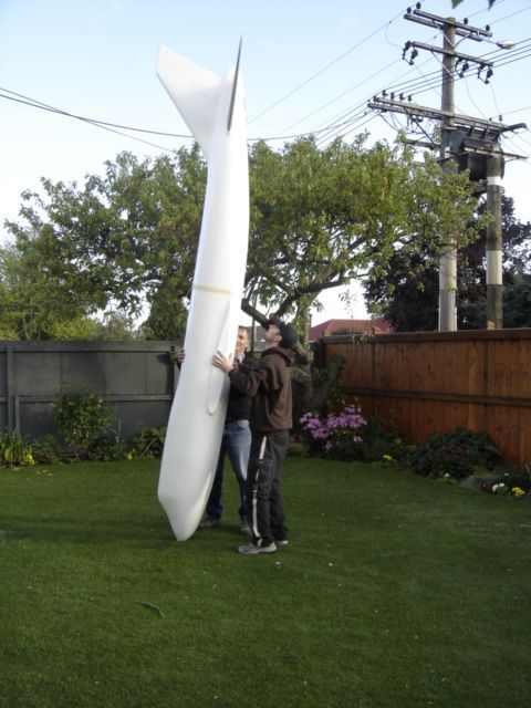

Sure Terry I just figured out where the picture button is.
Here is the left half of the fuse just cut waiting for the balsa planks.

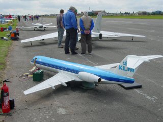

Hi Pete, you can have my twin RTF Fokker 100 cheap if you want to have it shipped from the UK
This is petty unique I think and as far as I know the only model one flying worldwide.
Uploaded low res flying vids here http://www.youtube.com/watch?v=ySczA6R_BsA
and here http://www.youtube.com/watch?v=9wdAw2Dp4n0
Second much longer clip includes an eventful landing with one flameout on approach.
Rob.

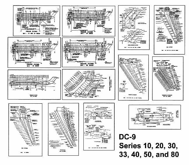

Iv'e been getting a lot of pm's from guys looking for these airliner drawings.
I went hunting and I guess there's around 20 or so drawings that can be had for the DC-9 and DC-10.
All the right stuff for building a model.
Some are pretty big, "C" size and "D" size. Some are in good shape, others are kind of beat-up and rugged. I don't think Kinko's will do 42" paper. Anyways, for those that sent me pm's, give me time to figure out the best way to do this.
This is maybe half of the DC-9 collection. Each one is a drawing size of 2 x 3 ft. Times 14 sheets would come to over 84 sq ft of paper! And there's still more! I'd have to mortgage my house to satisfy all the pm's that I got but Kinko's would love it!
If these don't print out for you I guess another option might be to make some sort of "reduced" master with everything on one 3 x 3 sheet of paper as opposed to a bunch of individual 2 x 3 sheets. But now we're taking printing costs, a bunch of envelopes and postage. But it's a heck of alot of design info if someone is serious about building one.
The second half of the DC9 collection, maybe 10 more or so, would take time because they are in need of restoration work.
For the guys that sent pm's, is this the kind of stuff you were after?
