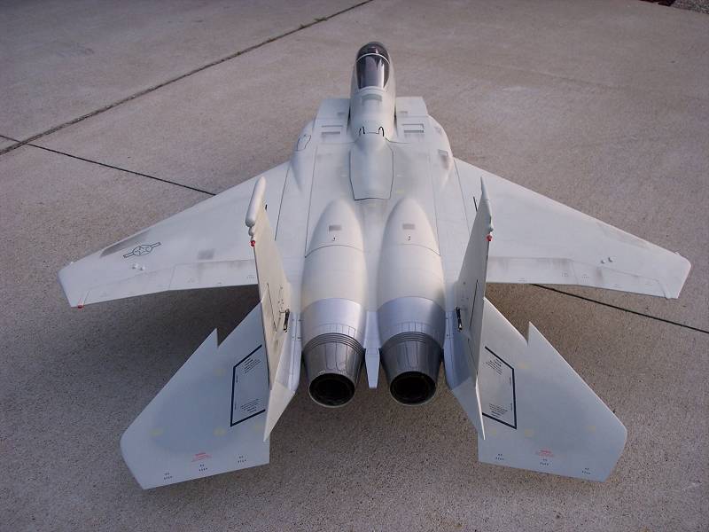

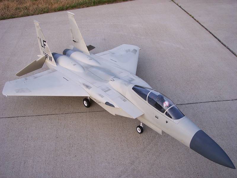

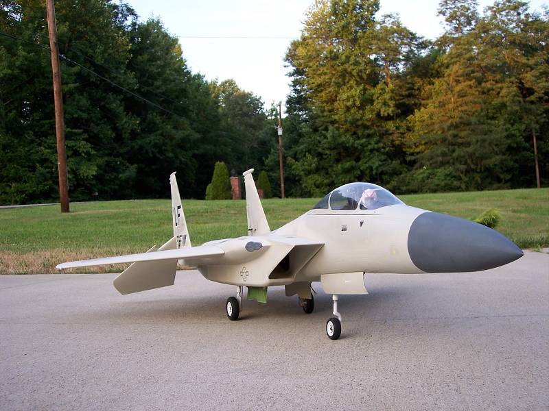

Old 12-09-2006 | 12:34 AM
junkjet's Avatar
My Feedback: (55)
Posts: 317
From: louisville, KY
Default RE: Inexpensive Paint?
ORIGINAL: YellowAircraft
LOL...
You know, a guy can do a lot with a rattle-can if he knows what he's doing....
This is true

Junkjet - Great looking Eagle!!!!
