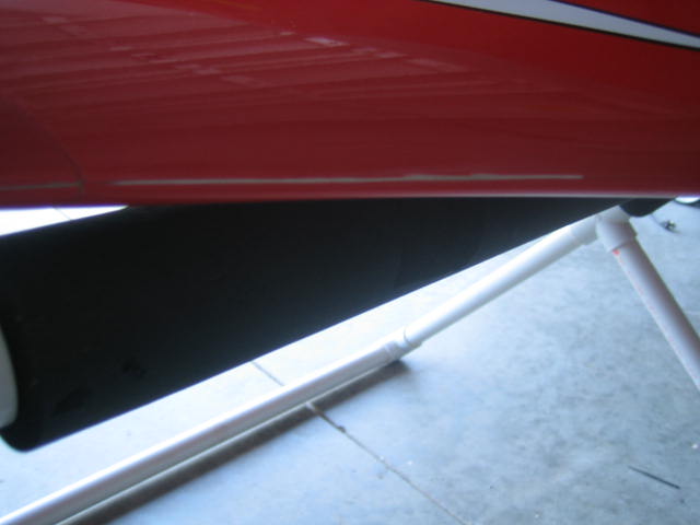

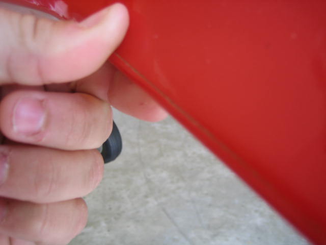

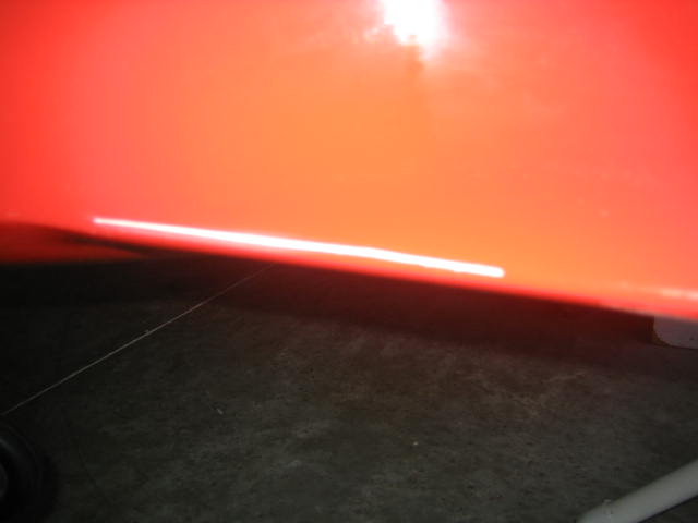

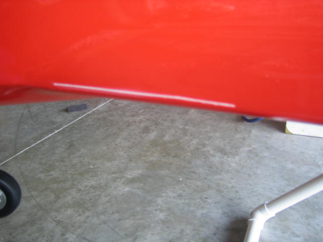

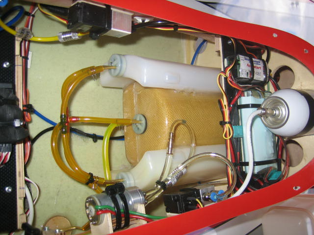

I had wanted to get a Hotspot and have been unable to find a new one so I decided to look at the Jet Storm. It flew great and look like it would make a great weekend flyer, so I bought the Jet Storm at FJIR. They did not have a manual but said they would email it so no problem, I have the experience to build a jet without the manual so I went forward and built the jet, it’s pretty straight forward. After building this jet she was ready for flight, But I decided to give it another once over inspection and found that the seams are opened up along the fuse leading edge. Now if I was to fly this plane, I am sure this would have ended in tragedy and would have questioned myself why my plain came apart in the air. Well I think all the experience I have gained here on RCU helped me and helped me not lose this bird on her maiden due to seams. I suggest that everyone look over there ARFS with great interest for possible issues. Although I bought this from Modellbau issues like this will keep me from buying another ARF kit from them. NOW Does anyone have the CG for this plane, because it’s not in there manual nor are the recommended throughs, I called down there and the lady said that’s what the manufacture sends them so that’s what you get, that was really helpful.

Goekeli, Oh I just fixed the seams. I opened them up about 2mm and filled with Hysol there is a 1" cloth behind the leading edge so I filled it until it pored back out and wiped smooth, This should work.

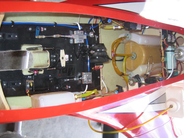

Well I just weighed it and it came to 21lbs with the UAT tank full and main tanks empty. The fuel tank I used is the on on modellbau web site http://www.modellbau-usa.com/catalog...products_id=39 I checked the capacity and it only holds 74 oz so I added the 2 sulliven 11oz poly tanks so I have 96 oz of fuel and a 4 oz bvm UAT tank. so I should be good for fuel. The Turbine I decided to use is the new Simjet 2200, it puts out 22lbs of thrust at 120K and I have tested and verfied that. so it should scoot along really good..
