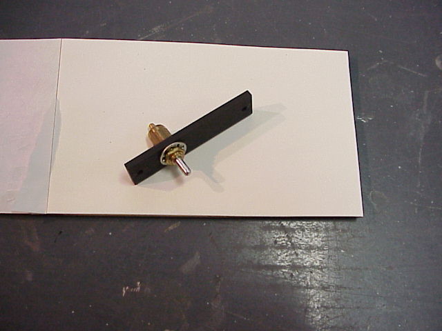

Here is another version they had for a while. It mounted directly to a servo, there was a gimmick mounted on the servo horn to depress the button.
Vin...

THANKS A BUNCH GUYS.MY SWITCH IS NOT THE CORRECT TYPE, I SEE FROM THE PICTURES.IT IS NOT A TOGGLE BUT A PUSH IN PIN TYPE.WHEN PUSHED IN AND HELD THE GEAR IS DOWN,WHEN LET GO THE GEAR GOES UP. THANKS AGAIN TODD

I've used both kinds of air valves pictured in the previous posts and I personally prefer the "toggle" type..
The "button" type should be actuated by a cam rather than a servo arm.
BTW: I beleive both are Klippard products.
Johnny

Vin
That is the one I was referring to in my post. Thanks for posting the pic.
FWIW, I never liked that version. It puts a lot of strain on the servo arm.
Vin...
This is the type of valve I used to close the gear doors on my Mig-29. When the gear leg was retracted ithit the valve sendig air to the door cylinder and closed the doors.
