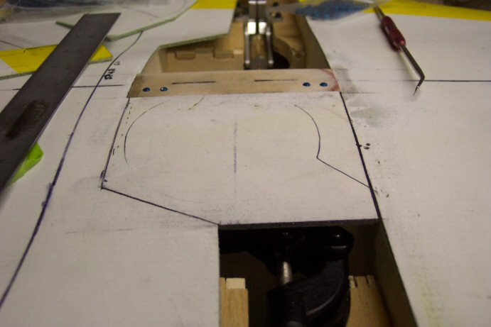

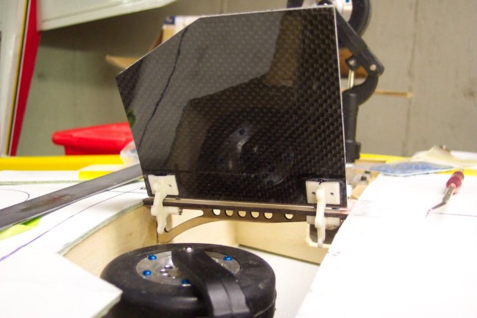

I decided to work on the doors before I mold the fuel tanks. Progress has been slow, but I am happy with the results so far.
Chris

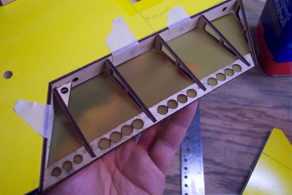

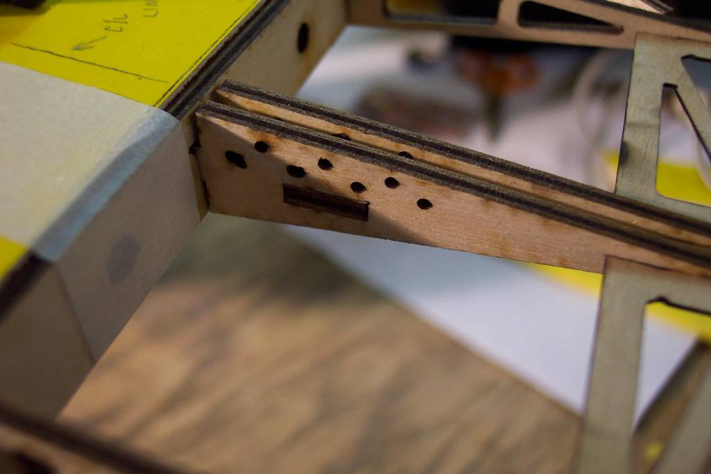

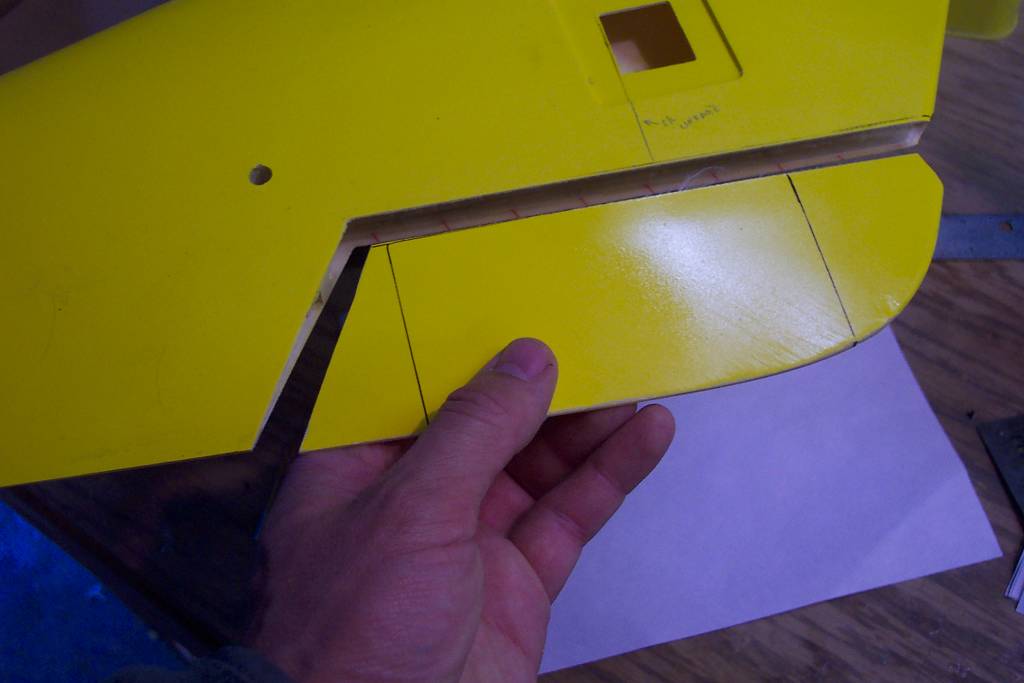

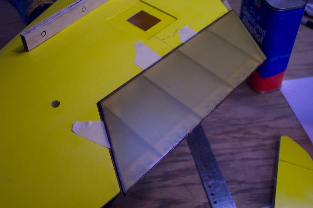

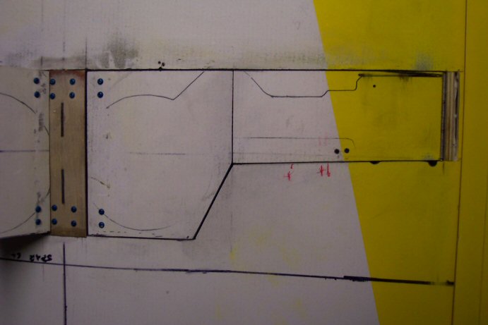

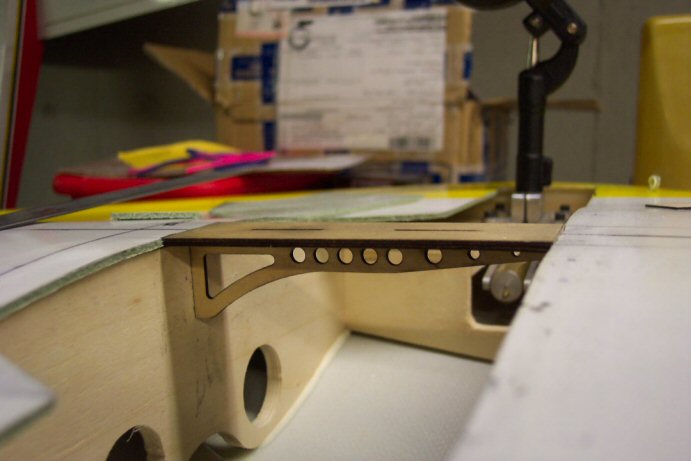

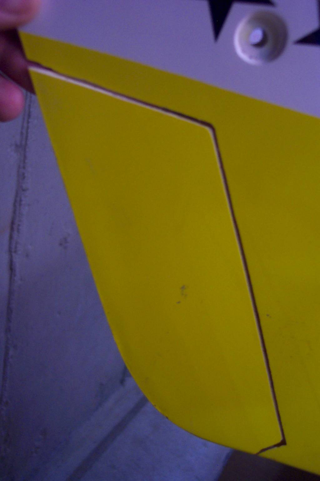

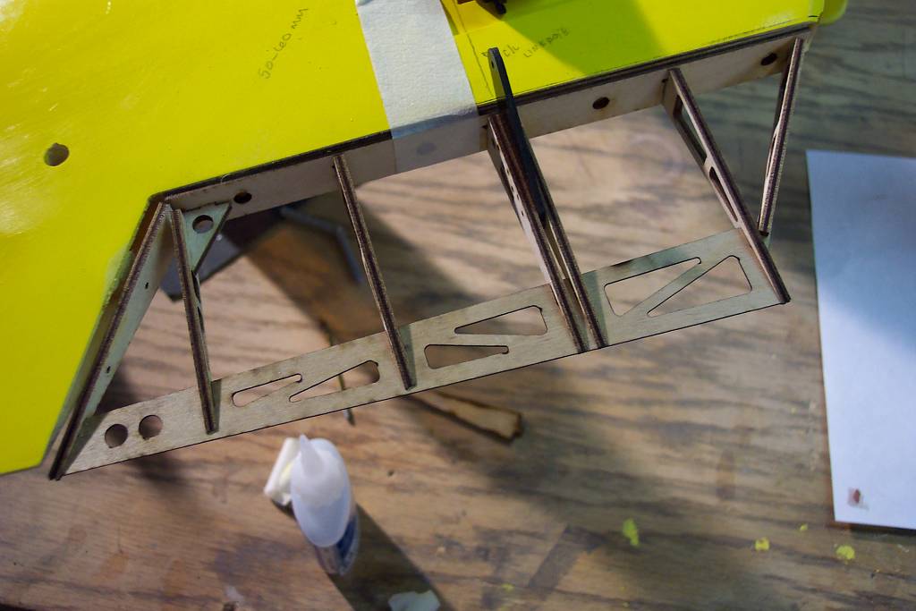

Well, it is time to revive this build. The F-84 is finished and I am ready to do some building after my deployment! The rudders did not sit that well with me so I cut them off and designed new ones that will have pin hinges. All the flight controls will be looked at closely and will be worked to make sure they will stay on the jet, the P120 is going to push her around quite well I am guessing!
Here is the initial design, very light and stout! just a little more tweaking and they will be good to go!
Chris

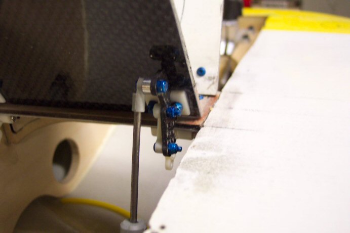

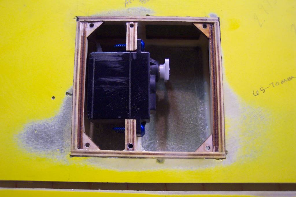

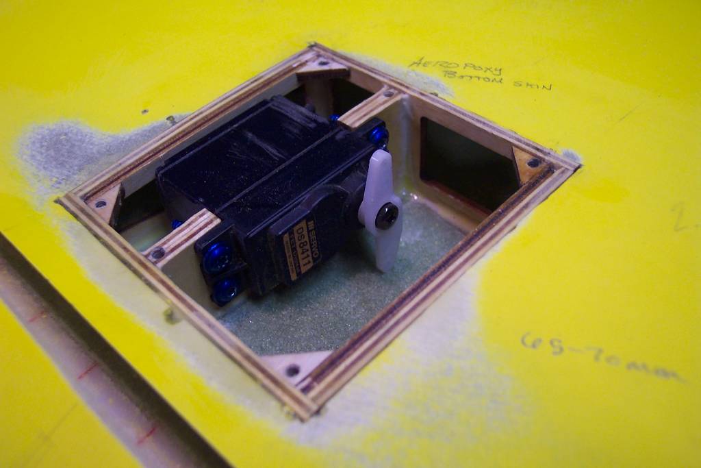

Here are some pictures that I took quite a while ago. There was no way I was putting servos in the little plastic hatch covers, I wanted them locked into to the airframe. All the servo bays will get similar treatment.
Chris

Old 05-01-2010 | 12:55 PM
  #37
olnico's Avatar
Joined: May 2007
Posts: 4,120
Received 16 Likes on 10 Posts
From: Houston, Texas.
Default RE: AD Jets Phoenix build thread
ORIGINAL: Stratotanker
Oliver,
Thanks for the input. That area was a concern of mine as well and will get some TLC. Did you do anything with the booms similar to the Kingcat upgrades???
Chris
Booms are stock.
No problem whatsoever.

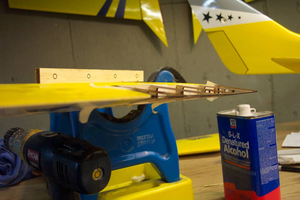

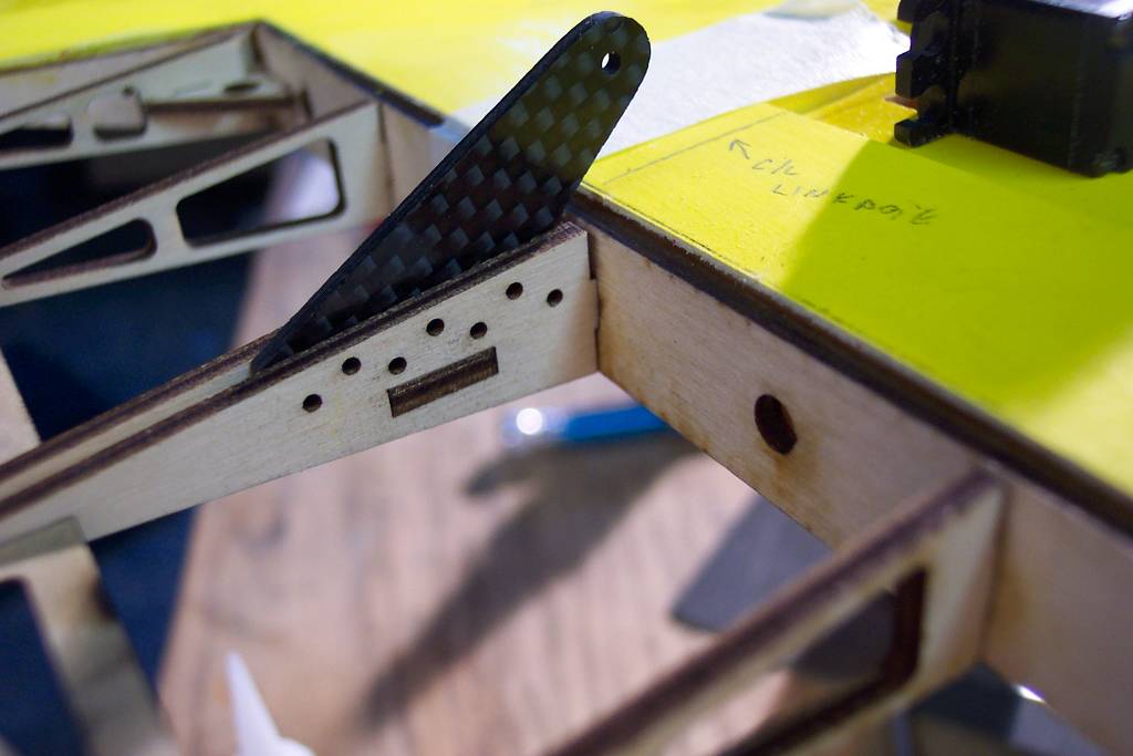

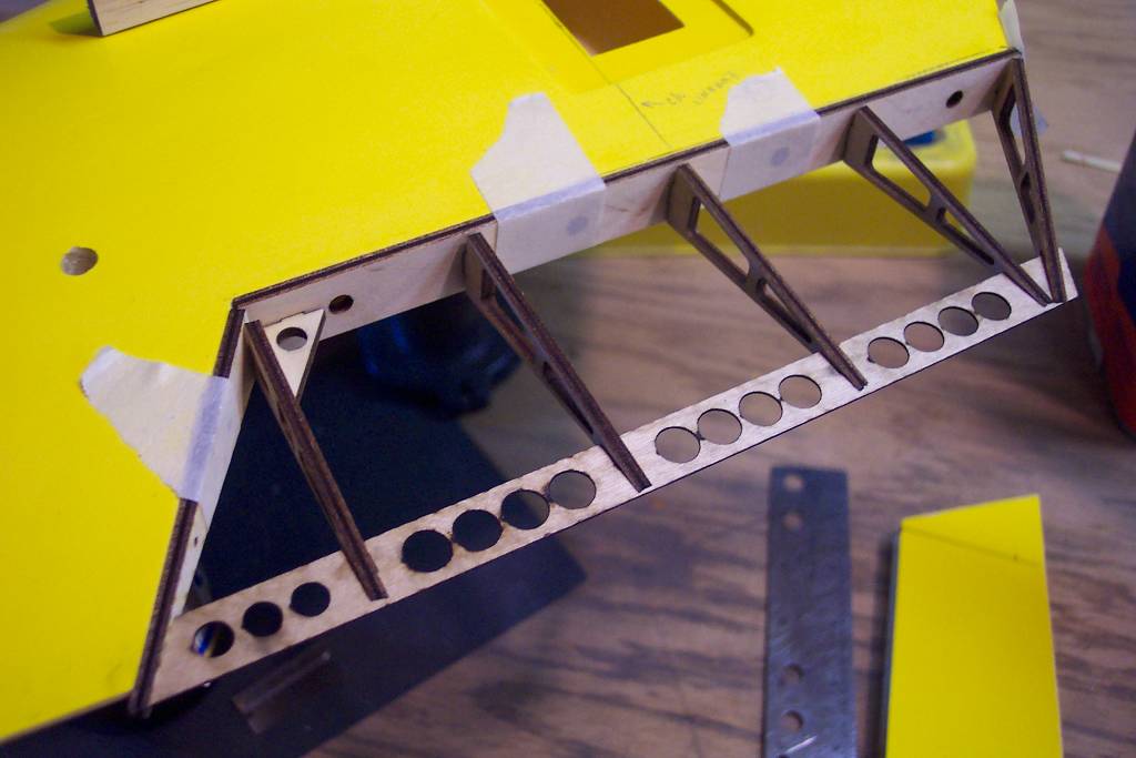

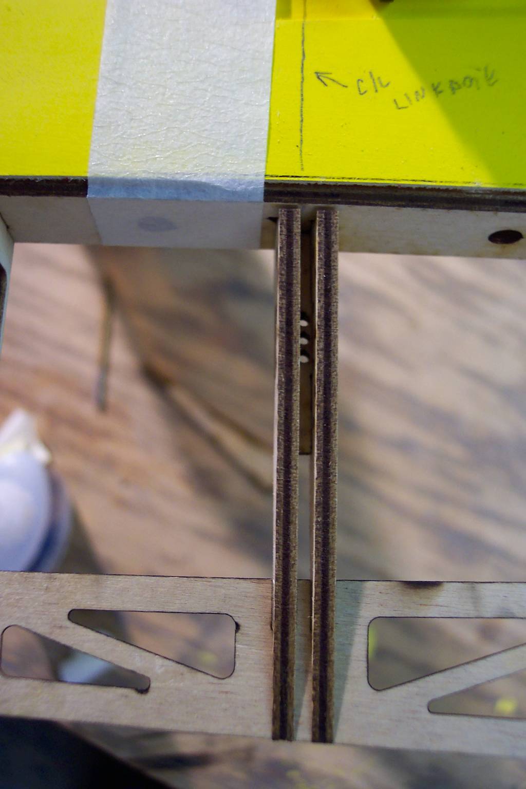

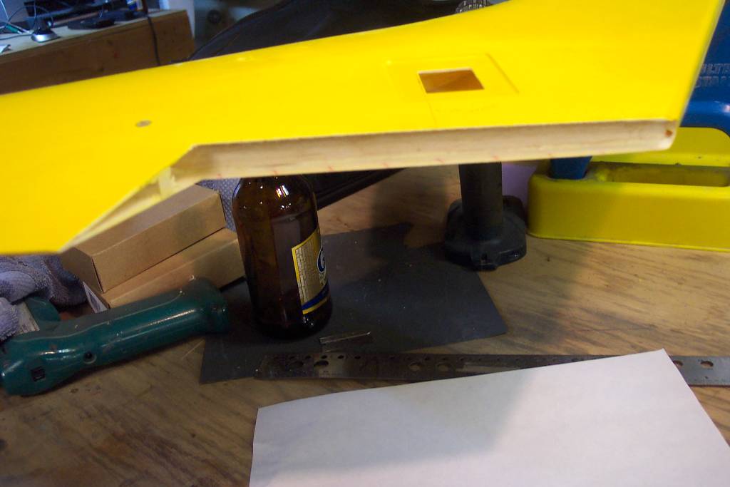

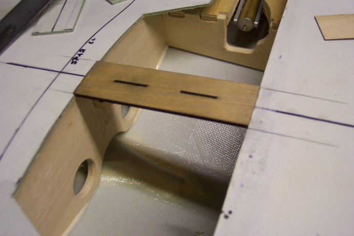

This is version two, had to make a few changes that I overlooked and I wanted to add structure for the control horn...
Chris
