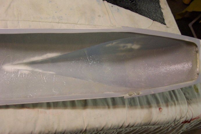

Well, here is the the progress for day one. I wanted to mess with the hatch and get the fuse bottom reinforced so I can cut the doors and mount the landing gear. I managed to get quite a bit done. For the hatch, I was not happy with the fit or the idea of having one wood dowel. I fired up my laser cutter and made a drill jig for two pins and then machined some aluminum pins to lock the hatch to the fuse. I ended up with a considerable gap at the rear of the fuse so I shimmed the back of the hatch with G10 fiberglass to fill the gap. I spent a lot of time sanding and fitting the hatch and am very close to getting to fit the way I like. I still have to install the latch assembly and then do final filling and sanding to perfect the fit, more to come on the hatch.
For the fuse reinforcement, I first removed the radio tray and broke the rear former in the process, but that is ok since I will lasercut new ones anyway. The main purpose for removing them was to gain acces to the fuse bottom so I could lay the carbon cloth in without having to fight the wood pieces. I wanted to get the bottom really stout since there was not much there to begin with, plus I will be installing a nose door and cylinder. The top of the fuse strakes will get a layer of carbon as they are real flimsy too. The main gear door area will have a carbon layup to reinforce them for the doors. That is it for now, this post was kind of rushed. I will post more pics once I get the hatch fitted the way I want and then it is on to gear doors, I think???
Chris

After heat curing the Carbon at 110 dgrees overnight, the fuselage is now extremely rigid. I am not worried about the fuselage buckling anymore! I hope to finish the hatch today and get the rest of the carbon installed so it can cure overnight again.
Chris

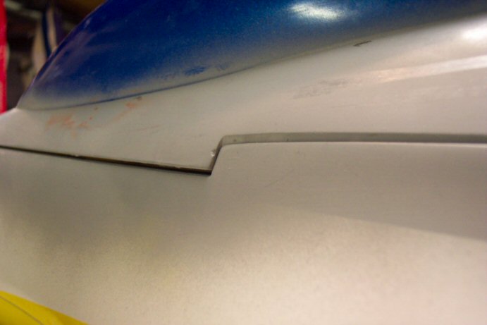

I started filling and fitting the canopy over the past two days. The canopy fit was a bit on the undesireable side so I figured since I was painting the whole plane, I would make it fit a little bit better and cleaner!
With the front pins and rear latch installed I could now see where things needed to be filled and sanded to get a good fit. As you can see in the pictures the front of the hatch hung out a bit so I used G10 fiberglass to shim the rear vertical portion of the molding to draw the front back where it needed to be. Once I had the rear shimmed to fix the front there was a large gap (approx .062") along the rear half of the hatch.
I continued to lay strips of G10 along the fuse side of the hatch molding and sanded it to the body contour. Still unsatisfied with the gap left with shimming, I trued the gap until it was opened up enough to accept strips of .020 G10 fiberglass. I glued these strips to the hatch side molding making sure that that the strips were mate against the previous strips applied to the fuselage. I then sanded and filled these strips with the hatch installed to come up with the final clearance seen in the last three photos. I decided to stop there, I gotta have a little room for paint! I still have a fair amount of this process to complete to finish up the perimeter. The front of the plane is going to have white on it so I think the extra time spent here is going to pay off big in the end.
Chris

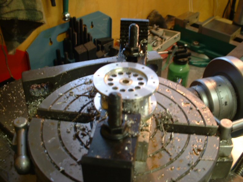

The next step in my build was to be cutting and hinging the doors but I needed my wheels and tires first so I could accurately cut the proper size of door. I decided to machine my own wheels and brakes nad mold my own tires. I drew everything up in CAD, chucked up some aluminum and started turning down a main wheel and brake hub. I still have to mill the hub out to fit my strut and make the bushings and one main will be complete. Once the wheel is complete I will do the tire mold and mounting jig to make sure it is going to work before I complete the other main and nose. I hope to have a tire molded in the next two weeks. Anyway, here are the pics of the progress.
Chris

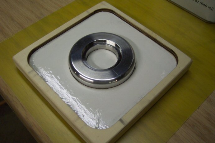

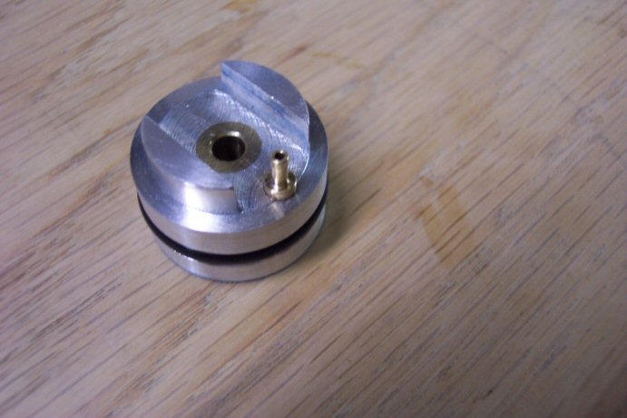

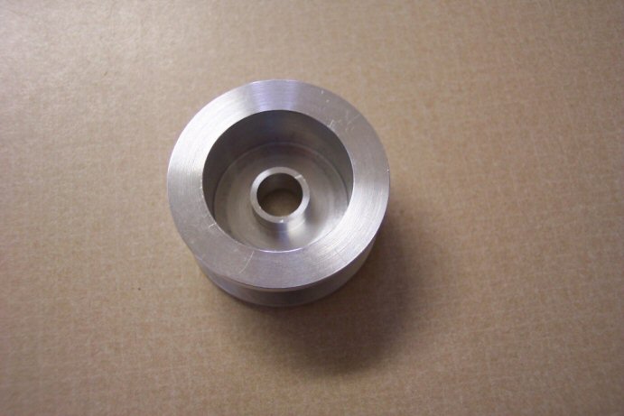

Here is the latest progress on the main wheel that I started a while back. Tire molding will happen very soon!
Chris

Old 02-21-2007 | 10:51 PM
Posts: 993
From: Otis Orchards, WA
Default RE: AD Jets Phoenix build thread
Landing gear door construction under way.
Chris

Old 02-27-2007 | 05:23 AM
Posts: 993
I finally finished a wheel! Tire mold construction begins tomorrow and hope to have a tire mounted by the end of the week.
Chris

Old 03-03-2007 | 12:15 PM
Posts: 993
Finally, a complete assembly. I will finish the other main and the nose and then it is on to fuel tank molding.
chris
