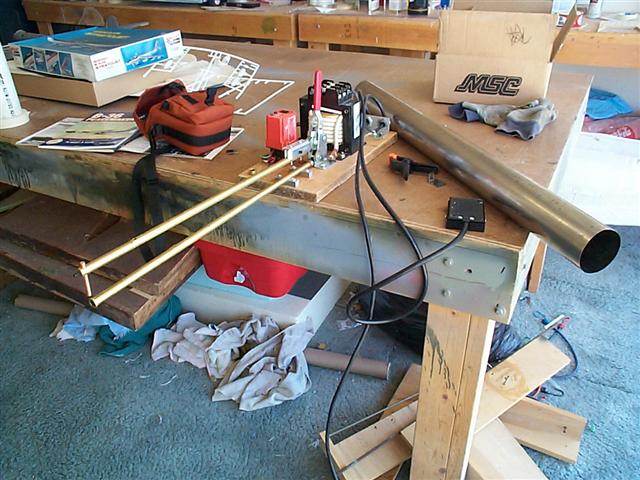

I built the spot welder from Kurt's website at:
http://www.5bears.com/welder.htm
It features a timer and foot switch so you can control the weld very accurtately. I have found that good welds need a very short time, as in a few hundreths of a second.
This setup lets me repeat the process reliably. And it's a pretty inexpensive device.
I made 18 inch arms to build a 36 inch tube for my large U-2.
Works well on stainless - don't know about titanium.
Paul
