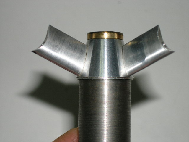

I noticed that the starter cone is coming out at around 90k rpm. Presumably, the spring inside the starter has gone soft and needs replacement. I am enclosing a photo of the starter front bit. Before I start operating
can somebody let me know how to dismantle the front bit of the starter to get to the spring?

I put up a long post about it a few years ago-You could find it in the archives useing ram starter and my sign on. In my opinion that starter was a major contributing factor to the RAMs problems. That little flat O ring just did not make good contact on the flat compressor nut. Tons of slipping, low RPMs and FLAMES from that.
It is not an easy fix. and I am not sure the spring is the issue. Please check for vibration and that the ECU is fully braking the starter.
You cant get the Bendix off without destroying the starter moter. and that Fulhaber motor is a bb coreless design that costs $119 USD. The Bendix has been press fit with a non removable locktite on the shaft.
You could try and pull the bendix off by drilling two small holes at the base of the cone to allow access to the end of the Bendix, then heat up the bendix with a minitorch or iron to soften the glue and then try to pry it off the shaft thru the holes with small screwdrivers. Might work.
The other option is to have Carlos put on an X style starter. About $500 for parts and machining and balance that will need to be done. The engine will start like a dream then though. Scott

UPDATE:
I assembled the starter again and started to give the turbine another run but this time I unplugged the starter from the ECU in order to eliminate the possibility that the ECU was kicking in the starter at a specific rpm. It resulted that the ECU has nothing to do with this problem and is working perfectly. However, we still experienced the same problem of the starter cone being drawn into the intake at 80k rpm. I also noticed that most starters nowadays seem to have the starter cone shielded from the airflow. It is definitely a case of the airflow pulling the cone towards the intake. Consequently, I decided to shield the starter cone by making a sleeve over the cone which is held by the edge and possibly also pinned to the original cone shaped part of the starter. This could be a solution. I am now, more than ever, convinced that the compression spring inside the starter has gone soft and is not able to overcome the air pressure. Just to have an idea I will reposting the above photo again with the proposed changes as soon as I can find out why I am getting "Page cannot be displayed" when trying to load picture. This could be a solution.....what do you guys think?

UPDATE:
Sleeve made and fitted. It has been glued and pinned to the main starter body too.
We will test run the engine and see whether it would work or not.
Photo attached.
Reuben
Photo attached.
Reuben
UPDATE:
Starter was placed back in its original position. The sleeve did not interfere with the starting procedure and then turbine was spooled to 120k. I am happy to report that the sleeve solved the problem and the starter cone remained in place.
