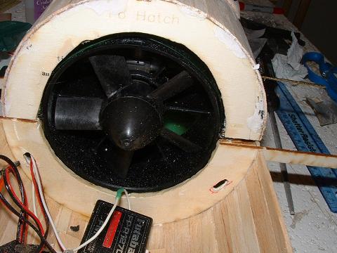

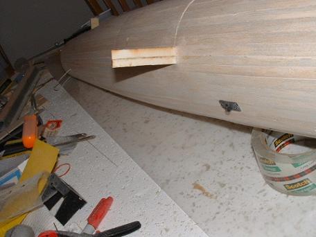

Default Engine hatch
Heres the Engine hatch
Old 03-04-2003 | 12:23 AM
  #53
My Feedback: (26)
Posts: 640
From: Pensacola, FL

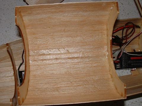

Default RT Models Mig-15 / Toki .18
Underside of the engine hatch glassed for strength

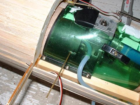

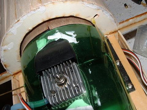

Old 03-04-2003 | 12:32 AM
  #55
My Feedback: (26)
Posts: 640
From: Pensacola, FL
Toki Fan fits nice and snug

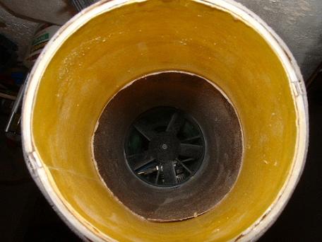

Default Exhaust
Ducting for the exhaust. I broke down and used 1/64 ply and coated a very thin layer of epoxy for fuel proofing. Very light material I thought.

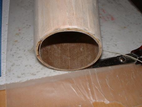

Old 03-04-2003 | 12:36 AM
  #57
My Feedback: (26)
Posts: 640
From: Pensacola, FL
Default Intake
Intake ducting is part 1/64 ply and part billboard I ran out of the expensive stuff. Seems to look fine though.

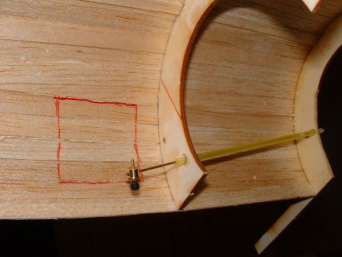

Old 03-04-2003 | 12:42 AM
  #60
My Feedback: (26)
Posts: 640
From: Pensacola, FL

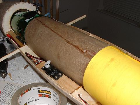

Engine ducting fits nicely on top of the fan shroud. I cut a little too much on the top half former, but I dont think it will be a problem because I have about 85mm on the intake and 80mm on the exhaust side....not sure how you compute FSA but I've only lost approximatley 10mm from the fans 90mm hieght...any comments on this one...its new for me

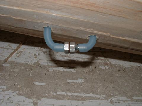

A borrowed refueling solution. Look familiar?

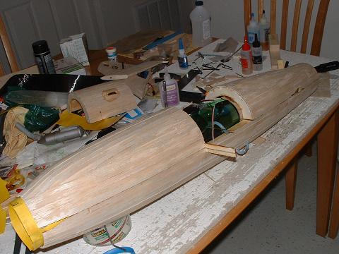

Entire Fuse together and sanded
