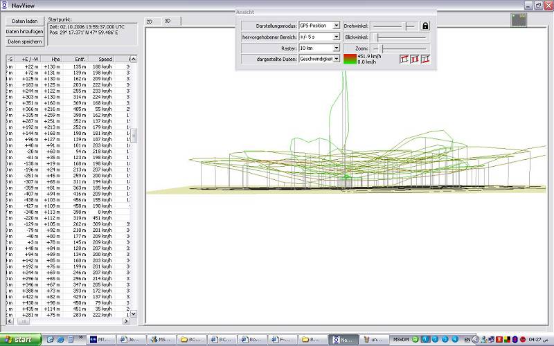

Well I Had One With A TITAN Install On It ,Tam Th Vector And 10 Ch Weatronic Dual Reciever With GPS, Very Easy To Build.
Great Airplane To Fly. My Setup For The Canards Was Like This I Keep Them On For Takeoff Landings And 3D Flying , Unbelievable Maneuvers, But Whin I Go For Speed I Switch Bouth Of Them Off.
Very Fast Air Craft I Got Max Speed Of 451 Kph About 280 Mph.
Here Is The Weatronic Logbook
