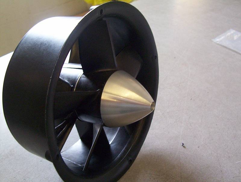

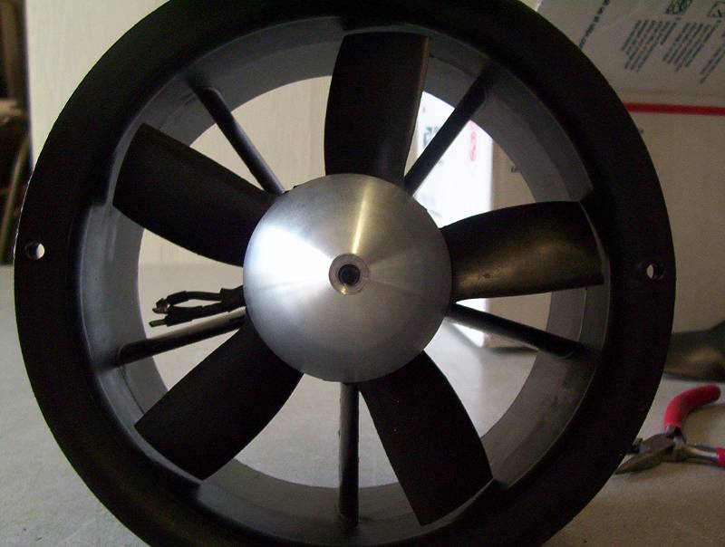

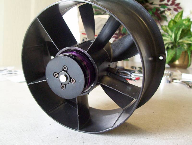

Old 10-07-2008 | 07:23 AM
  #31
junkjet's Avatar
My Feedback: (55)
Posts: 317
From: louisville, KY
Default RE: Byron F18 DF powered ?
Try this for all your Byron jets
