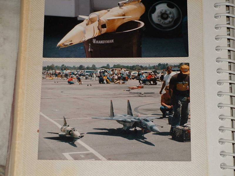

Twin Engine D/F is not that hard - you just have to know how to set up the engines so they run right. Had a Byron F-15 with Ross.81s with OS 9 carbs - flew GREAT -no problem at all - same thing with a Tom Cook F-4 - Twin Dynamax and OS.91s- I could get 20 flights a day - and NO dead sticks. Try it. Nothing worse than a twin engine A/C with only 1 engine - why bother ? JMO.

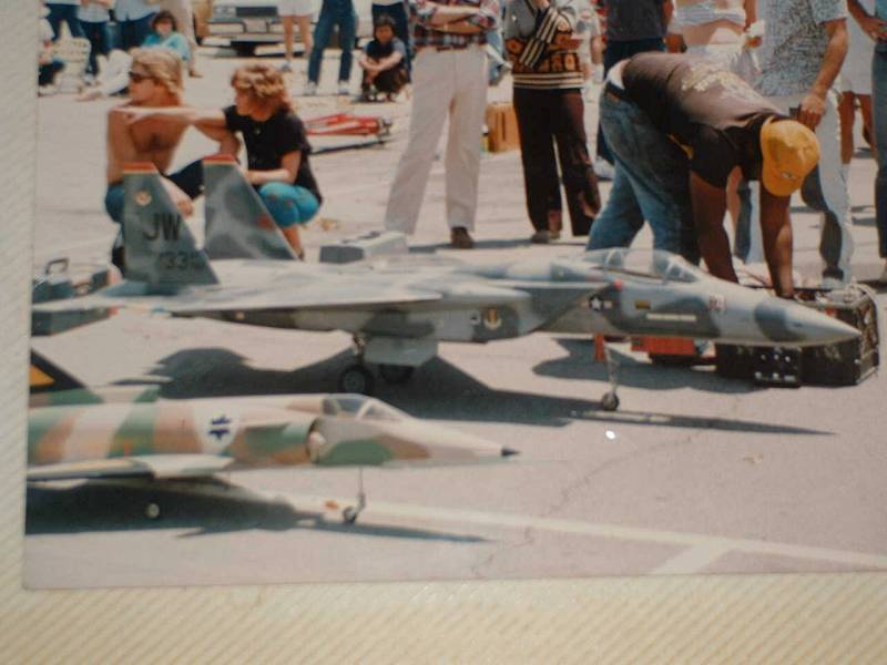

Alan,
just get a hold of a OS9D Carb and make a adapter then mount it to the Rossi 105 - trust me- you WILL like it- D/F is still fun - I LOVE the sound of 24K RPM on a high speed low pass - sounds just like a F1 race car.

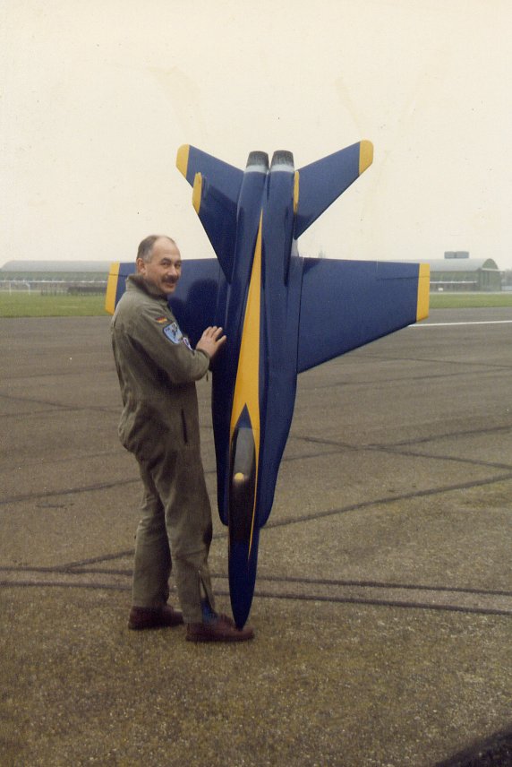

This is my Byron FA-18 circa late 70s early 80s OS 90 and Byron fan weight about 15 lbs flew great, only problem was taxing/taking off/landing in a cross wind with it as the mains landing gear was not very wide

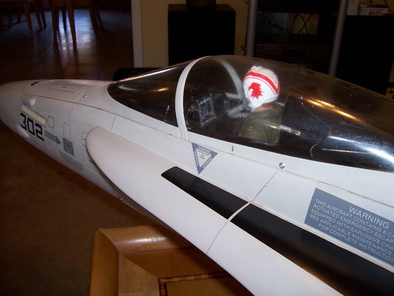

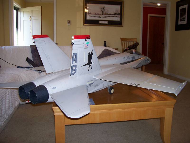

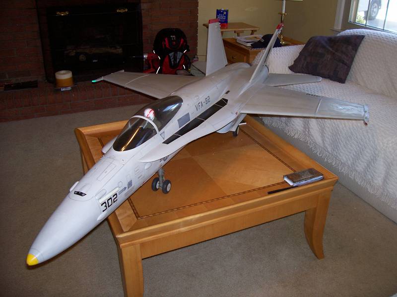

Spitmad,
I just maidened my Byron F-18 today and it did great even thought my elevators were not even causing it to roll left. Made 2 or 3 passes, set up for a landing, throttled back and touched down at a nice nose high attitude. This jet is by no means fast, but looks great and scale in the air! I received a round of applause with many cheers after the mains touched down. Mine is powered by a Rossi .90 and took about 350' to 400' to rotate. I cannot wait to fly her again! I will be at Florida Jets this week and may come home with a new power plant for her......

Some pics for your enjoyment!
