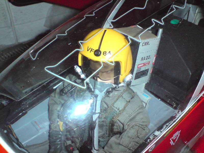

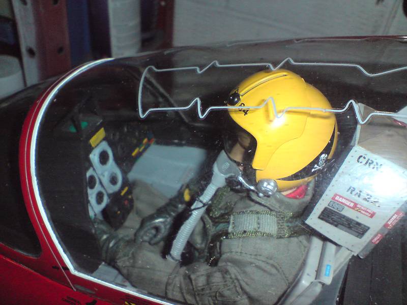

Ok got a pilot
It was a 'small' 1/6th size Elite Forces pilot.
I need to paint his helmet to match the Reds but i think he looks the part!
All we need now is some weather on Sunday
Paul

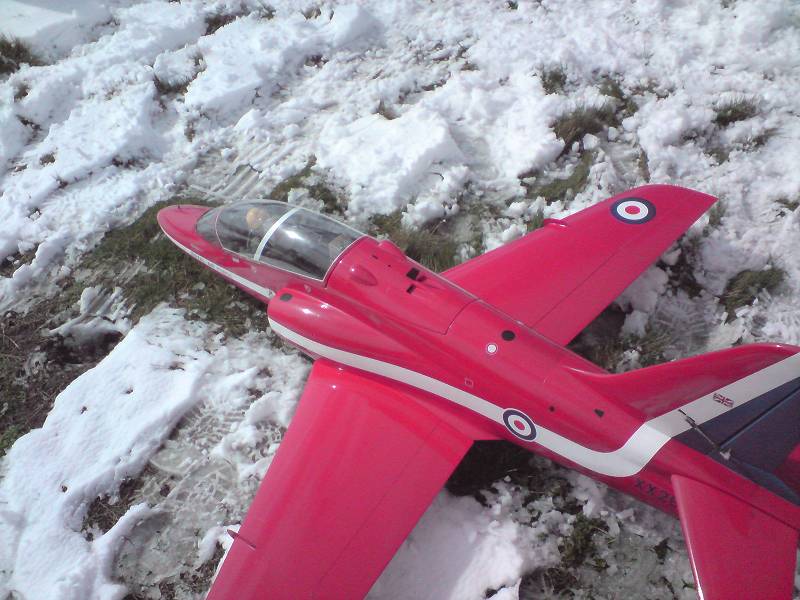

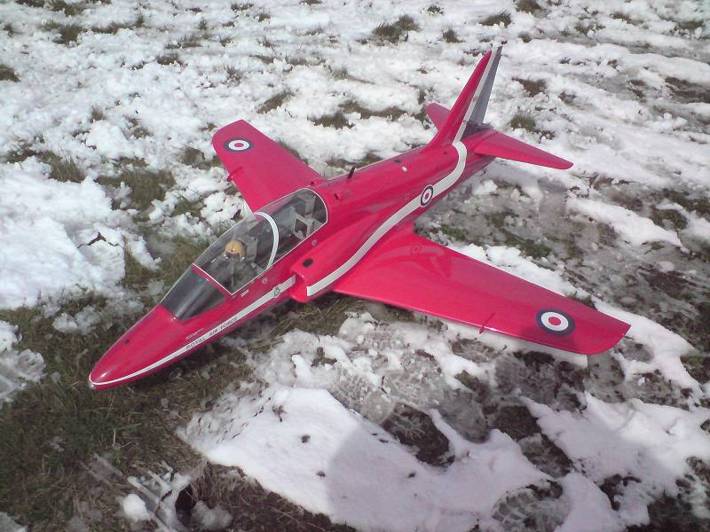

It is done...[8D]
This morning we loaded the car in a blizzard, a good 3 inches of snow and dark skies.[>:]
As we drove west to Oxford the sky cleared and eventually sunshine!
It turned out to be one of the best flying days we have had this year
Cold but relatively calm and what wind there was was down the runway!

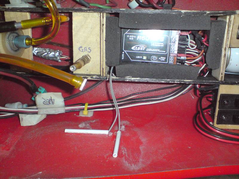

I range checked the Fasst 2.4 and all was well.
Now no excuses left, …….final check of all functions and open the throttle [X(]
All i can say is it was a total non event
The FASST system worked perfectly and the Hawk flew the way it always does....beautiful
I am now no longer a 2.4 JetVirgin and the Hawk has no whip aerial [8D]
Happy days.
Paul

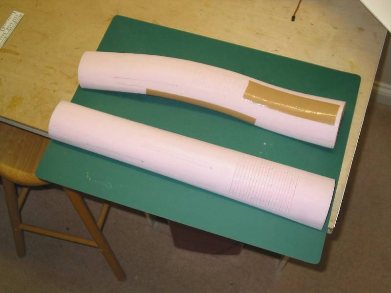

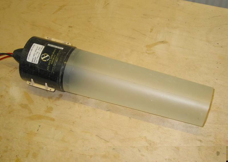

Having decided the fan location, the next step was to make the ducting. I hot wire cut a pair of blanks from pink foam, and curved them to an “S†planform and an arched shape in elevation to clear the wing by means of saw-cuts, with parcel tape pulling the blanks into the required curve – Pic 1. My new ducts comprise an inner layer of 3oz glass cloth and an outer layer of 6oz twill weave glass, spiral wrapped with carbon tow at 20mm pitch.

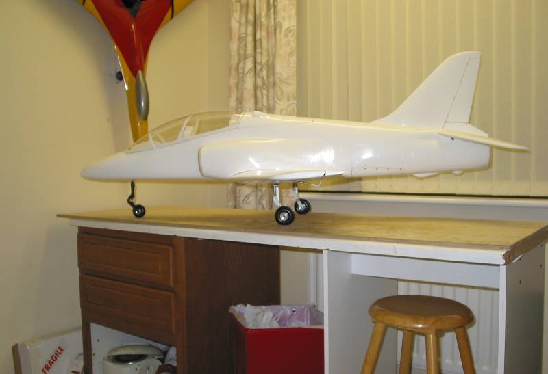

Pic 2 shows the new fan unit location, the ducting, and the approximate location of the 12S Airthunder battery (2 x 6S 5000s). Note how much shorter are the original ICDF ducts. Clearly there’s no way that the original ICDF fan location would work.

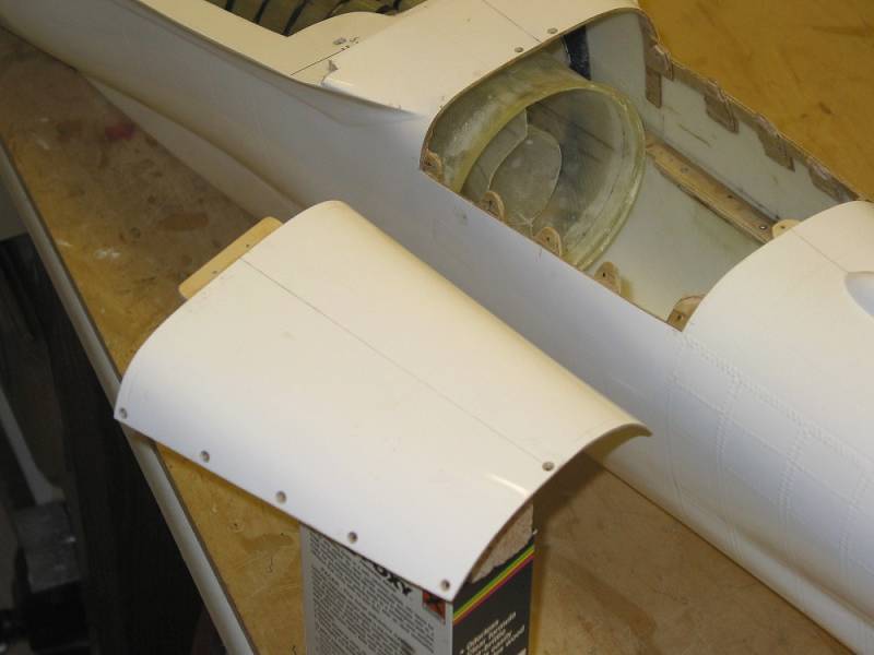

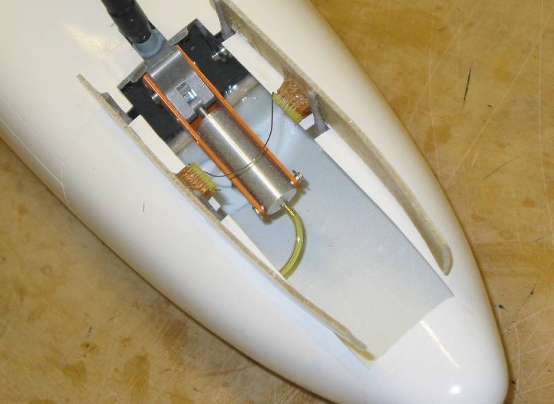

Pic 3 shows the separated fan hatch, cut from the fuselage along existing engraved panel lines using a razor saw. Removing such a large section from the fuselage reduced its torsional rigidity. To restore fuselage stiffness I edged the hatch and the fuselage aperture with a double layer of 1/32in plywood strips 3/8in wide, and added laminated plywood lugs on the fuselage onto which the hatch is firmly screwed to restore fuselage stiffness. These lugs are curved during lamination to match the curve of the fuselage.

I rolled the tailpipe from Mick Reeves thinnest Pro-Skin, seen in Pic 4.

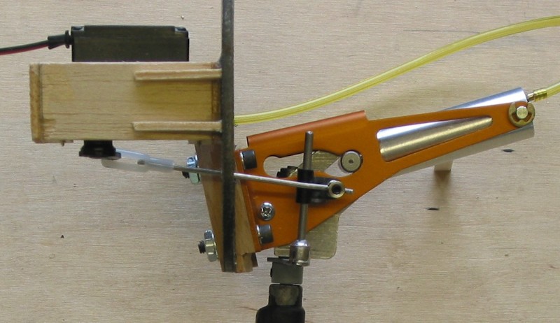

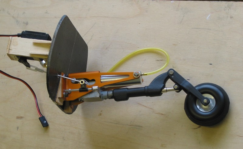

I chose the Robart 105deg unit for the nose retract. I cut off one side of the steering arm and soldered a length of steel wire to the remaining one for the sliding steering servo link. The Eurokit 15080 sprung steerable noseleg is just right for this model.
To avoid having to angle the nosegear bulkhead back a whole lot to get the wheel fully retracted, I installed the unit on 15deg beech wedges so the bulkhead could be more or less erect. Pic 5.

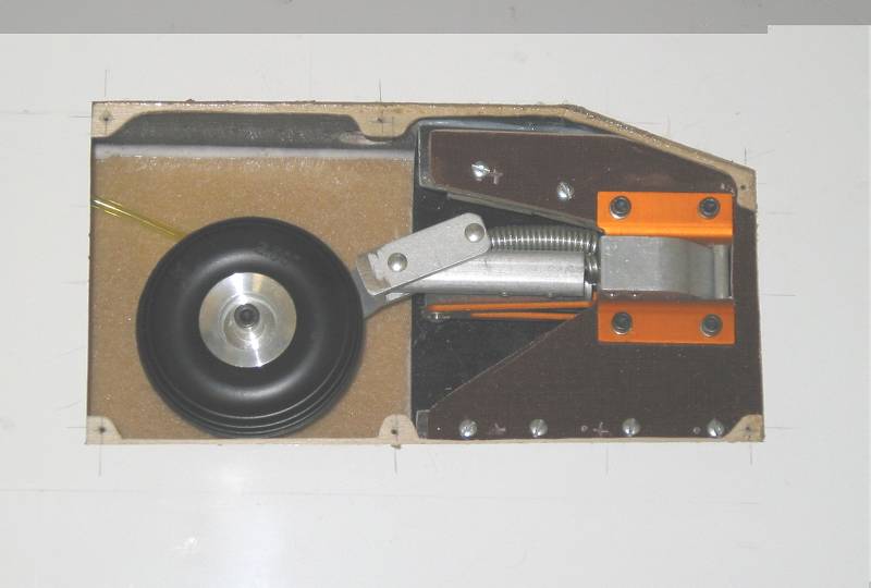

Pic 6 shows the steering servo pushrod supported by the slot so that the nosewheel centres during retraction. The siding horn is a nylon strip aileron horn and the pushrod fastens to that with a screw-up servo connector. The vertical wire rod is soldered to the Robart steel tiller arm along with a brass wheel collet for extra support. I’ve programmed the Tx to inhibit the nose steering channel when the retract switch is selected “up†and this automagically centres the nose steering servo too. Thus the nose steering servo doesn’t move with rudder when the noseleg is retracted.

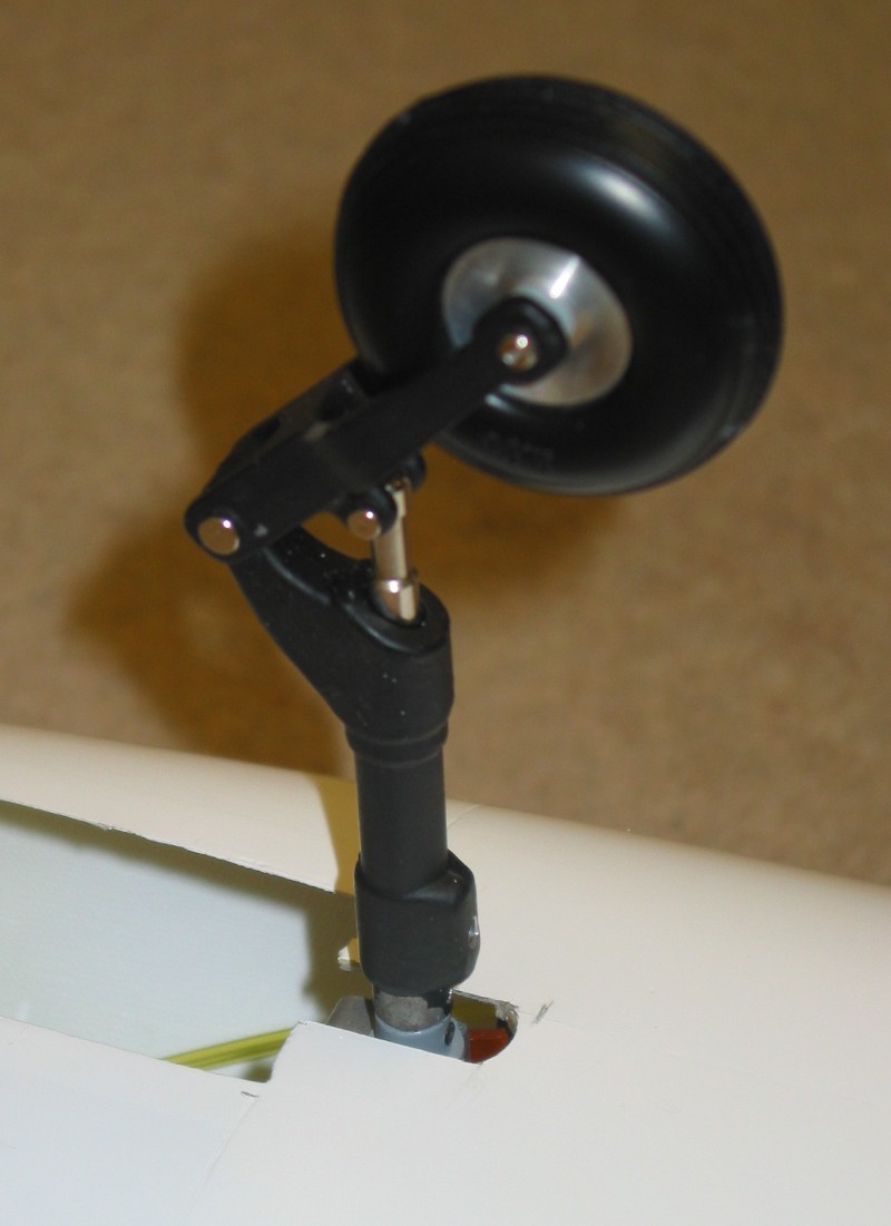

In conjunction with the geometry of the retract block and its pivot, the nose leg “grows†in length as it retracts. So the bulkhead needed setting back a bit, another reason for not sloping the bulkhead backwards. This resulted in the notch seen in the fuselage underside. Pic 7.

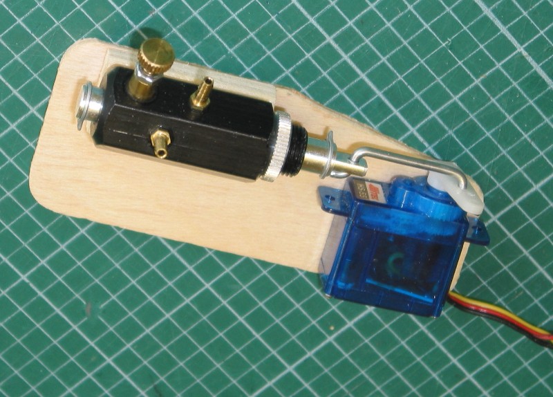

I glued the air valve and its servo to a bit of plywood, and this assembly will Velcro inside the model where needed to help achieve the CG. Pic 9.

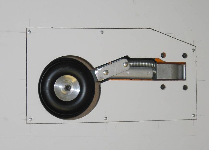

Dick Spreadbury gave me a pair of really nice Sullivan Pylon Brand sprung gear legs that he’s had unused in their packaging for about 20 years – thanks Dick, you are a star!! Dick used a similar pair on his Pete Nye original prototype, and suggested that I remove one side of the U-shaped wheel mount. With this done they look remarkably like the full-scale Hawk’s trailing link legs.
I epoxied 1/4in ply doublers beneath the wing brackets, seen in Pic 10. Then I made new mount plates from1/8in tufnol and installed the retract units straight and as far forward in the bays as I could. Pic 11. The plates screw to the ply doublers. When the gear is extended, the wheels are about 3/4in further aft compared with wire legs. Pic 12 shows the retract bay covers installed.

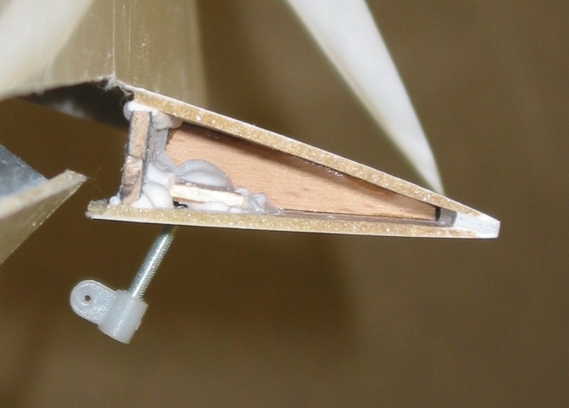

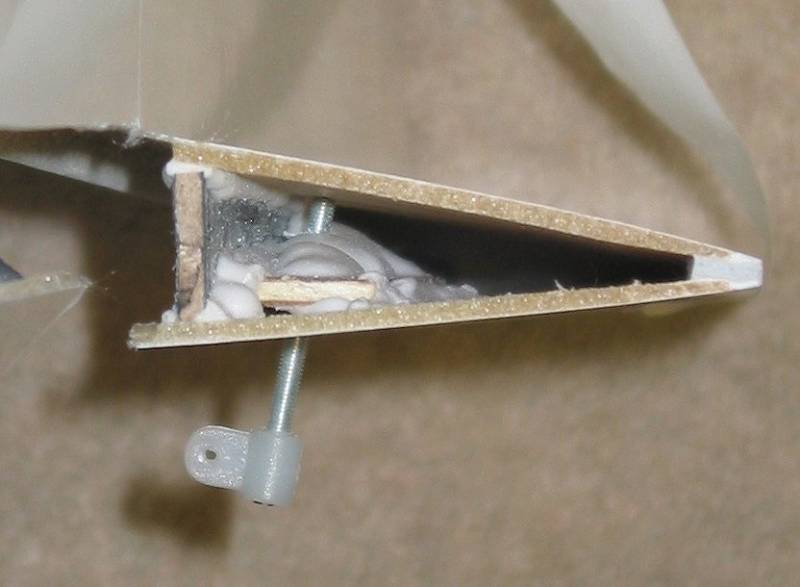

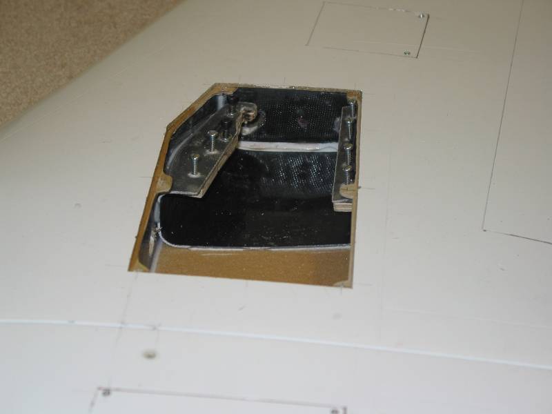

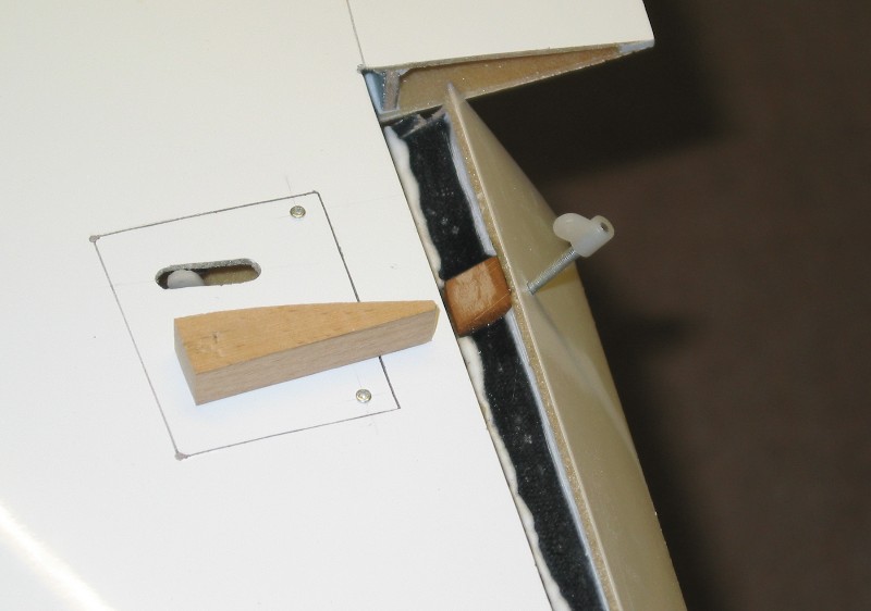

Disappointingly, the aileron horn support was unusable, comprising a sliver of liteply slapped into place with some filler which was too weak to hold the threaded rod horn which rocked about – Pic 13. Simply blobbing epoxy in there wasn’t a solution as I couldn’t have controlled its installation satisfactorily. So I made new aileron horn mounting blocks from beech engine bearer as seen in Pics 14 and 15.

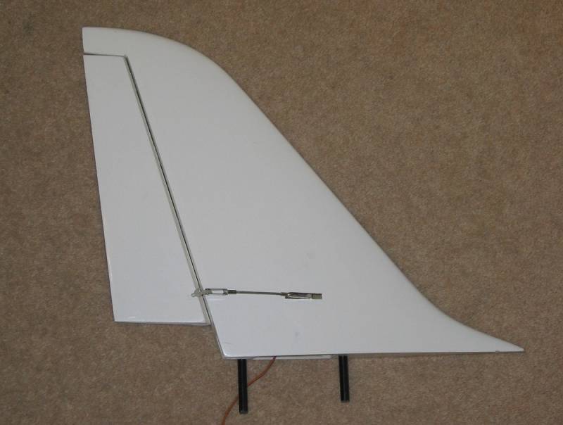

Just one more ... here's the rudder installation. A 90oz.in JR 4131 just fits nicely. I have 4131s on flap and elevator too, and DS161 on aileron.
