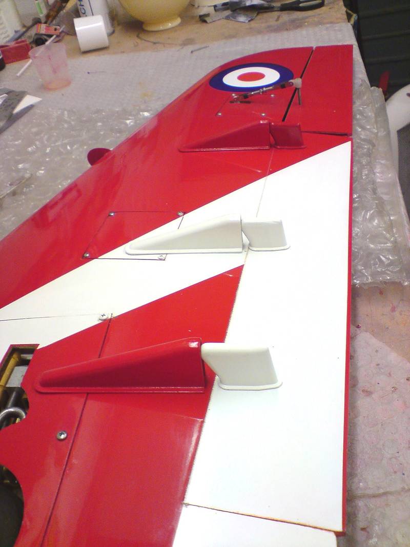

Default RE: FOX COMPOSITES Bae HAWK, Build thread

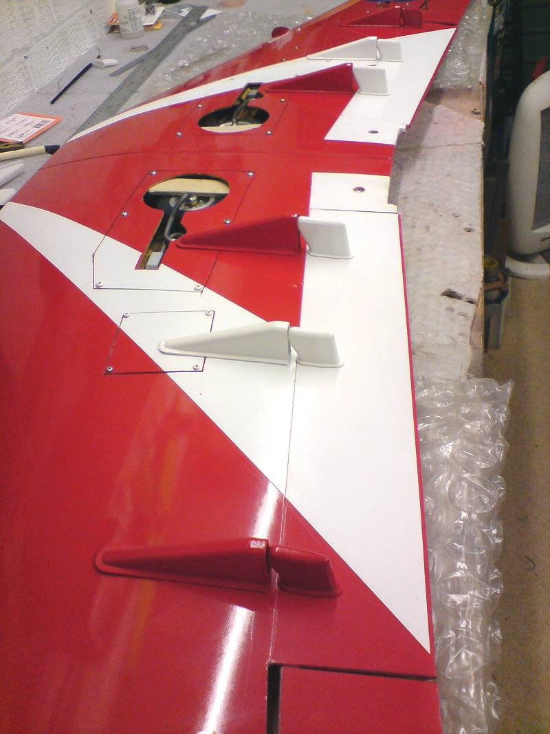

Made up and sprayed the under wing flap drive fairings.
See photos below [sm=shades_smile.gif]
Paul

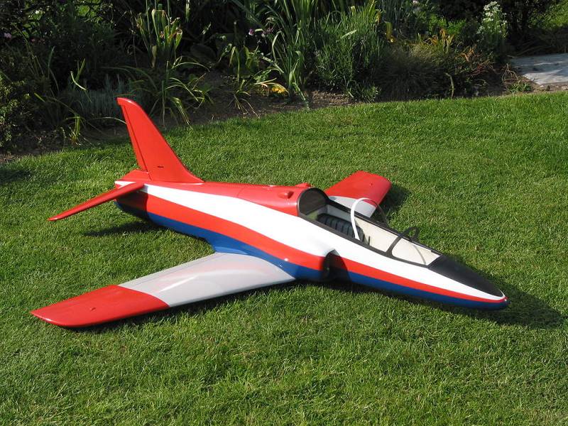

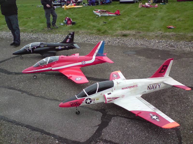

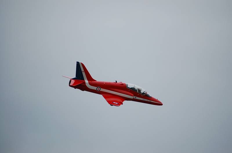

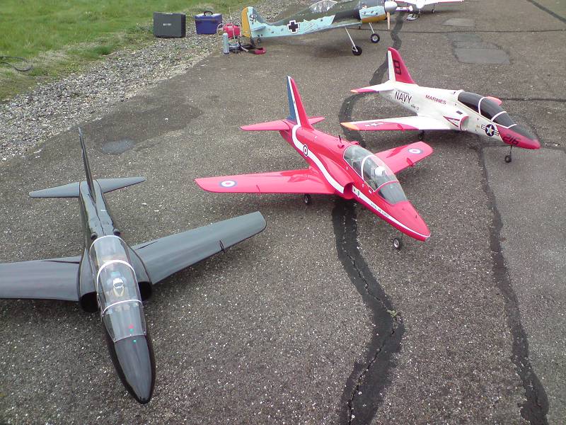

Had a great day today with the Hawk, Trev flew his black Hawk and test flew the T45 finished version.
Mine and Trevs flew perfectly as normal but unfortunately due to radio problems the White Hawk died. [sm=sad_smile.gif][sm=cry_smile.gif]
Very sad, a great looking model Dave.
Pics below, some by me and others thanks to Dave Wiltshire.
Paul

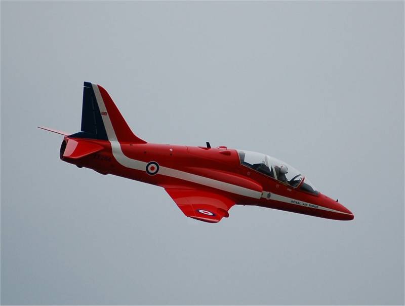

Sorry, just had to post this.
Thanks to Dave for a great shot, i have zoomed in on the original and cut.
The detail on the shot is incredible, when you consider it was a fast moving target!
Great camera and photographer.

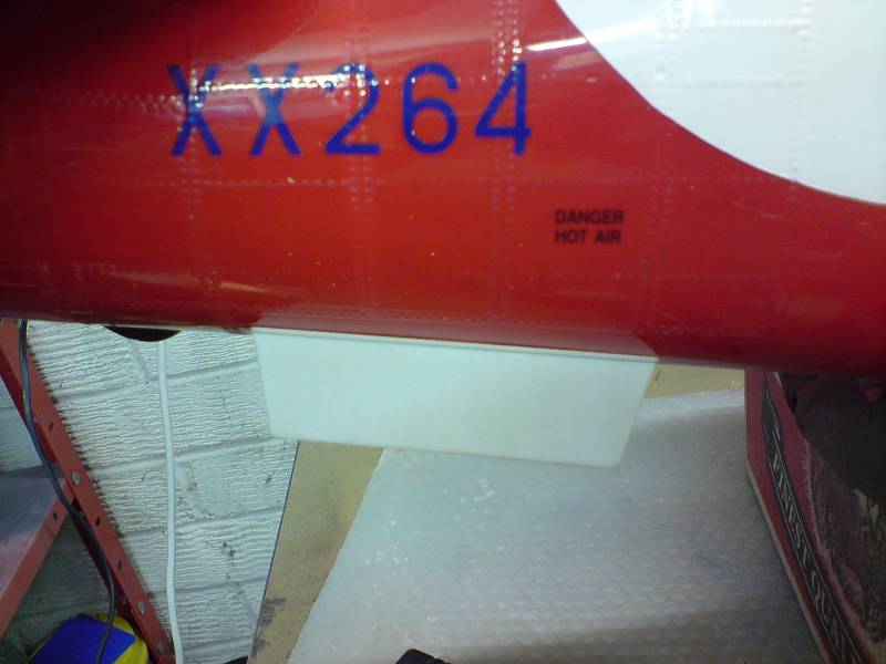

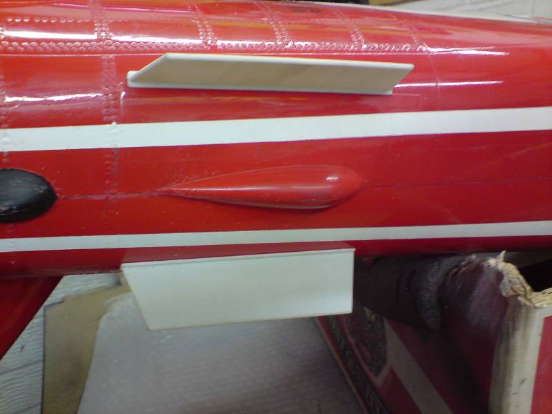

Having done the under wing 'stuff' i decided to do the under tail 'stuff'.
The pics show test fitting.
I shall paint them for the next pics.
Paul

Last one

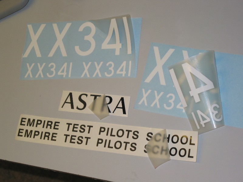

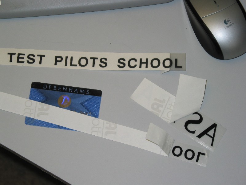

I've met a problem with the decal set, specifically the press-on ones. I presume that your "Royal Air Force" logos were press-on. The attached pic shows the snag.
The under-wing and fuselage serials come away from the backing sheet OK. However, the "Empire Test Pilots School" and "Astra" logos remain sticking to the backing sheet. I'm wondering if I've missed something. Maybe the latter two need water-soaking first?
I've emailed Ralf to ask him too.
Gordon

Wow. Got an instant reply from Ralf this morning - thanks Ralf.
The problem is that the small lettering doesn't always adhere strongly to the transparent transfer film. The solution is first to rub down on the transparent transfer film with a credit card to make the letters stick harder. Then slowly and carefully peel back the backing paper, turning it back on itself through 180deg.
If the letter still won't release from the backing paper, go back and do the same thing more slowly and pressing down on the 180deg fold, until it does.
Pic shows this in progress.
Gordon
