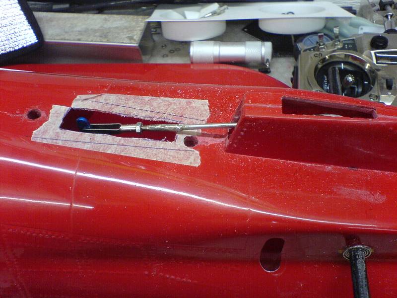

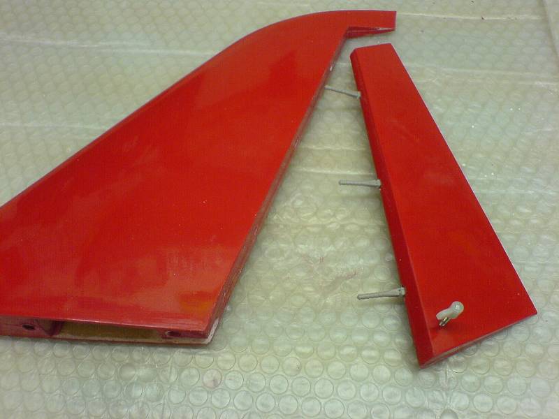

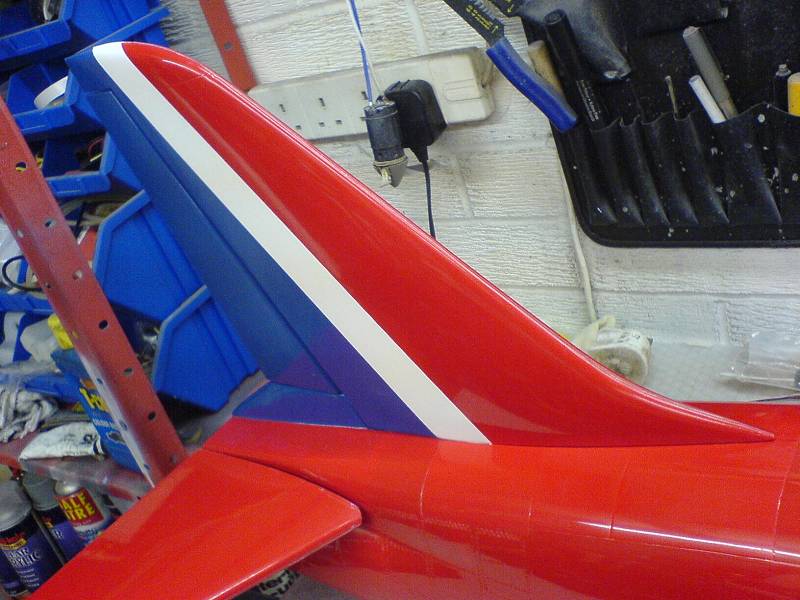

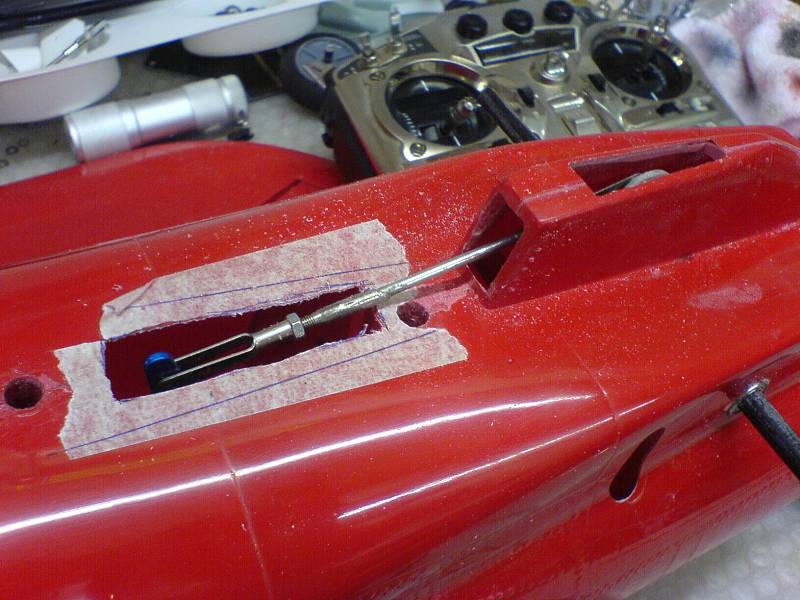

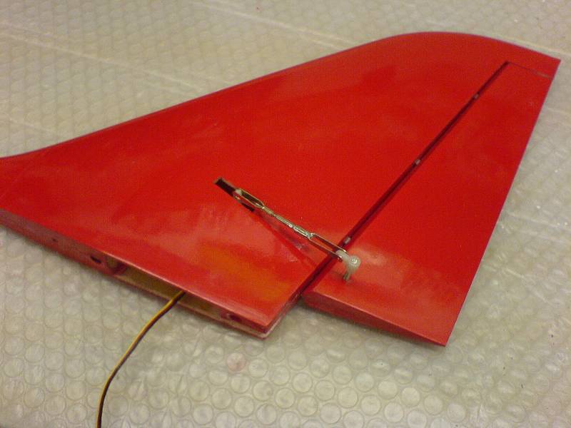

Well
I have started proper now
Nose retract unit is in and former glass clothed.
Fin complete with servo fitted and rudder. [8D]
I have enclosed a couple of photos, there is no point in going into the level of detail I did before.
It goes together much quicker the second time round [:-]
All packed up now ready for Wroughton.
I am taking the F16 and L39, I shall fly both but the F16 is for sale if anyone is interested? (Too many projects, not enough room!)
All the best
Paul

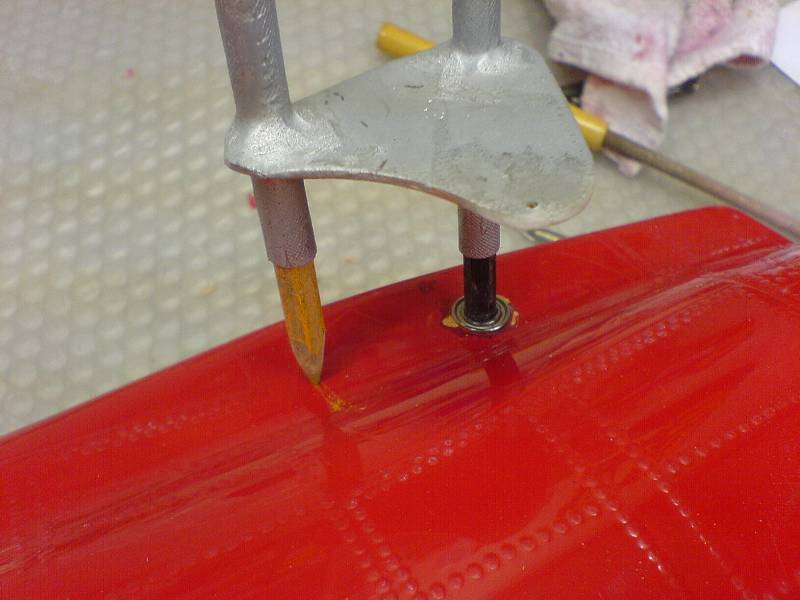

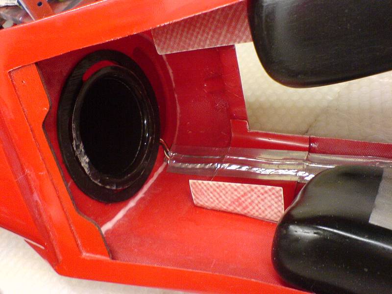

Got a couple of pics tonight.
Work is ongoing.
Paul

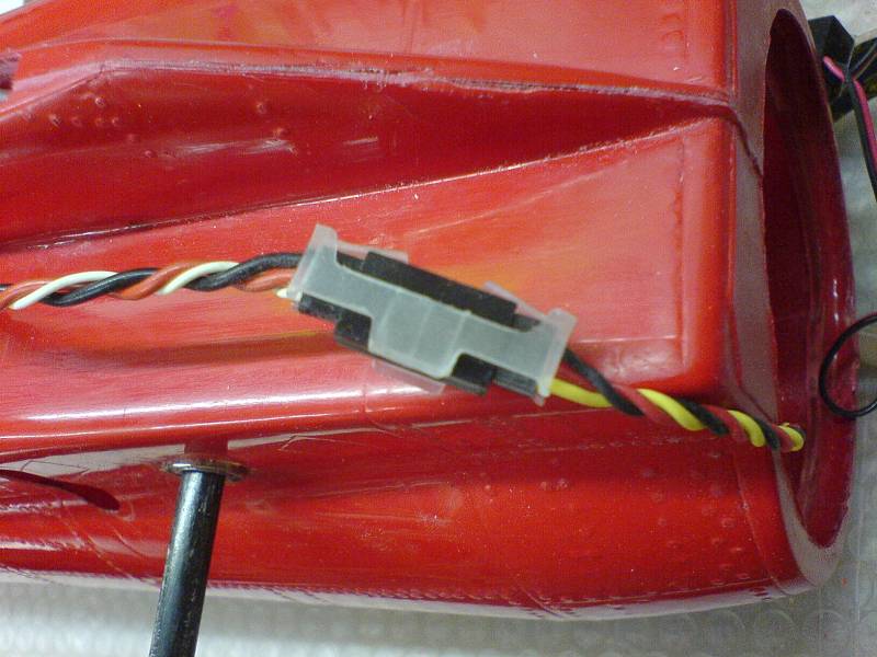

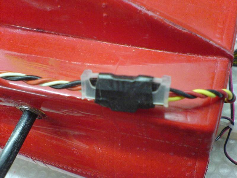

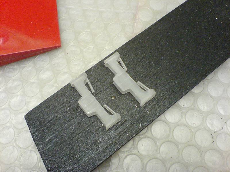

I have been getting on again tonight.
Nice pieces supplied by Fox Comp.
The clips hold together extension lead plugs.
Really simple.
Push them in from the side.
I have a piece of tape around as well but heat shrink would be perfect.
Paul

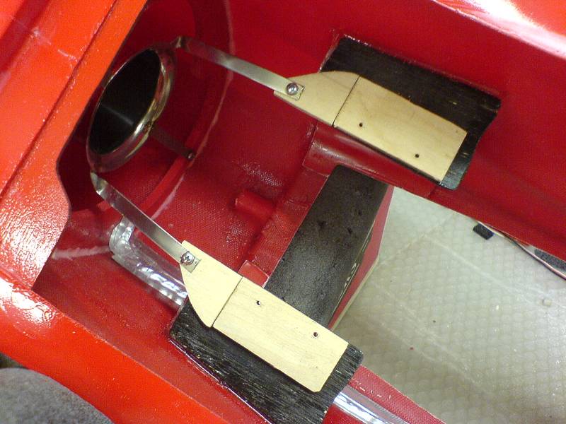

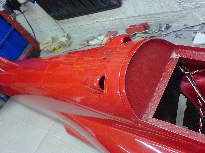

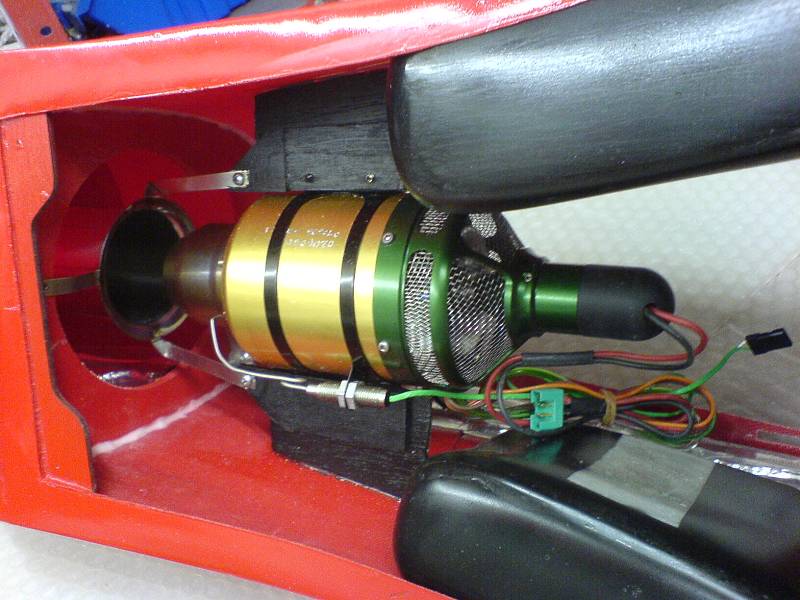

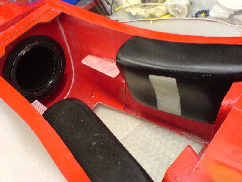

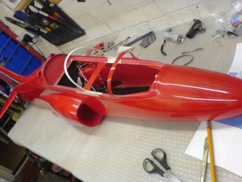

Ok
Update.
Fuselage is really coming on well now; I am at the engine install stage. (It will be removed after).
This model is closer to production standard and has the new coloured tanks and wood.
The tanks are shown loose fitted and as you can see, there is a view window in the side to allow vision of fill level when the top hatch is open. [8D]
I am off to Hanover this week so i will not be able to do any more till Friday.
Paul

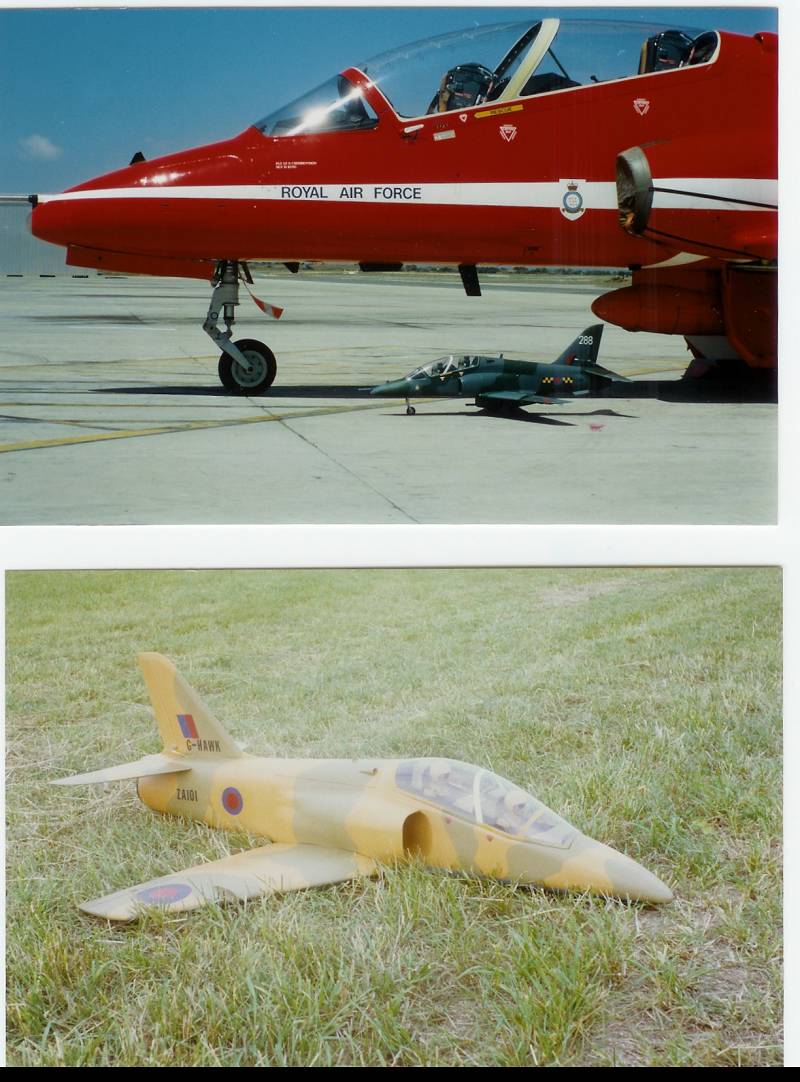

RCM&E plans, god i remember designing that as if it was yesterday. (or was it tomorrow)

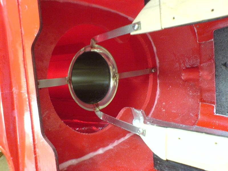

Well..... back to the model.
I have now got the tailpipe in.
As an experiment I have left out the bypass tube.
I don’t use one on either the L39 or the F16.
These function perfectly with no heat issues.
It simplifies the installation and reduces weight.
I have discussed this with Fox Comp and they await the results of the test.
Paul

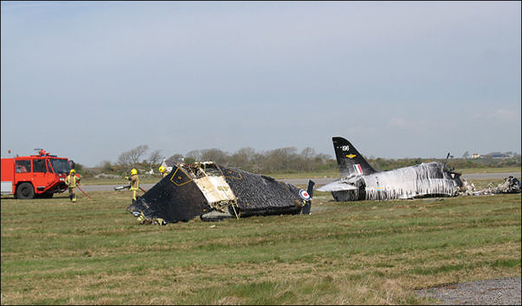

Default RE: FOX COMPOSITES Bae HAWK, Build thread
Oops ! Seems like the full size ones have their own problems.
Pilot banged out and is OK

Here are some pics of my old RCM&E hawk and my JFM Hawk next to a Red Arrows one.

Nice to see the JFM Hawk (now Fox Composites) next to the Red Arrows, looks good
That smashed full size Hawk, i had a scale wreckage of that one
That picture of my old Hawk design... brings back a lot of memories, many thanks[8D]
Paul
Old 04-21-2007 | 02:37 PM
  #173
GrayUK's Avatar
Joined: Oct 2003
Posts: 3,601
From: Dunstable, UNITED KINGDOM

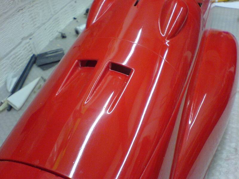

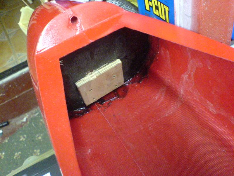

OK chaps, been busy today.
I have
1) fitted the top hatch and canopy catch
2) trimed and fitted the canopy frame.
3) Made the tank retainers.
4) Started painting [8D]
Starting to look good now.[8D]
Paul
