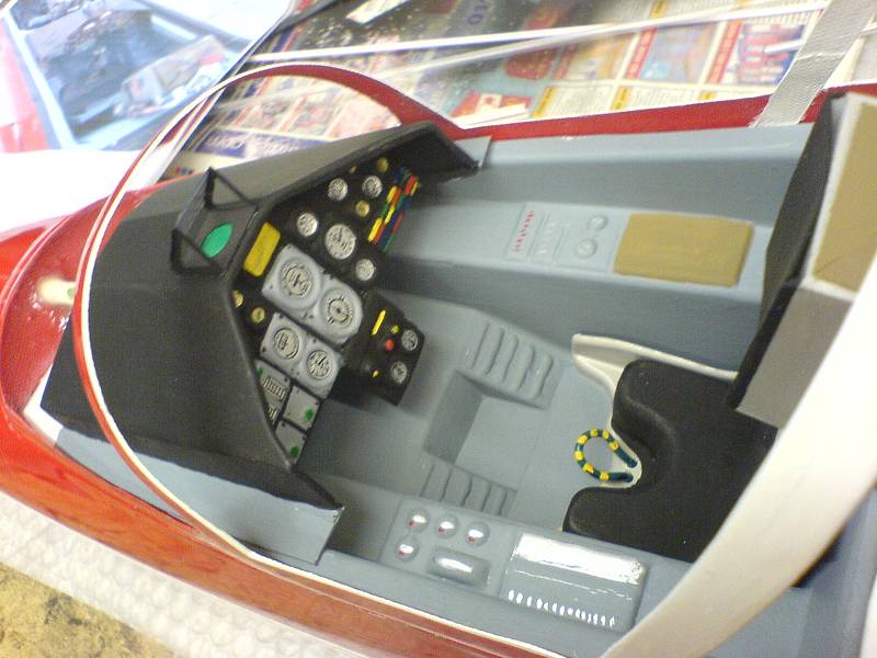

Just a quick update (just for Nobby )
Been tarting up the cockpit a bit.
More to follow tomorrow

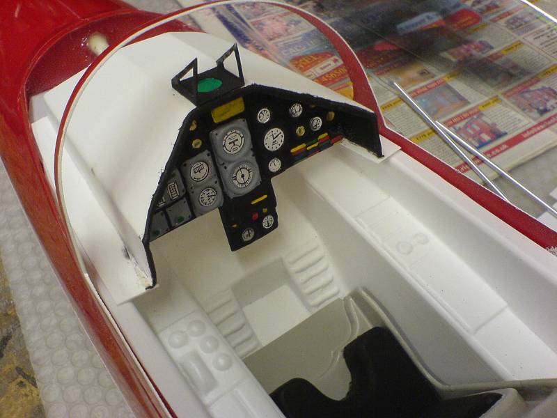

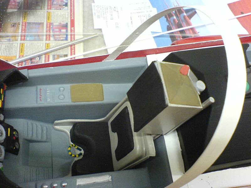

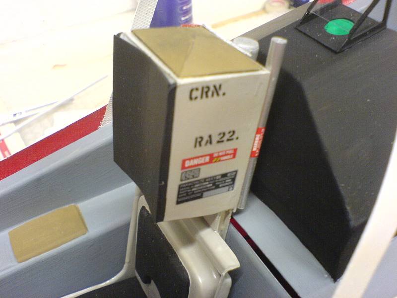

Cockpit is taking shap.
I have modified the ejector seat head restraint to look more scale.
Paul

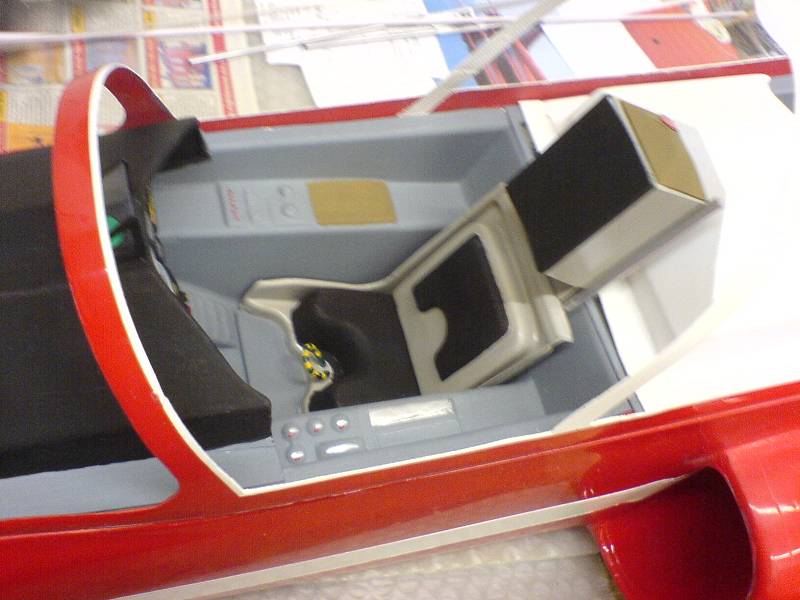

Just a quick update again.
Bit more work on the cockpit, should have the cockpit finished tomorrow.
Paul

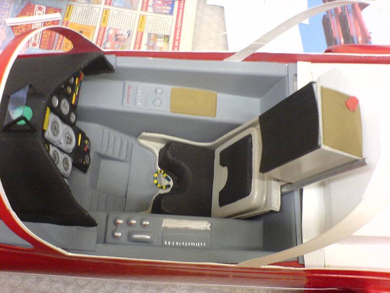

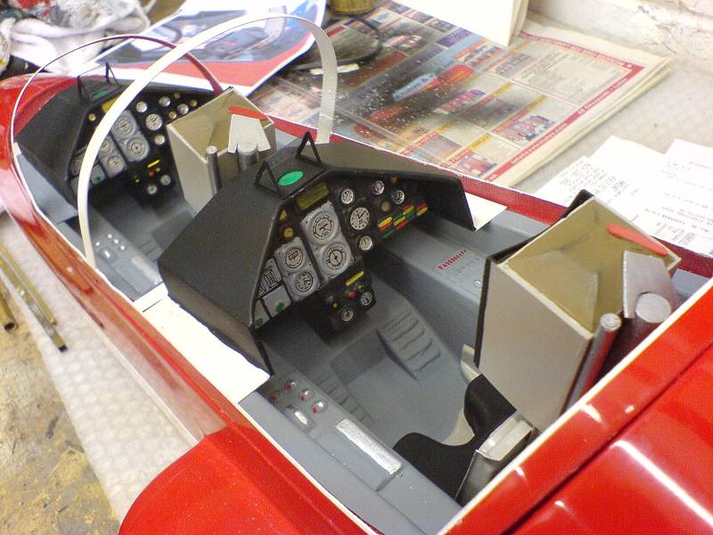

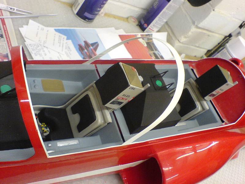

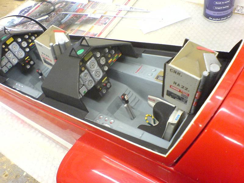

OK guys
Cockpit makeup is almost done.
I have included a couple more pics of the cockpit.

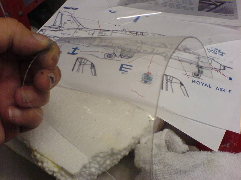

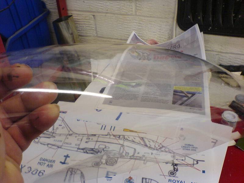

You may remember from the earlier build that the canopy is designed to fit over the outside of the frame.
This is not scale but was done for simplicity.
I know that Fox Comp are changing this for later kits but I was determined do make mine fit on the inside of the frame to make it 'look right' for the new cockpit interior.
The only way I can see of making it work is to cut the canopy at the front beneath the frame
This gives two pieces.
The cockpit interior is fitted and glued in place and the front section of canopy fitted.
It is then possible to fit the rear section.
I have included two pics of the cut canopy and will show the rest of the assembly tomorrow.
Paul

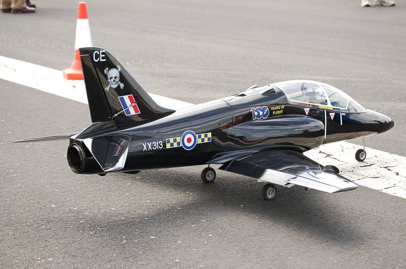

Default RE: FOX COMPOSITES Bae HAWK, Build thread

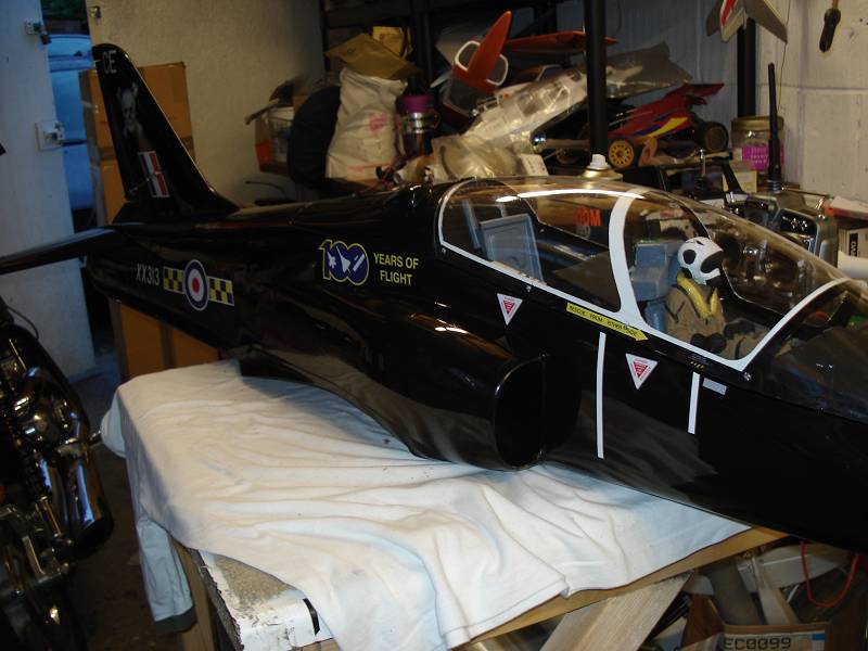

Here is a couple of pics of Trevs black Hawk now kitted out with Tailormade Decals.
Looks much better Trev, does it fly faster...
Paul

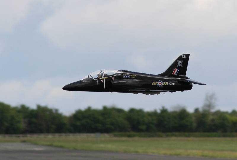

Old 05-12-2007 | 04:11 AM
  #224
Joined: Feb 2004
Posts: 335
From: Rickmansworthherts, UNITED KINGDOM
Paul,
Not that you need inspiring but a flying shot from yesterday to keep you going. Taken at Classic Jets by Dick (top bloke) Spreadbury.

Old 05-12-2007 | 07:28 AM
  #225
GrayUK's Avatar
Joined: Oct 2003
Posts: 3,601
From: Dunstable, UNITED KINGDOM
Fantastic shot
Looks so much better with the decals.
Paul
