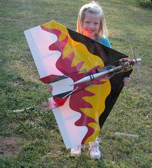

ORIGINAL: Gregor32
Shaun i thought the exaust would be too hot for a cable tie!
the black ones are for high temp and also have UV protection to prevent deterioration in sunlight. i use them on all my pipe retainers, included a pic of the DD as it's easier to see it
kc
