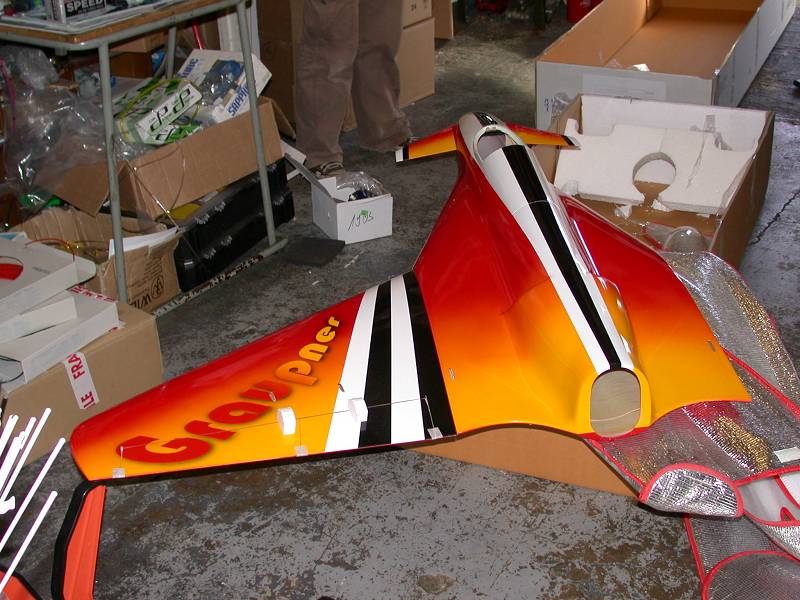

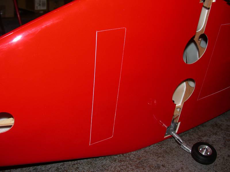

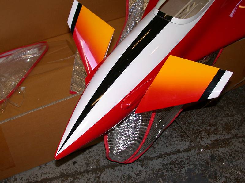

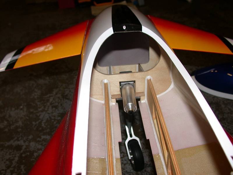

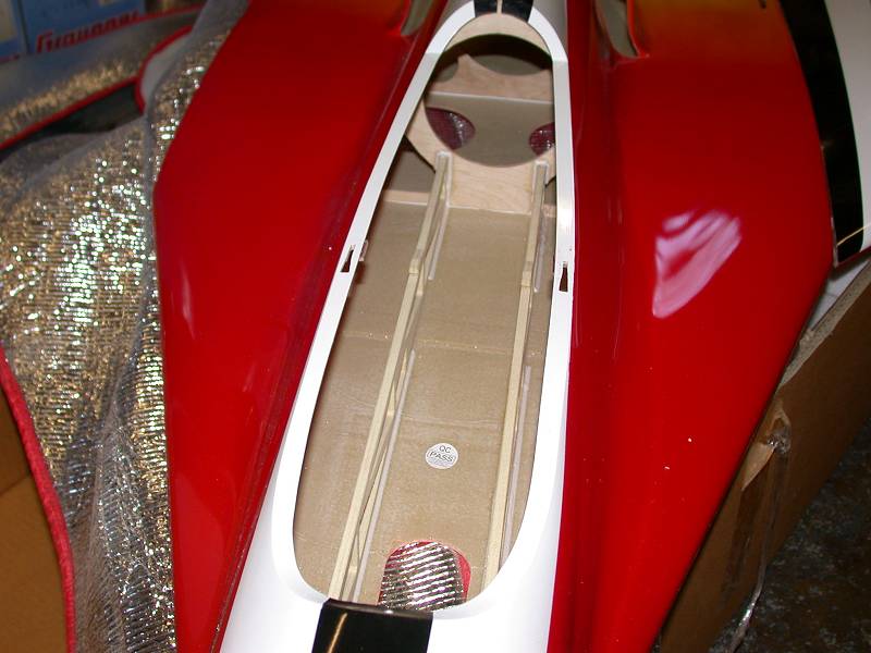

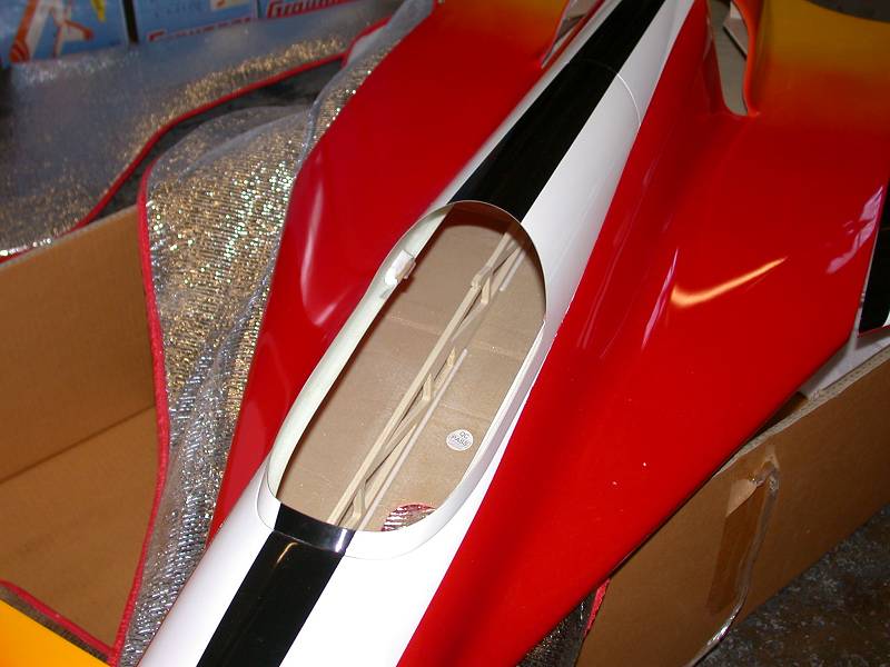

The first Harpoon II kit arrived with me last week. Model is the original Graupner Harpoon with a new canopy and larger opening and the addition of canards.
The kit now comes with control horns fitted to speed up construction.
My model is going to be a test vehicle for a two axis vector system.
I intend to fly this from grass with trailing link legs and lots of power

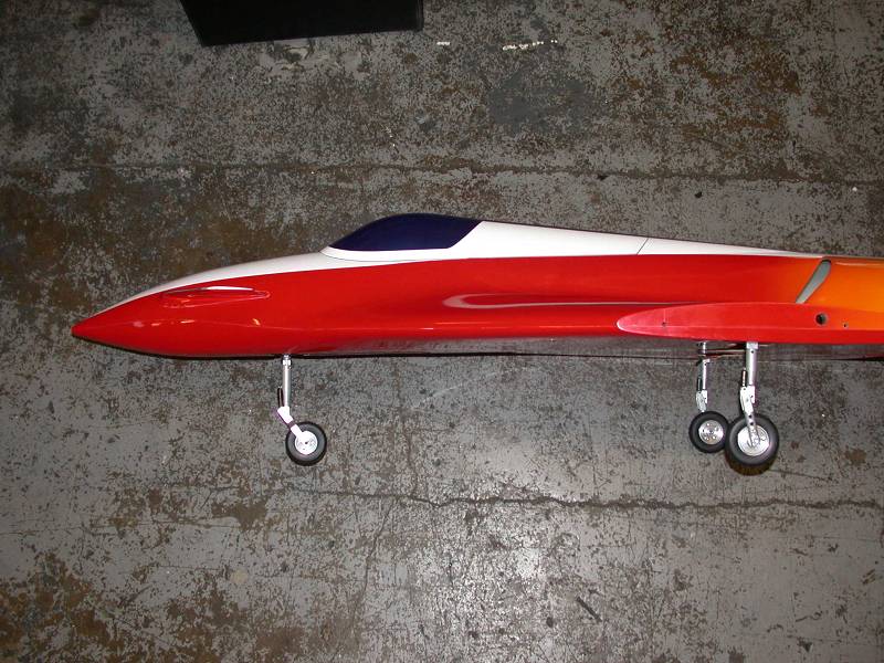

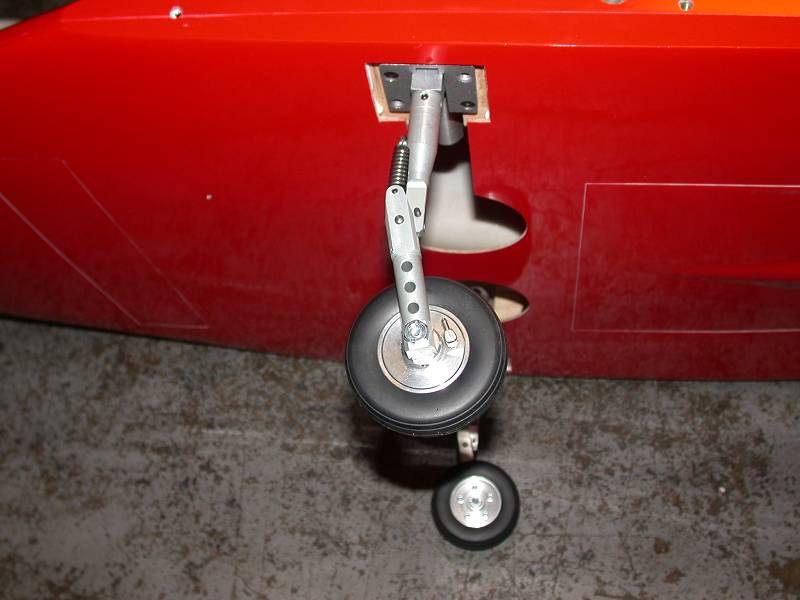

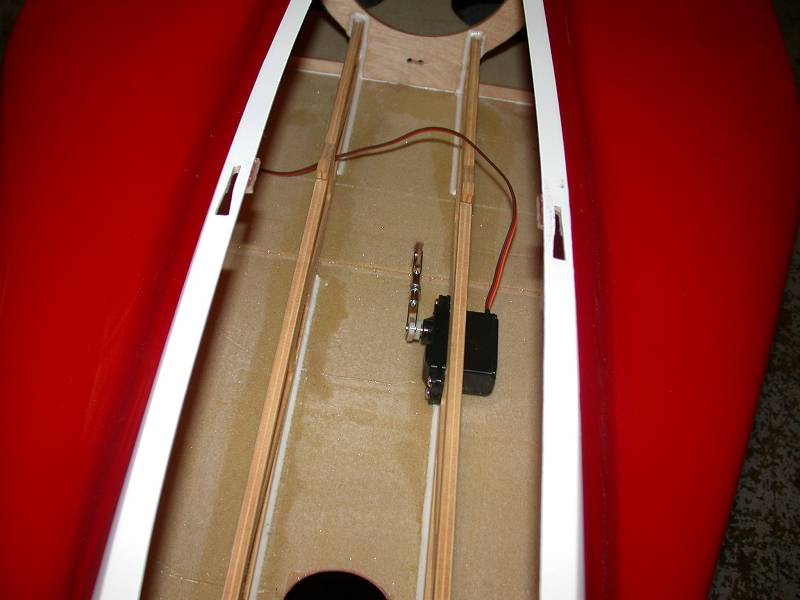

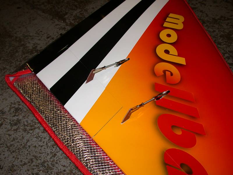

Some shots this morning

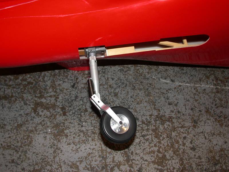

I fit the elevon servos the opposite way to shown in the instructions and use the 20mm JR Superservo arm.
I increased the width of the airbrake blade by 6mm-1/4" to help with drag for our short grass strip.
