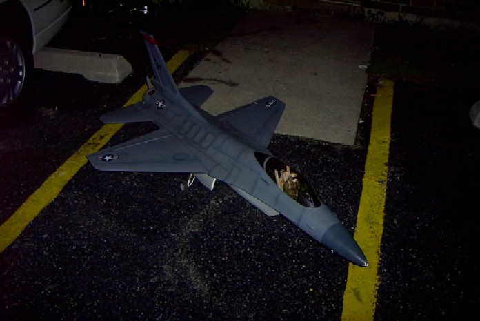

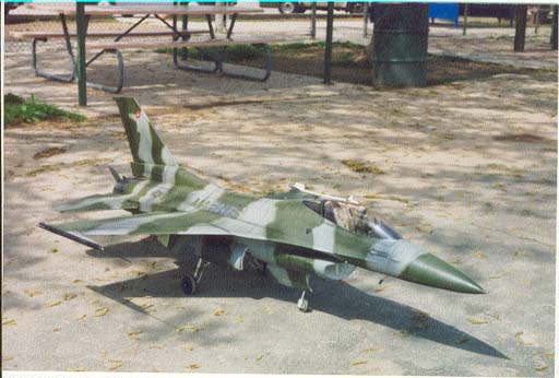

PS. here is a shot of my CBM F-16

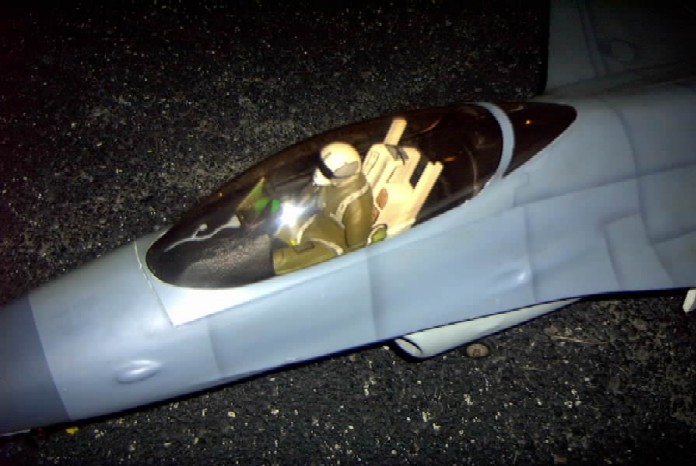

Finally, Shockwave, my baseball cap is completely off to you as you have done the impossible...not only completing the F16N, but, made it look like a million bucks in the process. Nice job! If it weren't for that thing at the tail end, I'd mistake it for a much higher priced DF model. Again, excellent job with the detailing.
Steve
PS: James, you too get the "baseball cap off award" for successfully completing the F16N. A very nice job as well. But, have you nothing better to do than surf RCU at 2 a.m.!

HI RAZOR,
GREAT LOOKING F-16.COULD YOU SEND ME INFO ON THE COLORS ON YOURS, OR E-MAIL A FEW PIC. STILL HAVE MINE IN THE BOX YET.BUT WILL WORK ON IT THIS WINTER WHEN I SNOWED IN AND BECOME A HERMIT. STILL GONNA GO WITH THE IA. NAT. GUARD SCEME. ANYWAY I LIKE THE PANNEL LINES. LOOKS EASY TO DO.
NEDYOB
