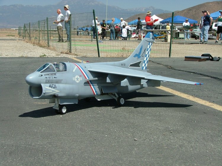

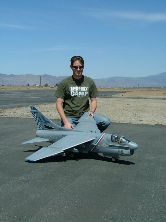

Mike has some very good points. The A-7 is a very easy flying airplane. I have flown the airplane with the MW-44 gold and our E-Turbax fan. Both fly equally as well...though with the gold the airplane approaches 180+ at full throttle. 75% throttle is a good cruise (140-150) punching it to 100% for climbs etc. The size is nice in that it easily fits into a compact car (I can fit the airplane in one piece into my Subaru sport wagon). It has a 1-piece removeable wing so breaks down in to a small amount of space. I'm using a Dubro 32 oz tank with a 4 oz header and get 5-7 minute flights depending how hard I am on the throttle. There's a 48 oz conformal tank available. I've attached some pics of my turbine bird.
