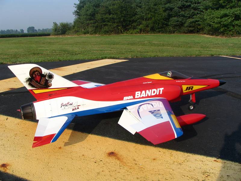

Can anyone tell me what the recommended throws are on the Original Composite Bandit?

Here ya go...
Elevators: Up 1 1/8", Down 1" measured at the root.
Rudder: 1 3/8" measured at the bottom.
Ailerons: 1 1/8" up, 1" down measured at the aileron/flap joint.
These are high rate deflections....cut the ailerons and elevator in half for low rate, then tune 'em up to suit.
Take off flaps 15 degrees, landing flaps 45 degrees.

HI,
Rudder 1 1/4''
elevator 1 1/8''up and 1''down
Aileron, measured at the AIL/Flap joint
normal 9/16''up and 3/8'' down
High rate for windy conditions 1 1/8'' up and 1'' down
CG 8 1/2'' Aft wing root, gear down, tank empty.
Rcpete

Slight Clarification:
CG is 8 1/2" with empty tanks, but with a full UAT, gear down.
