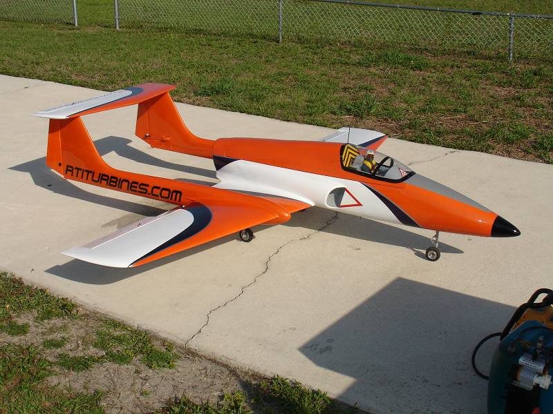

You can't go wrong with a Boomerang XL. It's my first jet and I could not be happier with mine. My flying buddy has had two Boomerang XL's and two King Cats and prefers the Boomer .
