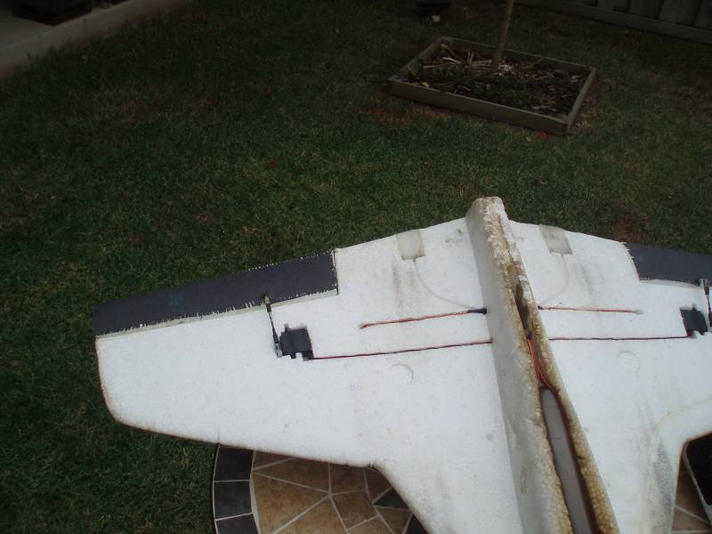

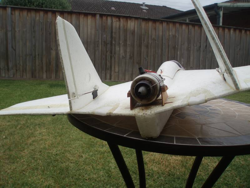

Hi All
Here is some pics of my Twinjet, I have laminated carbon fibre to the underside of the elevons for stiffening(a definite must have), added rudders for the extra fun factor, used a plax bottle for the fuel tank(500ml). The plane is on 2.4 gig and I am running 2 x 800 mah lipos, one for ECU and one for radio. The fuel tank only has a felt clunk, no hoppertank/uat etc...The plane is set up to be as simple as possible so you can take it out on a Sunday with 5 litres of fuel, minimal ground support equipment and have a heap of fun ripping around the sky...And I do mean rip!!!!!
By the way servos are HS87MG on elevon and DS 385 on rudders. You can see by the pics she is well worn..around 90-100 flights of 7mins and the engine has not missed a beat, I am amazed how reliable this engine has been..well worth the money I paid for it.
BRG, Craig Dyer
