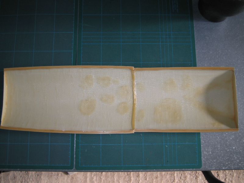

I am looking for a reliable, safe, secure and neat way to fit the main hatch on a BVM MiG15.
Currently I am planning on having two locating pins mounted at the forward edge of the hatch, securing into the rear of the cockpit x-brace which is part of the fuselage moulding, then at the rear possibly two of those sprung canopy hatch pins, locating into the rear fuselage section - this however will leave two wire 'lugs' sticking out from the top of the rear hatch, but as I see it there is no rear option here[&o]

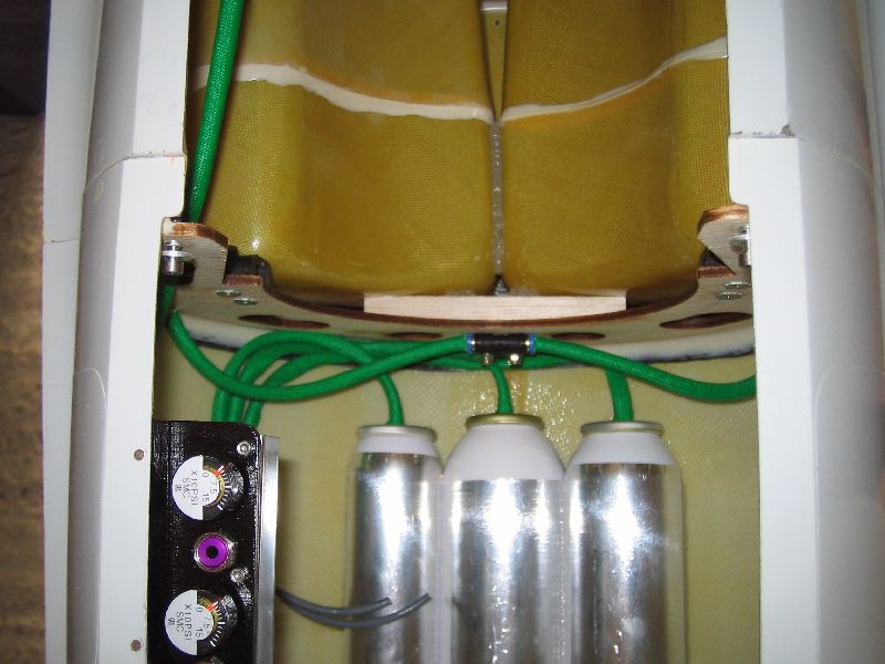

The main problem is in the hatch mid-section. The fuselage hatch is long (see pic) and in the middle it tends to flex, and not lay completely flush with the fuselage, so really there needs to be a simple securing system fitted in this area (see close up of area for securing hatch centre section pic).
I have considered magnets, although achieving the correct 'pull' and release to allow securing and removal is a bit hit and miss, I have considered a sprung catch using bent piano wire, locating in a slot cut into the lip on the fuselage top, again not sure on the effectiveness.
Do all you experts have any ideas, I really need something which is 'concealed' and not visible from the outside - any ideas really appreciated.

You could always fabricate a "L" shaped piece of plywood (or composite material) and have it slide into place (its glued to the hatch) into a slot in the fuse, one on each side, that sucker will keep the mid section down, but this only works if you have room to slide the hatch back when wanting to remove it, and im not sure if thats your case ?

Yep, thought about this as well, it will probably help but not sure it would hold the panel closed and in line sufficiently during flight etc as the fuselage flexes etc - I'm only assuming here though as I am a 'rookie' to building jets, please correct me if I'm wrong.

I use poly ply tabs to keep the center part of most of my hatches flush th the edge of the fuselage. Set the poly ply into the hatch tack it with CA then aeropoxy them into place. Measure and cut you slot in the fuse and adjust if necessary fo ra good fit. Round the edges on the tab so it slips in and out of th slot easily. If the hatch tries to flatten out you can always add a small ply former.

For the spreading issue - on long hatches I usually use a combination - tabs as David suggested, and sometimes also a threaded pushrod that just connects from one side of the hatch / fuselage to the other (turning a clevis in or out a bit allows for adjustment of the "pull").

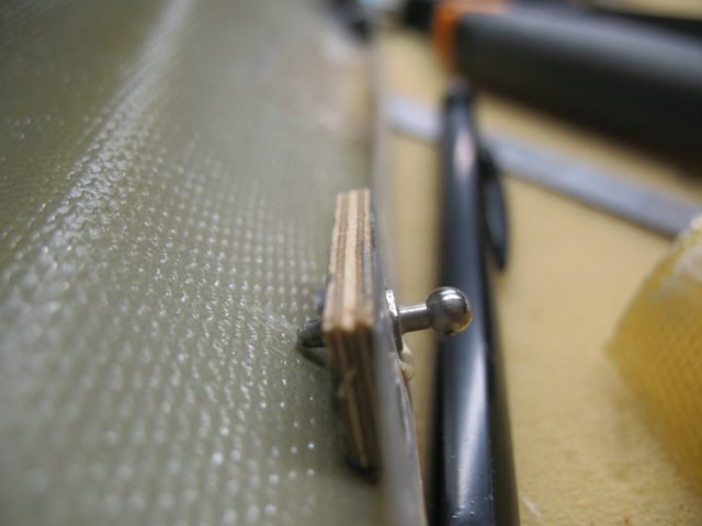

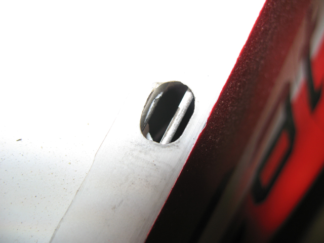

Ok my wife sent me a couple of pics that sort of show the technique. I learned it from Kent Nogy I think.
My technique is to put a large threaded ball (generally with 4-40 threads) screwed into a blind nut (t nut) embedded into the flange of the hatch, maybe 3/8 of an inch from the edge (the distance depends on the slope of the hatch at that spot).
On the fuselage side, I install 2 music wires, maybe .075'' diameter, maybe 2 inches long, spaced just about the width of the shaft on the ball.
Now the way I do it, is to inset the 2 wires into slots I have milled into a couple of pieces of 1/8" ply (maybe 1/2 inch square). I CA the wires into the slots, then I keep checking the tension by snapping the 2 wires onto the ball from underneath the hatch opening (with the hatch installed obviously). You keep belt sanding the top of the little ply tabs holding the wires until the fit is tight. You should get a very nice tight SNAP action when you have it right.
After everything fits I epoxy the wire assemblies into the fuse with the hatch installed to make sure everything lines up. You can make slight adjustments by bending the wires.

I have worked out and fitted a 'mid section' alignment system to hold the cover in the right place, now I have to decide on how the canopy comes off, it is likely that I will have to make the canopy easily removable, as the cover will need to be lifted straight off rather than backwards.
