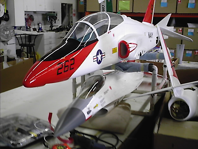

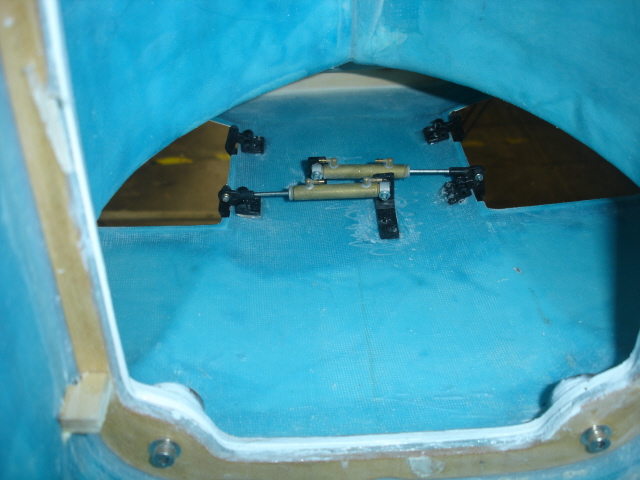

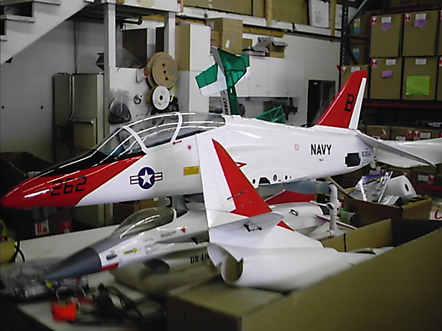

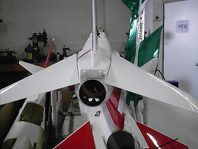

This is one airplane that for some reason I love the looks of it, maybe it's because it looks like an F-4 ( I love the F-4s too, yeah!!!, that may be it )soon I will start the build of my second one and I will share some of the bulding with the jet community( the first one is history, not by my doing ).
Pictures to come soon, ( not a build thread just pictures and some comments )
PS: This is my Hawk, any comments or sugestions are welcome, PLEASE do not turn this thread into any kind of political debate.
Thank you all and lets enjoy our hobbie.

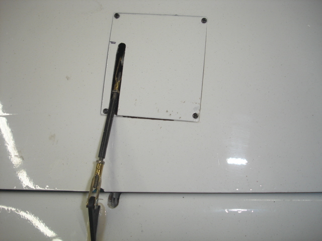

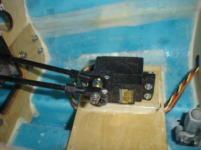

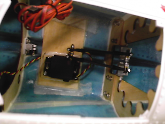

Here are the first pictures, by now I have the Rudder servo installed ( 3421 JR ) and the vertical stab on the fuse as well as the elevators with the Servo ( single Hitec 333 oz ) in place with the push rods attached to the elevators, this single servo for the elevators has been tested before with excellent results, I tell you this ARFs are getting so much easy to build ( slide in and secure ) and the quallity is impruving by a ton.

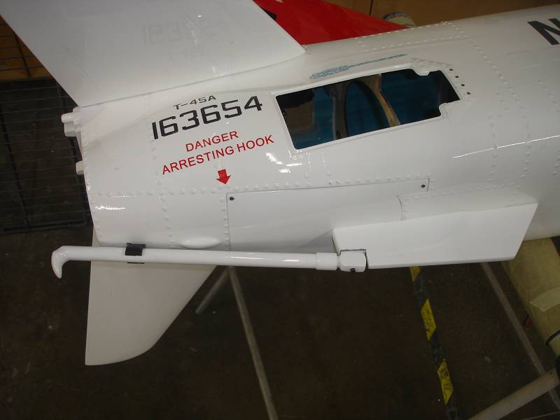

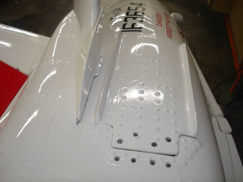

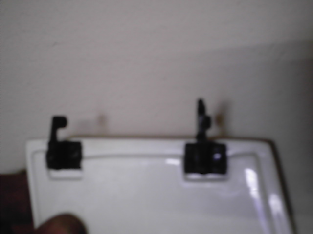

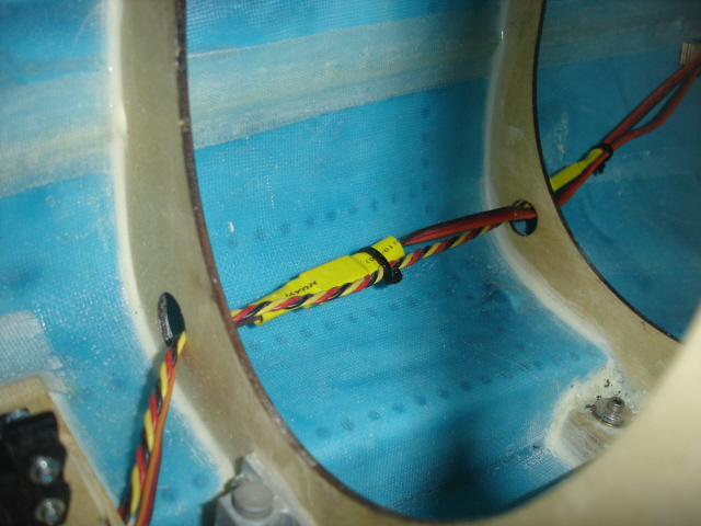

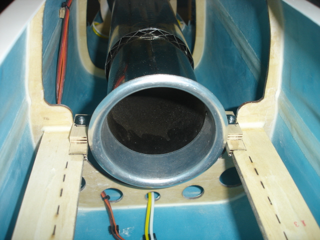

This version of the Hawk has a lot more details than the prototype I build at first, airbrakes, 5 pices nose doors, tail hook and base. I do love the wing but you got to be carefull with this wing on the slow flight portion if it slows down to much you will get a nasty snap roll, so you have to keep that in maind on the final slow down to landing, you get the wing fences in the arf kit but only the Red Arrow use them not the T-45 so, put them a side.

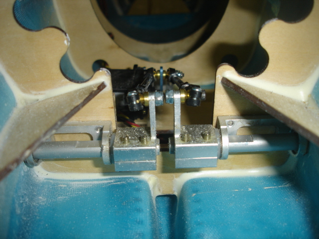

Correct me if I'm wrong but I think CG is at 180mm. There is lots of room in this airplane so the set up of the trays will not be a problem at all.
PS: I know some of the pictures are no the best, I'll try to get sharper ones in the future.

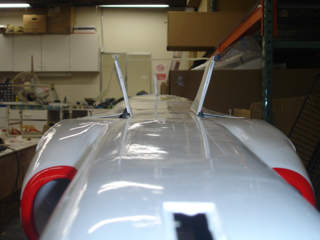

On the prototype I noticed that I was going to need more flaps, so I made sure I had enough on this one when I glued them to the wings.

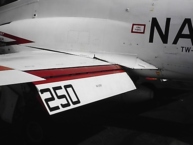

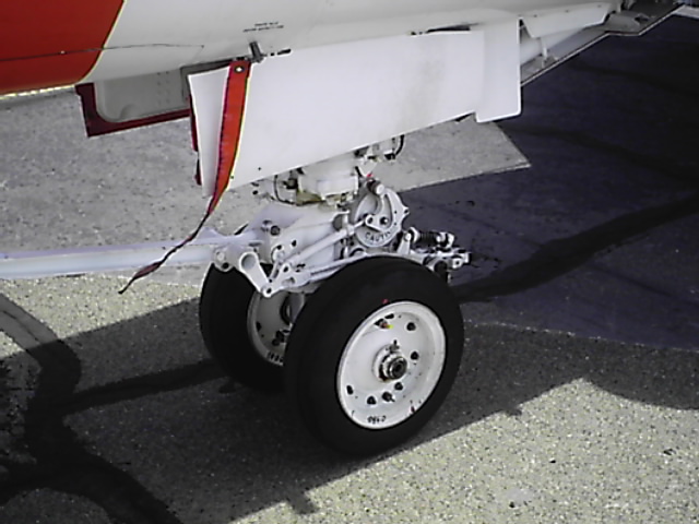

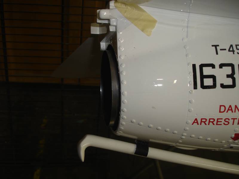

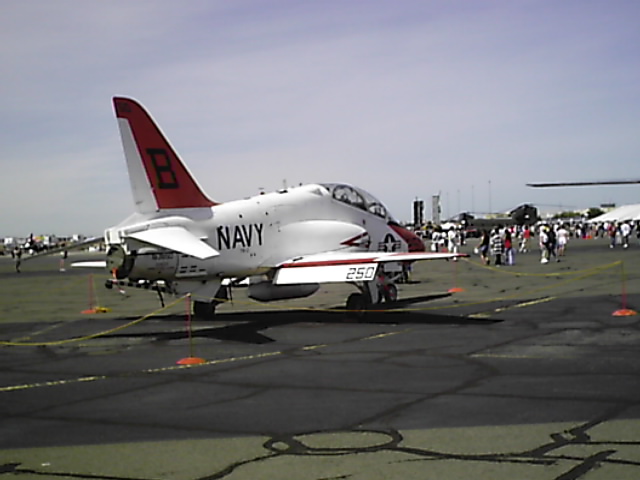

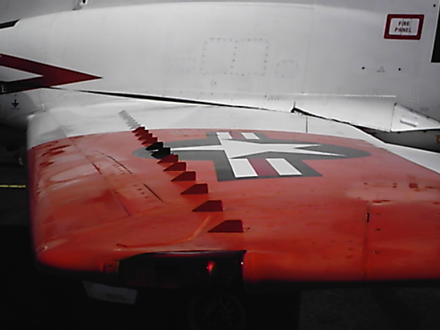

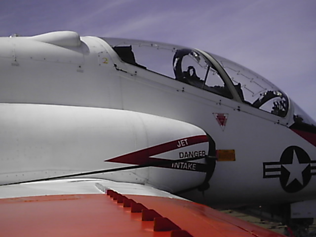

Here are pictures of the full size I found at the airshow in Mather air field Sacramento, Ca early this summer.

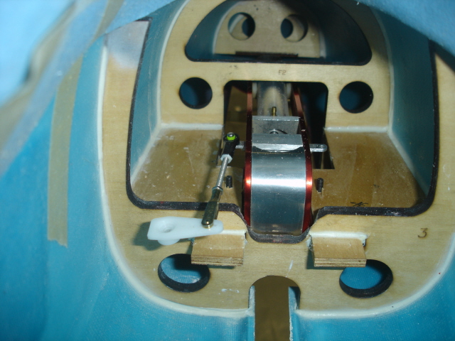

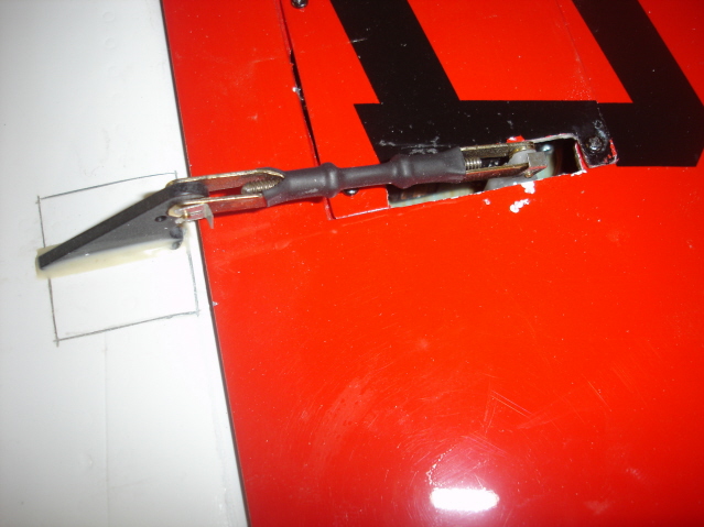

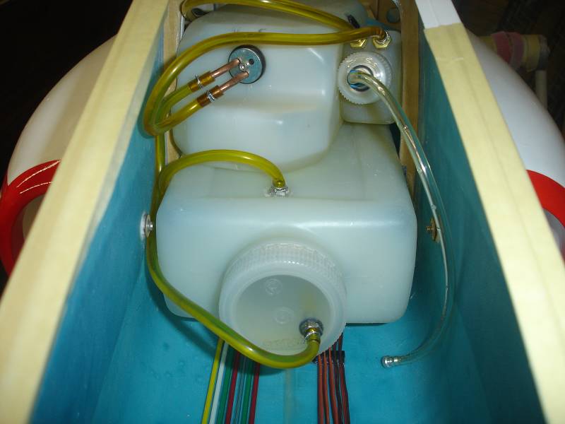

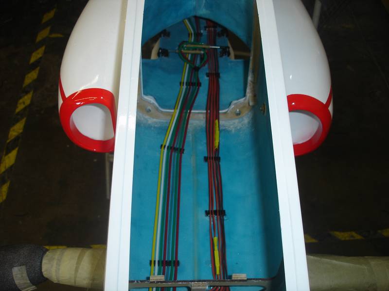

Here is some of my progress on the Hawk.

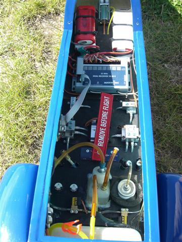

tray

As always, very clean lay out Carlos. Now lets fly it!! or lets just fly....

Steve, I'm sorry for not replying 'till now, but i have been working my &$$ for very long hours every day, so much that I haven't work on the Hawk for days but Thursday I'm on it all day.
I understand your delema, we have flown this very same model ( Fei Bao Hawk ), we flew it with a CG that gave us a nose heavy set up, on landing it didn't wanted to rotate, for that reason we made a long landing, past the end of the runway, the CG of is just infront of the main landing gear and yes, the model will want to seat in its tail with no fuel, some models are that way.
I will investigate a little more regarding the CG point, but Sandor has some good info there, we flew this Hawk before ( the first one ) at florida Jets, Ali was also there.
Good luck on your first flight, to bad I can't do it first, my work schedule is just off the scale for the moment. Oh, my Hawk will be ready for the Fresno jet meet in Sep.
One or two pictures.

Here are some more pics.

the rudder servo is a 2431 metal gear with a standar plastic arm.
