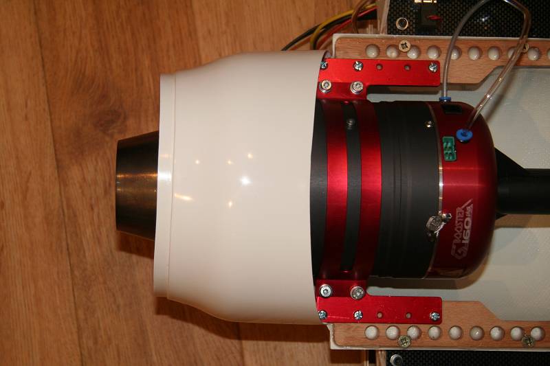

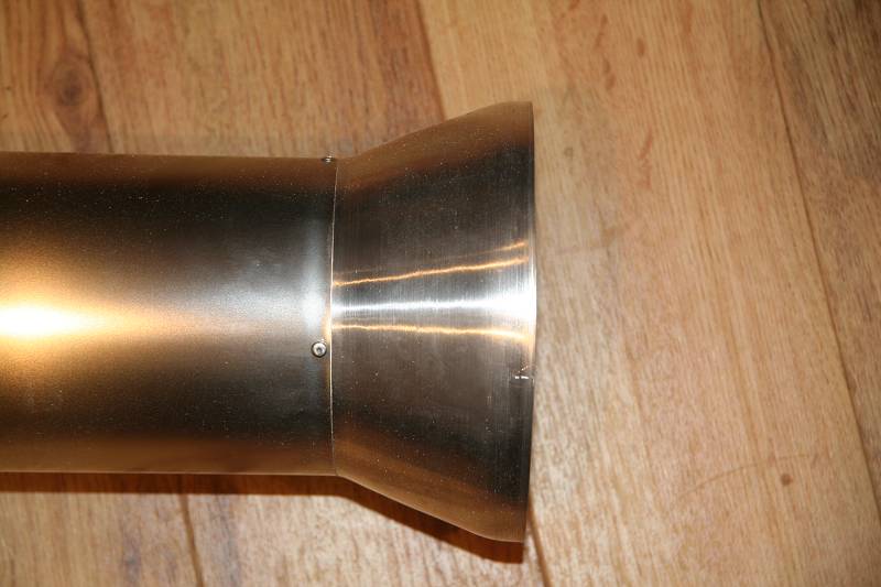

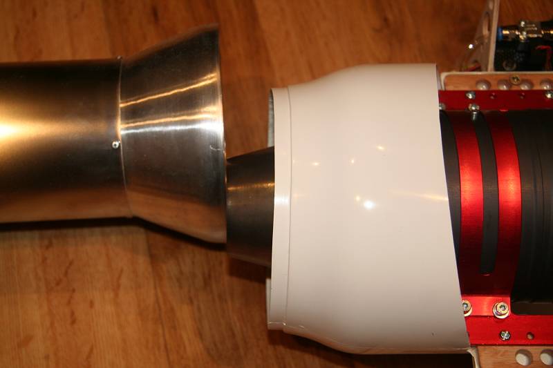

Guys,
The way in which the turbine/mount etc is having to be installed it is going to be very difficult to alter my turbine position so I thought I'd double check the opinion here.
From the pictures of the tailpipe and bypass, would you say my Booster 160 was too far back, too far forward or about right!
Cheers,
Mark

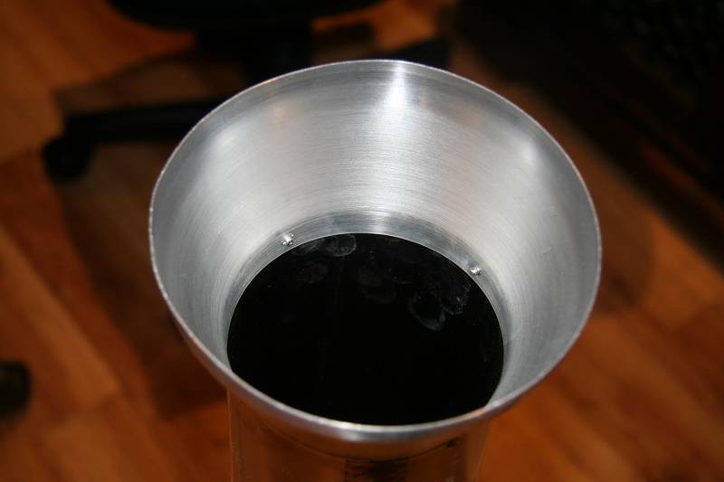

What you do not show is the inside of the pipe Is it a single wall or a double wall pipe and if so how much does the inner pipe stick into the bell mouth?
Jerry

Single walled pipe and the bell mouth stops at the entry to the pipe....

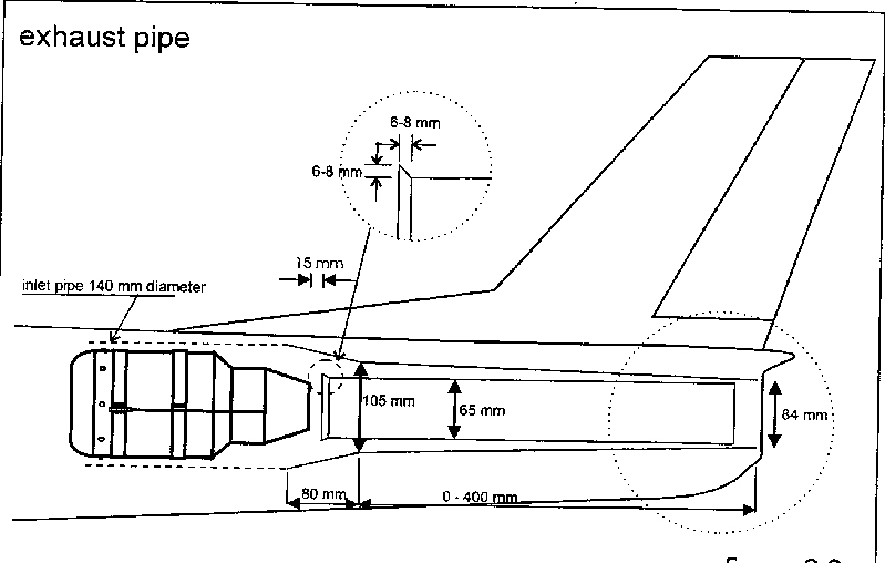

I have a Mercury HP in a bypass and the distance is 19mm
runs ok plenty of power and no heat problems.
Have tested my Pegasus HP on an open pipe same distance
with no problems
brian

I think its somewhat on the "too close" side, but should be ok.

this is the actual recomended setting
from the manual for the Pegasus Hp
brian

ORIGINAL: schroedm
Edgar, if John says 19mm works OK on his Pegasus but you think it's too close, what distance would you recommend?
I'm running my Artes Rhino (160 N) at about 25mm to 30mm. Double walled pipe.
Sorry don't have direct experience with your engine or plane. I believe in the past people used to put the engine tail pipe into the exhaust pipe anyway, so tha's why I think it should be ok.
Good luck,
