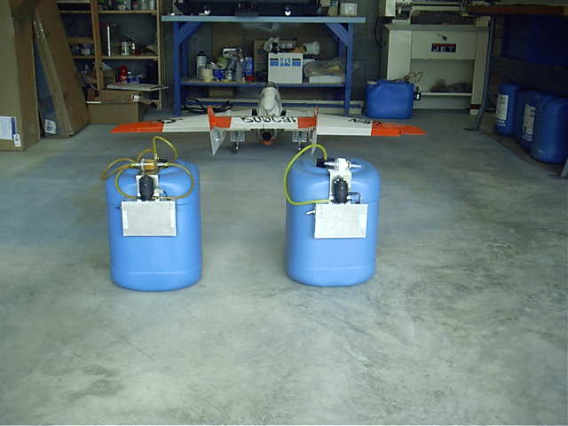

I have to agree with Tommy's comments. I just ordered one. See my "Jersey Modeler fuel can" thread in this forum.
Tom
Here's a picture of "Mike's cans"

Old 03-14-2003 | 09:12 PM
Posts: 7
From: north carolina
Default "Jersey" type Fuel Can
wow,you could eat off of tom's shop floor!!!!
Old 03-14-2003 | 09:23 PM
Posts: 110
From: columbia, TN
Default shop floor
A friendly correction this is Mike's floor, or should I say Mike's wifes parking spot. I thought I would make the correction because Mike's wife reads RCU.

Mike's cans look like they have the Kavan pump on them. The Jersey modeler can has the jetcat pump on it. The JetCat pump is far superior to the kavan pump. I have owned a bunch of the Kavan pumps, and every one of them leaks.
DR
Old 03-14-2003 | 10:40 PM
TJK
My Feedback: (69)
Posts: 324
Received 2 Likes on 1 Post
From: Camp Hill, PA
David,
You are correct, Mike said he uses the Kavan pump. Did your pumps leak from the start or was it something that developed over time? A leaking pump is no fun, especially when it leaks kerosene!
Is there a fix to the problem (other than not using the Kavan pump!)?
Tom

Yep, David is right. Had two of the Kavan pumps and both leaked. If anyone needs the "Jetcat" style pump I have a few that I will let go for 55.00.

Not to take anything away from Michael's can as competition is a good thing in my opinion.....But, after having a long discussion with Mr. Jersey Modeler himself I realized that some thought went into the electrics of his cans. Most notably is the use of an EXPLOSION PROOF switch. Kerosene is not the most volatile substance in the world as its' flash point is rather high compared to other fuel. But hey, given the right conditions with the right vaporization on a hot summer day----BOOM! Also, there is a good reason he uses plastic instead of metal to contain the electrics/batteries. Again, I don't want to take anything away from Mike...I met him at Superman and he is a very personable fellow! But, there is a reason for the high price of a Jersey Modeler fuel can.

The Kavan pumps I had leaked right out of the box in some cases, and after a little use if they did not from the start.
Kevin,
Sorry to say but even the Jersey Modeler can is NOT explosion proof wiring. I am an electrical contractor, specialize in Industrial wiring and install a LOT of explosion proof wiring (as recently as yesterday) so I am rather fluid on the subject. In order for the "installation" to be explosion proof the whole "installation" would need to be in explosion proof wiring. For example, the motor would need to be an enclosed design, any wiring passing to the motor housing would need to be installed in the appropriate (threaded steel) conduits, with a sealing fitting. The switch would need to be installed in an explosion proof enclosure complete with sealed contacts AND a seal like mentioned for the motor. The charge jack on the bottom of the can could not be there, (chance of sparking when plugged in) and it woudl have to be an intrinsically safe receptacle, meaning it could not be energized until after the plug was inserted. The battery box would need to be explosion proof and not made of plastic, oh yeah it would need a seal installed in the conduit leading away from it to the switch and pump as well.
My point here is that Mike's can is fine just has a lousy pump. The Jersey modeler can is nice, I have two of them but if he built it to be "explosion proof" it would weigh about 200# more than it does right now! Since we are dealing with low voltage and a liquid that has a rather high flash point I'll take my chances with the non explosion proof wiring.
