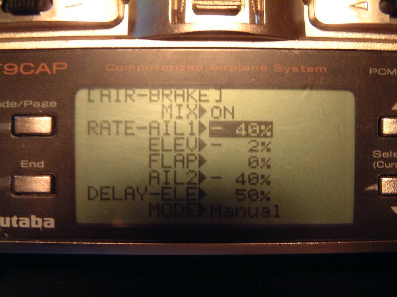

The 9C can do exactly what you want. The Airbrake function should be enabled when switch "C" is in the down position, differential aileron still operates.
Pic 1. With switch "C" in up or centre position, mix OFF.
Pic 2. With switch "C" in down position, mix ON.

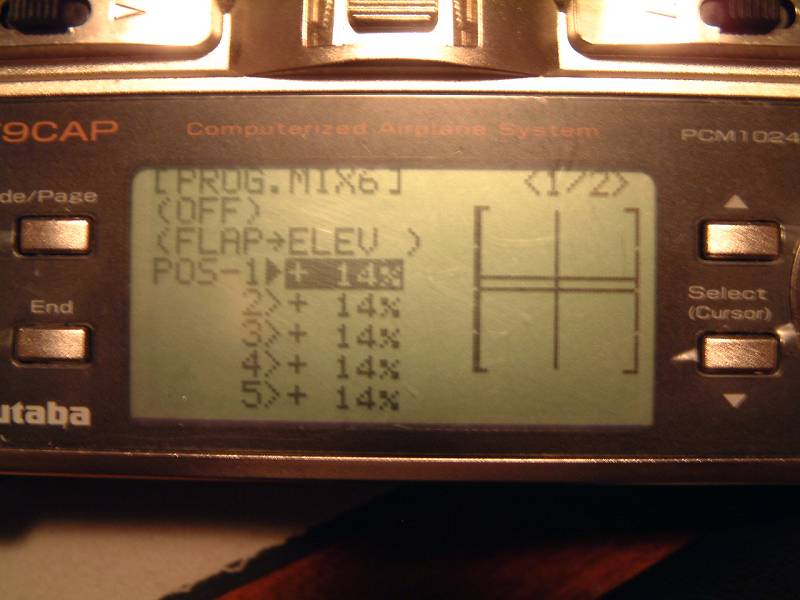

Alrighty then, let's try this…
Using the airbrake above to obtain the crow, use Prog Mix 6 or 7 as shown in the photographs. This will provide:
1. Sw C Up - no crow, no flap.
2. Sw C Centre - no crow, flap stage 1 + elevator trim ( positive or negative as needed).
3. Sw C Down- crow, flap stage 2, elevator trim per airbrake, plua a bonus of time delay trim if needed.
(Percentage shown and direction is arbitrary for illustration)
Dennis

Yes. That is the answer! Use pmix6 for take off flaps, like that: mix throtle with aileron. you have five positions,so:
thr 1st pos. ------- ail % desired
thr 2nd pos ------- ail same% as 1 st pos
thr 3rd pos -------- ail same% as 1st pos
thr 4th pos -------- ail same % as 1st pos
thr 5th pos -------- ail same % as 1 st pos
Use switch c to activate the mix (center pos.). For landing flaps use pmix7, same way but with % you want. Switch c to activate the mix, but now down pos.

[:@] For up elevator just mix elevator with itself, using the offset. Mater offset ------ slave elevator. % desired . switch c center pos.

Are you using the flap channel as the master and the elevator channel as the slave? If so, I would suspect that the elevator can not be made to move because the flap channel is at its "zero" position at takeoff setting and 0 times any percentage is still 0. If you want a fixed amount of up elevator with takeoff flap, use "offset' as the master and "elevator" as the slave. Enable the mix with switch "C" in the center and dial the percentage you want for the required elevator movement. You should always be able to get a surface to move a fixed amount at a certain switch position with a mix with "offset" as master...

Fantastic...works perfectly.
