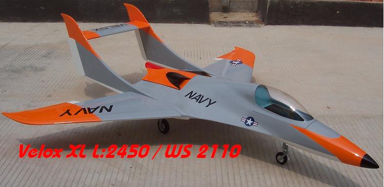

New Giant Velox XL
just came in last week before the Jetpower show
i just started working on it , and hopefully will be flying in a week or 2
some details:
Length : 2450MM -96 inch
Span : 2150mm-85 inch
weight of the kit was 6.9 kilo,s - 15 pounds
power needed 80-160N
Wheels Front 75mm
Rear 100MM
Jet-1A Main oleo,s
will keeo you informed about the build and first flights
i will be powering it with a Merlin 170

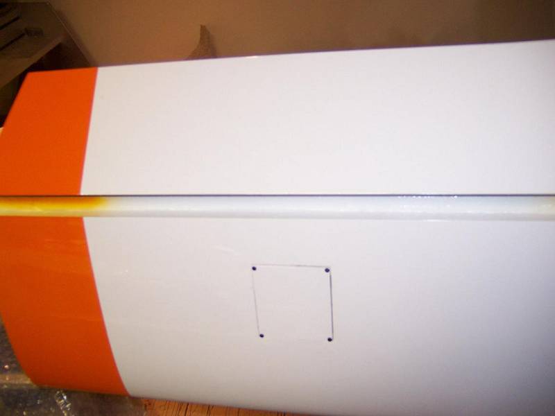

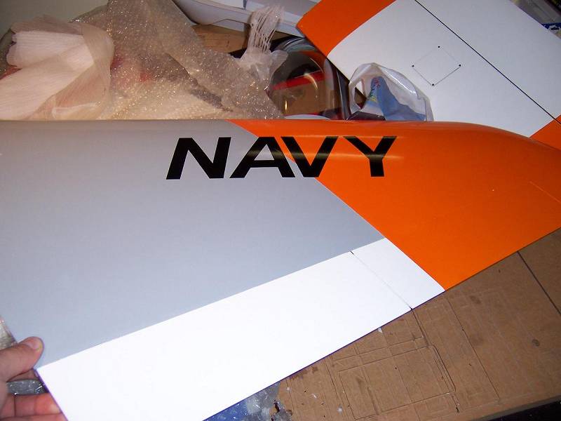

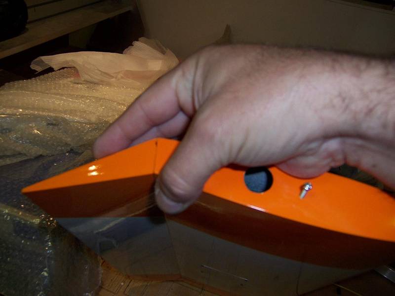

we will test this one first , and after they are ok , i guess they will hit the market.
i hope promisses are made this time ,we have some changes done like a GIANT fuselage to hold lots of fuel ,and smoke tanks.
i think we can use a UK cider bottle of 3 liters and still put 2 liter bottles aside the big one.
the merlin looks small on this huge thing.
the Landing gear contains the wheels from the MB-339
the front oleo comes standard trailing , the aft oleo,s where strait.
i exchanged them with the jet-1A with the heavy spring.
the jet-1a where specialy designed for them.
here some more pics of the new wing and elevator design..no more hinges!!

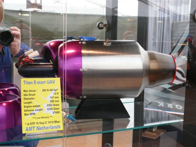

Try it with the 40kg (88lbs) thrust AMT turbine
Old 09-26-2007, 07:03 AM
digitech
My Feedback: (10)
digitech's Avatar
Join Date: Aug 2004
Location: klimmenlimburg, NETHERLANDS
Posts: 3,653
Received 10 Likes on 10 Posts
Default RE: Fei Bao : Velox XL !
ORIGINAL: SJN
Tried me a pegasus once

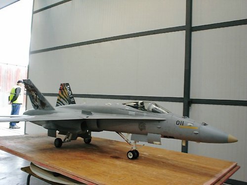

Trust me, it works, you put your main fuel tank in the other engine bay plus your batteries etc. this takes care of the weight situation. You might have a small off centre balance when the tank is empty but remember your single turbine is very close to the cetreline. The thrust being slightly off centre does not seem to affect yaw from the models I have seen fly.
Here is a good example. David Matthews flew this single engine F18 at the WJM in this configuration. The straight pipe also cuts down the power loss of a bifurcated pipe.
John
