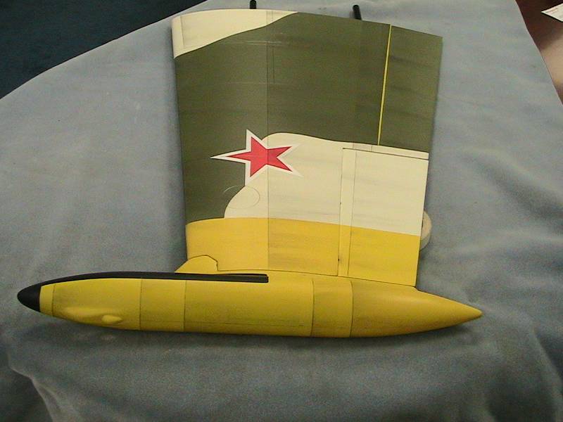

Hi Guys,
What do you use to weather your jets, to give them that used but not worn out look.
I am looking for tips on how to achieve a reasonable finish.
Tips and photo illustrations would be much appreciated.
Thank you,
John C

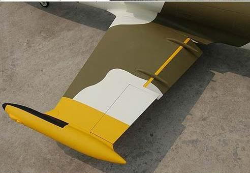

Old 10-10-2007 | 03:54 PM
Joined: Jun 2005
Posts: 423
From: Cardiff, UNITED KINGDOM
Default RE: Weathering. How to do it???
Thank you for all the info,
How about sharing some photo's of what you think looks tastefull as far as weathering goes.
Attached photo by Tailhook looks great all I need is the info on how it was achieved.
All the best,
John c

Old 10-12-2007 | 02:47 PM
Joined: Jun 2005
Posts: 423
Thank you all for your help.
It seems as far as weathering goes less is more with our larger size models.
The Tom Pierce site is great, nothing hidden, no mystical/magic. Just plain and easy to understand instructions with lots of good photo's.
John C
