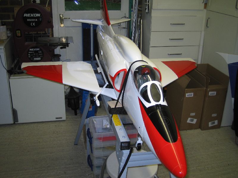

more.....

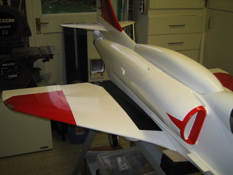

Hi Marc:
Your install is architectural in quality just like I love to see it.....Tnx for the photos......will absolutely be of great help when I get my kit....

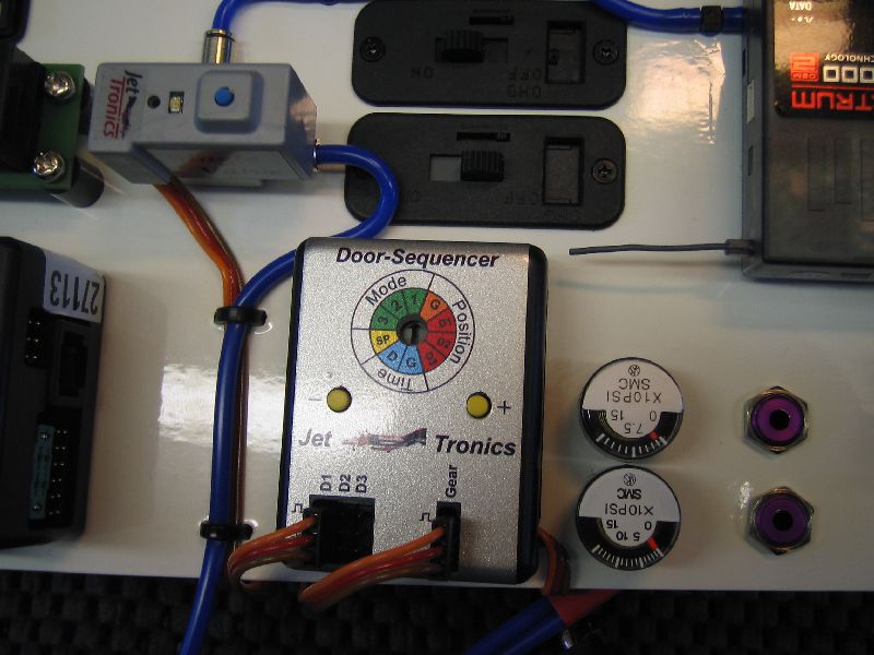

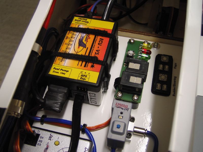

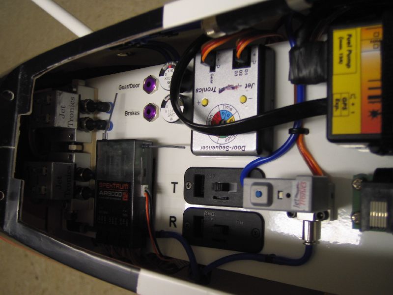

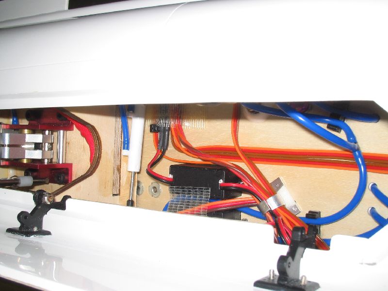

Looks really good, i like the electronics layout.

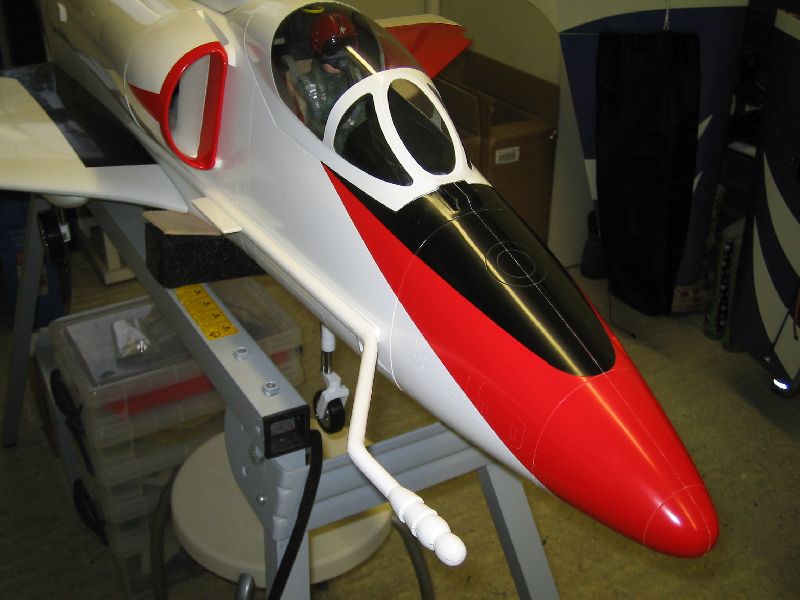

I pulled my P-70 out and am gonna get a P-60 to go back in trying to get it as light as i can, while it's down I'll do my best to work on those wheel blisters i finished up the avionics hump on the other day and built the tail hook assembly and have it ready to install for air actuation up/down, I'll put the fuel probe on when everything is completed, i put it on my VA-144 version before everything was done and it almost got broke off a few times

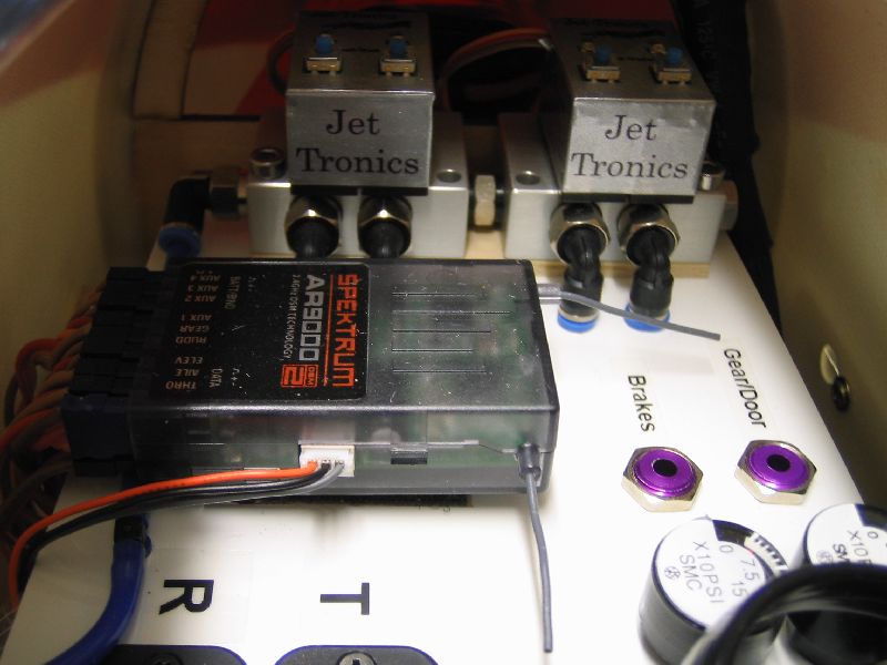

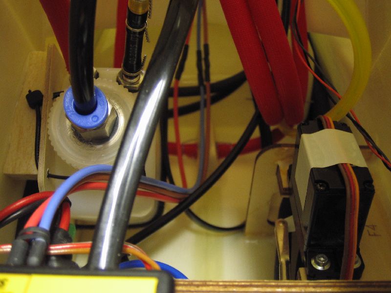

Marc,
Once again your work is stunning to view.
I noticed your BVM air fill valve are flush with the retaining nuts, do you just push a 3 mm line in the valve to fill the tanks?
How is your Jepe Roto Finish racer coming along.
Bob

Bob,
Regards the air fill, yes from what I can gather, just push in some 3mm OD and fill - I pressure tested the systems by filling this way and seems to work fine.

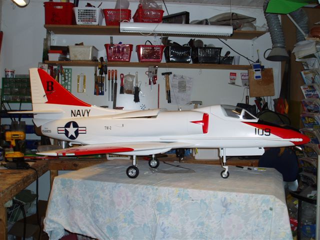

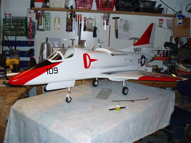

Your A4 is really looking good, Marc.
I have almost finished mine. Hope to fly it next weekend.
