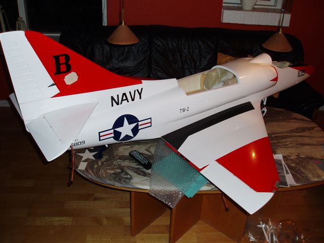

Tam.
That is a fantastic looking Scooter. Great job.

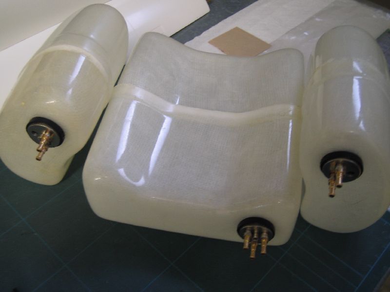

Old 10-23-2007 | 10:27 AM
  #28
Stig Andersen's Avatar
Joined: Feb 2003
Posts: 1,277
From: Nordborg, DENMARK

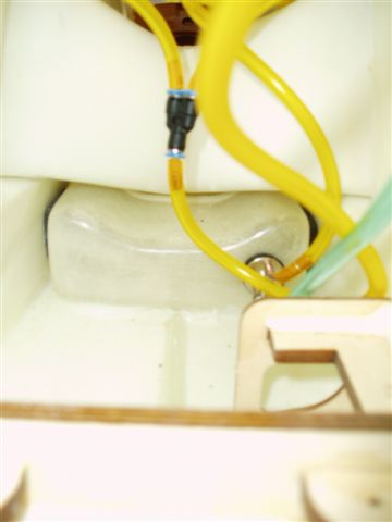

Default RE: Tam A4 Build

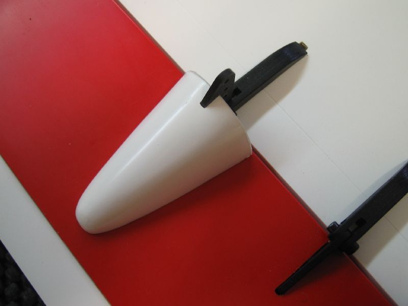

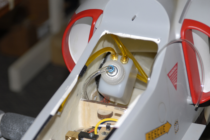

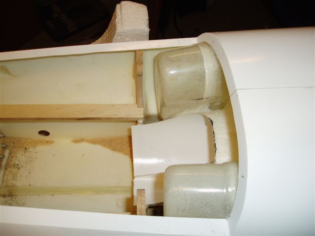

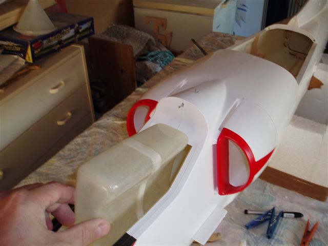

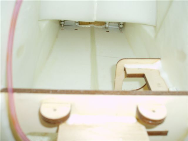

Hello Tam.
I just tried to install the main tank, but couldn't find a way in. Is there a trick or di I need to cut away a peice from the cockpit opening to get it into the fuselage.

Old 10-23-2007 | 11:23 AM
  #29
cactusflyer's Avatar
Posts: 1,473
Received 2 Likes on 1 Post
From: Anthem, AZ
Stig,
WRONG HOLE! ...and you can quote me on that! The tanks go in from the back hatch.....It looks like you have glued the intake duct in so that may be a problem. The instructions show how to make a small plywood piece to screw the ducts in so that they can be removed for servicing. Here are pages 17 and 18 from the manual. Sorry about the poor quality...I did a quick scan and paste..........
Tailwinds,
John

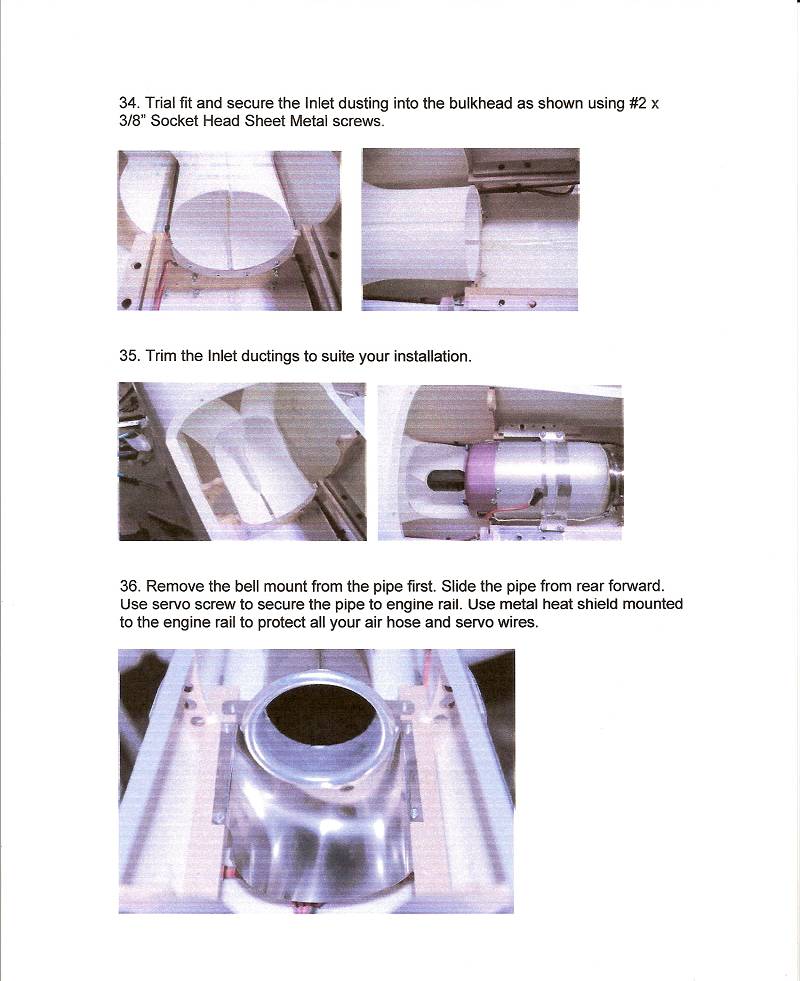

Old 10-23-2007 | 12:16 PM
  #30
Posts: 4,586
From:
ORIGINAL: Stig Andersen
Hello Tam.

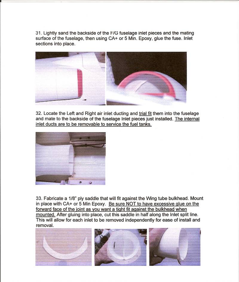

Stig,
I can remember how to do the tank. Wait a minute. I'm flying on Lipo fuel. No tank needed.
Anyways,
John just explain it. You want the ducting able to remove for service.
The tank going from the engine hatch. The inlet ducting can be zap with CA after the tank install . That way you can easy remove the inlet ducting if need service.

Old 10-23-2007 | 12:35 PM
  #31
Joined: Feb 2003
Posts: 1,277
ORIGINAL: tamjets
OK, I see. [sm=bananahead.gif]The inlets were already glued in when I got the kit....... I hope I can break it loose again without damaging it. I'll let you guys know how it went.
Thanks, guys.
Thanks, guys.
That is easy to break loose.

Old 10-23-2007 | 02:43 PM
  #33
Joined: Feb 2003
Posts: 1,277
Hello tam.
You were right. It was easy to break loose. I finished the fuel tank installation tonight. I used silicone for the fuel tanks. It is easy to cut through it with a sharp knife, should I ever need to take them out. Sorry no pics today.

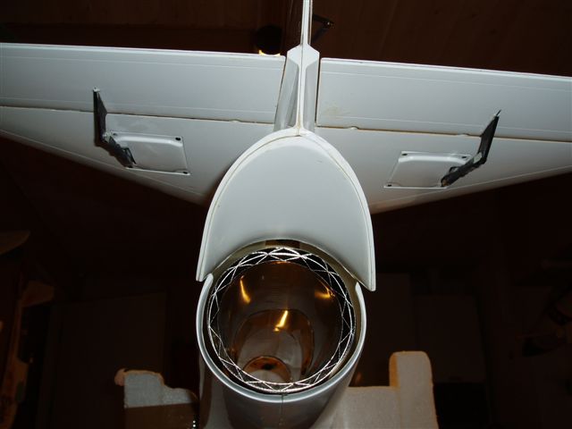

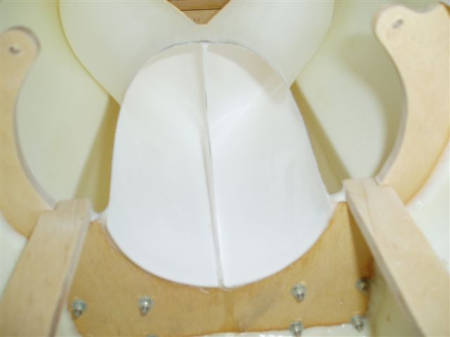

Hello Marc.

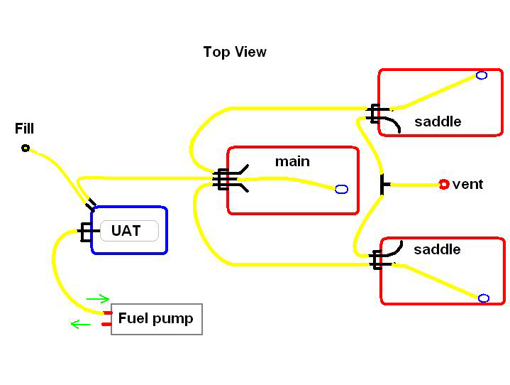

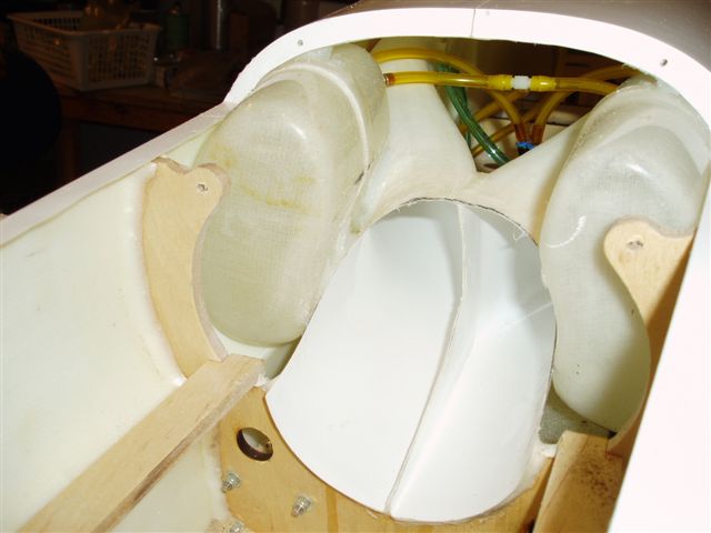

Thanks for the advice, but I mounted the tanks with silicone yesterday and I found today, that there is enought room to run the air hoses and the servo leads on either side of the main tank. I made sure that there is approx. 10 mm between the fuselage and the main tank on either side. Using my Dremel, I made a hole in the bulkhead where the leads and hoses can pass through. I think it is OK.
BTW, Tam. Where do I put the UAT?

Stig
with the saddle tanks siliconed in like that you're gonna have a hard time getting the support brace bolts in place. UAT goes as close to the nose as you can get it to help with balancing.
I left about 15 mm of space between the bulkhead and the saddle tanks. Should be enough for the brace, washer and nut.
I'll see how far up front I can get the UAT. Thanks

i put my fuel pump, smoke pump, ECU batt and Duralite batt all in the nose cone and had the UAT under the cockpit floor, balance worked out perfect.

OK. Thanks for the advice. I figured that the model neede weight in the nose, but I'm confident that I can put all my gear in the nose section to avoid having to use lead for balancing.

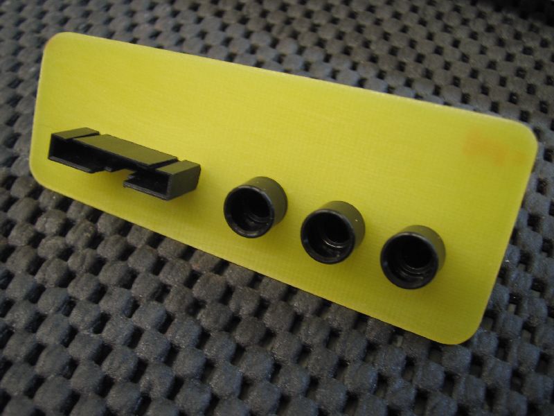

Old 10-27-2007 | 02:05 PM
  #43
marc s's Avatar
Joined: Jan 2007
Posts: 3,294
From: farnborough, , UNITED KINGDOM

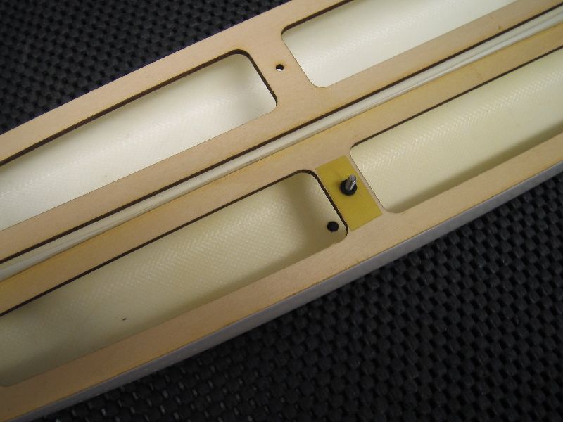

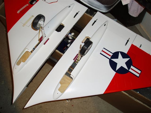

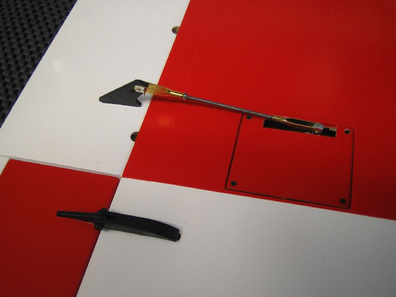

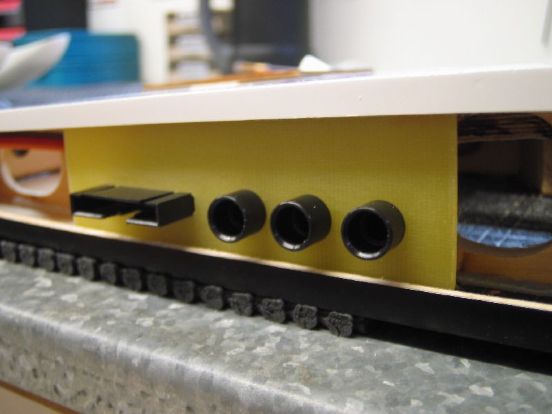

Update.
Working mainly on the wings, have decided to instal the gear leg pod ply frame into the fiberglass mounding first and then trim it as required, it seems to provide a more sturdy method especially with the fixings to the wing.
I am unsing M3 bolts into blind nuts set below the wing surface on ply plates, the result seems solid and easy to remove (2 bolts)
Built and assembled the servo and air connection panel, which will get Aeropoxied into the wing once the gear is in and connected up, once this is done I will cut the corresponding shape out of the fuselage and install the opposite mating panel.
Tanks all assembled, to make sure things remain fitted I ground down some brass Festo barbed connectors (one side) and soldered them into the tank pipe ends, this gives a better purchase for the fuel pipe. All connections are wired.
Painted the inside of the wing area where the wheel retracts into to make it look a little more pleasing to the eye.
Now just waiting for glue to dry[]

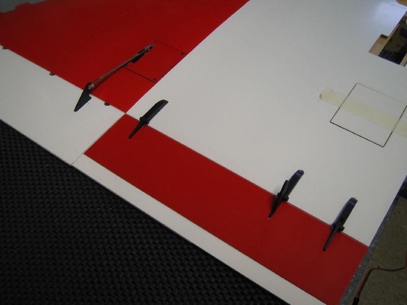

Old 10-27-2007 | 02:45 PM
  #44
Posts: 4,586
From:

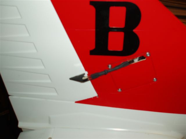

Marc,

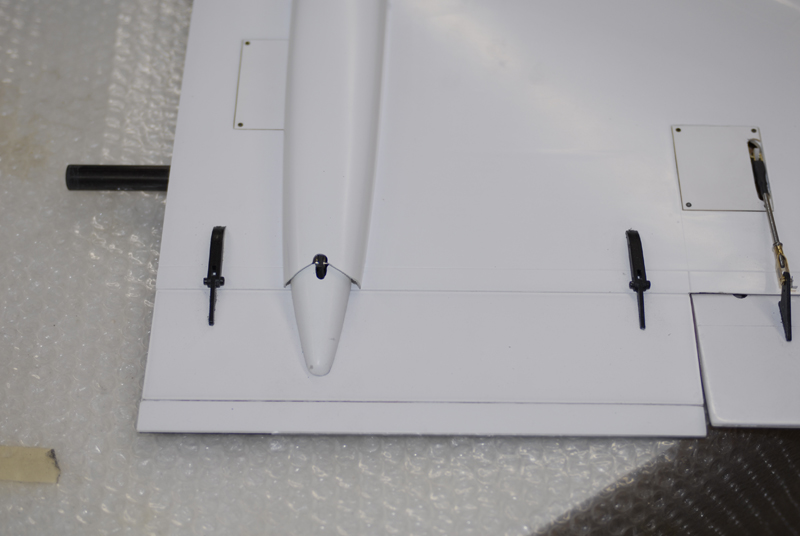

The split flap you had it on the wrong side. White be outside and red inside.

UAT tank

Old 10-27-2007 | 03:45 PM
  #46
marc s's Avatar
Joined: Jan 2007
Posts: 3,294
Tam, unfortunately this split flaps were taped on this way round so I assumed this was the scheme. If push comes to shove a little paint will remedy - I kind of like it but I would seeing as it's this way round now

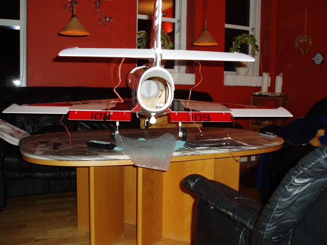

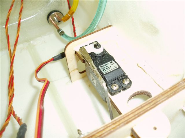

I got some more work done on mine. Hoping to fly it next weekend. (Nov. 10th)

Stig
looking at your pics you only have two lines from the main tank, an in and an out, for me it worked best to have two vent lines out of the main tank, one feeding each header tank, it gave better filling without allot of main tank and UAT swelling and better even draining of the saddles.

Yes Stig, I would do this, it will make your fuel pump work easier and last longer.
Old 10-31-2007 | 04:29 PM
  #50
Posts: 4,586
From:
ORIGINAL: ianober
ORIGINAL: KC36330
Stig
It a must....The main tank can crack easy under high pressure when filling. This dual vent to saddle tanks at least reduce that problem.
