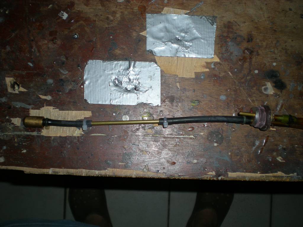

Hi Wess:
Thank's for the words.
I know how hard is to put one of these jets in air so I'm gladd to hear from others doing great too.
Look, maybe I can save you and others a possible issue.
See photos.
I had a flame out due to a mid air fuel starve.
Clung goes all the way to the front of the tank in a dive and stuck.
System starts to pull nothing but air.
Turbine shuts off with tanks at half capacity.
Solution:
Install a longer pice of brass tubing as depicted to avoid this happening.
Hope this help.
Juan.
