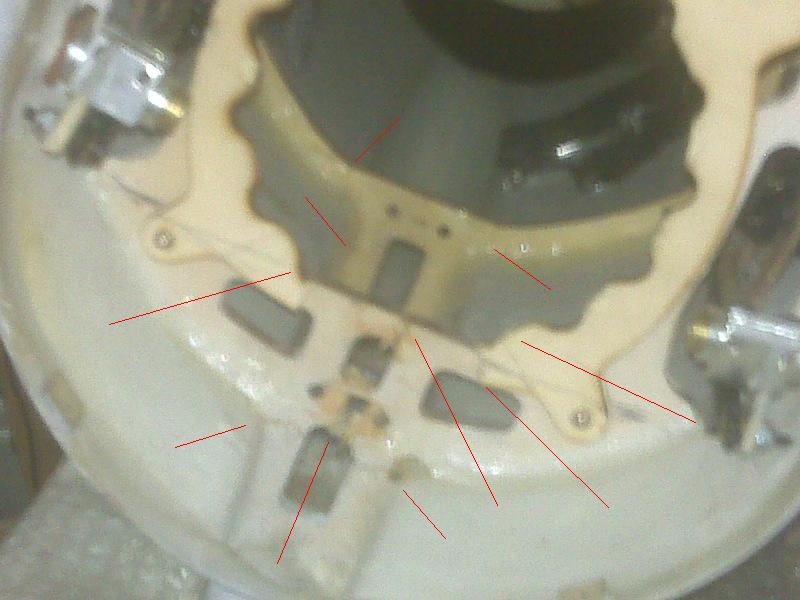

john, i have maidened my f16 advanced with p80SE 3 weeks ago and this plane is already way too heavy. avoid that dead weight at all cost. i balanced mine without the need for any weights. turbine almost max forward, with batteries at nose.
BTW, just for everyone, on the second flight the whole vertical stab fluttered violently on a pass and luckly the plane flew ok and landed fine. the whole veritcal stab with the rudder including the fin base were like butter. i was luck it didnt blow off in flight.
upon inspection back at home, the two formers on the pics were shattered making the fin base soft and thus flutter. i glued them back in and made 2 formers as attached in the other pic and increased their length so they go deep in the fin base and glued them behind each of those formers. Rock solid now. flew it later with no issues.
the pics aren't the best but i hope you all get what i mean

The first issue was the front retract would not fully retract. causing the door not to close properly.
The solution was to drill another hole in the crank closer to the pivot point, effectivley giving a longer stroke.
After the mod.

The second issue is a bit trickier to resolve, which is there is a fair amount of 'toe out' on the main wheels. I noticed when pushing it by the fin on the smooth tarmac there was a fair bit of resistance. With a take-off weight of 29lb with a p70, drag was the last thing i needed.

hi john,
how did you fix that "toe out" cuz i had a rough landing and one of the mains has this now but couldn't get over it.
KAON
Old 10-20-2010 | 06:05 PM
  #2065
Joined: Jan 2010
Posts: 978
From: glasgow, UNITED KINGDOM
Default RE: FLy Eagle Jet Models
It simply comes from the fact that the drag link is too long.
The unmodified lenth is almost 21mm
Reducing it to this size gives a very slightly 'toe-in' angle.
But this obviously puts the hole for the pin in the wrong place so i have filled the hole with JB weld and hopefully after that sets i can drill the hole at the correct spacing.
The former that the main retracts are bolted too, has been glued in squint so the two sides are different lenths and will have to be done individually.

Hi KAON,
If yours only happened after a rough landing, it may just be the bolt that goes through the ball end of the drag link thats bent ? Or maybe the 'stepped pin' from the leg to the wheel hub is bent ?
Old 10-20-2010 | 06:33 PM
  #2067
Joined: Jul 2006
Posts: 45
From: Cairo, , EGYPT
that ball link was bent a little, straightened it up but still, not sure what u mean by that 'stepped pin' ?
KAON
The stepped pin is under the piece that rotates with the two cap head screws, with the grub screws either side holding the pin in place.

that aluminum ball link in the pic is bent and also where it sits got little oversized, so i have too much play... still brainstorming on how to replace that.

As you know i tried to fill the existing hole with JB weld and drill a new hole, but it didn`t work, the JB weld was too soft as the new hole had to be drilled halfway over the old.
So i`m in the same boat as you, i need to find a way of shortning that ball link. Tha amount of drag that this is creating is huge and if nothing else, will wear out the tires in no time !
