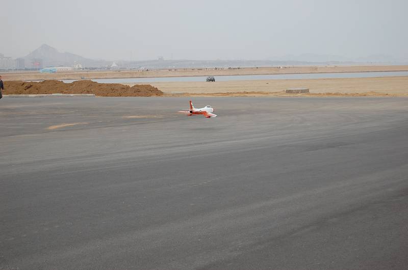

No, it's not. It's a JHI FJ2 ARF that I got from Larry Wolfe. I am working on getting some for our jet club. I have flown it for about 30+ times so far.
It works on P60 and Wren 44.
I hope we are not restricted to discuss just FEJ here.
I have some nice photos of these planes but some of them look too close to these skyscrapers.
This one is moderate by comparison. Am I OK to post these photos here?

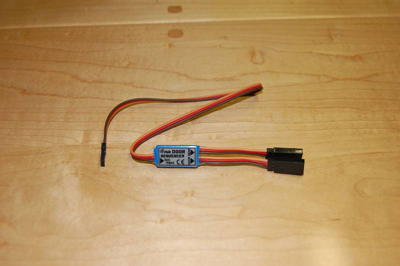

I promised a final installation photo some while ago. Well I am now finished.
I have a 2 cell LiPo for the engine ECU and a 2 cell A123 battery for the Rx. The ecu battery is along the side of the fuselage and the A123 is in the nose. This gives me the right C of G. All I need now is some nice weather. Snow, rain and cold winds forecast.
I also attach a photo of the Sequencer.
Just noticed that I have not fixed the little Rx aerials, one more job to do.

looks like you have 5 electronic air valves what are they all doing or have you used 2 for down gear/doors 2 for up gear/doors and 1 brake does that mean you y lead the orbit sequencer . on another note where did you get the orbit sequencer as can not seem to find a supplier in the uk.
Rob

Rob
The valves come as separate valves for each function, I need one for up and one for down. I have door cylinders and retracts so need 4, and in addition I have 1 brake valve. Yes each of the 2 pairs of valves are joined with a Y lead and these in turn are plugged into the respective branches of the sequencer. One valve is normally open and one is normally closed. The sequencer was bought direct from Orbitronic.de . I do not know anyone in the UK who stocks them.
I also have the Orbit valves for my next project and they too are very neat and light.
John

13dm
Just to make it clear a pair of these valves is the same as a single Jet-tronic type valve. I just wanted to try out something new, also the lightness attracted me. The price is much the same for a pair of these valves to the single 2 way valves.
John
