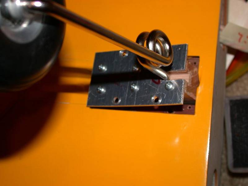

Old 11-26-2007 | 10:28 PM
Joined: Apr 2006
Posts: 5,962
From: Enterprise, AL
Default RE: Bobcat 50 Assembly Question
i guess I'm not typing out what i want to say clear enough you can understand it so I'll try pics, these are fixed gear for my boomerang, i made them so they'd drop perfectly into the retract rails. rather then plywood for the flex plate i used aluminum sheet for durability.
