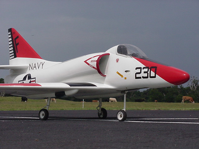

I had a few, love them
Never took more than 150ft with an OS91 and Dynamax and scale wing to get off the ground.
