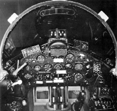

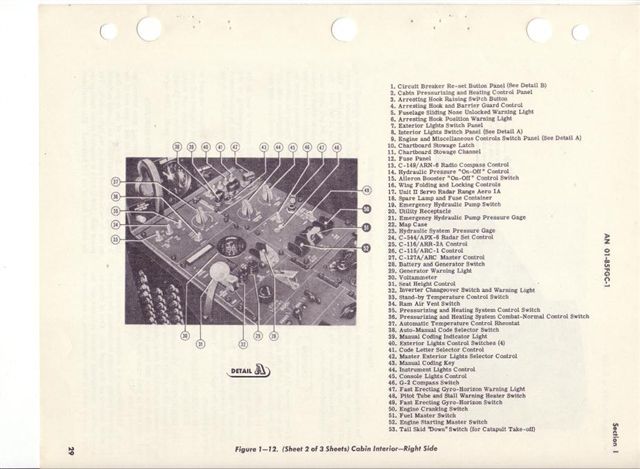

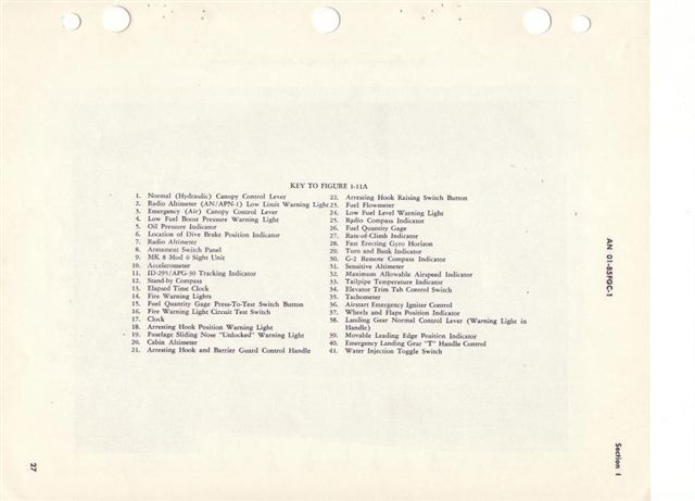

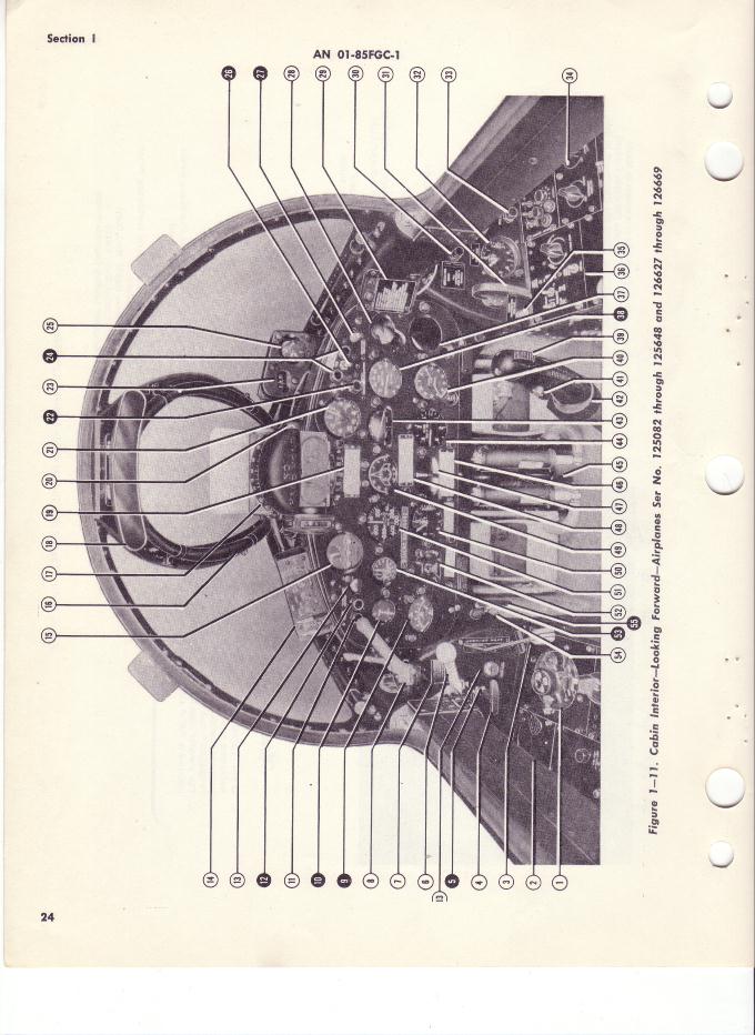

Tor I have the ones I used for the cockpit in my Ziroli and PSP panthers. Smaller than yours but for scratch building they will work Fine.I used the first one to make the Instrument panel. I printed out three all the same size and used them for templates to cut the panel out of .020 sheet styrene, with a sheet of clear with the picture under all, I used white styrene and have a High intensity LED behind hooked to my nav lights so the instruments are back lit.

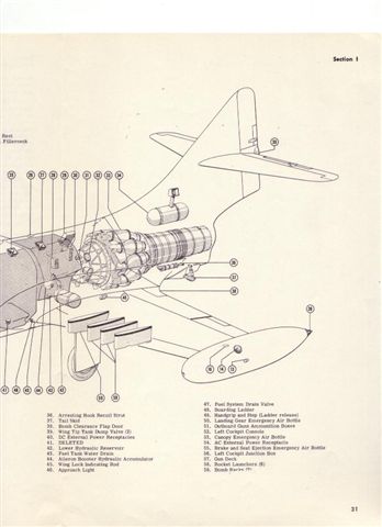

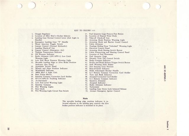

More Pictures. I got most of these from Dan Gill..
