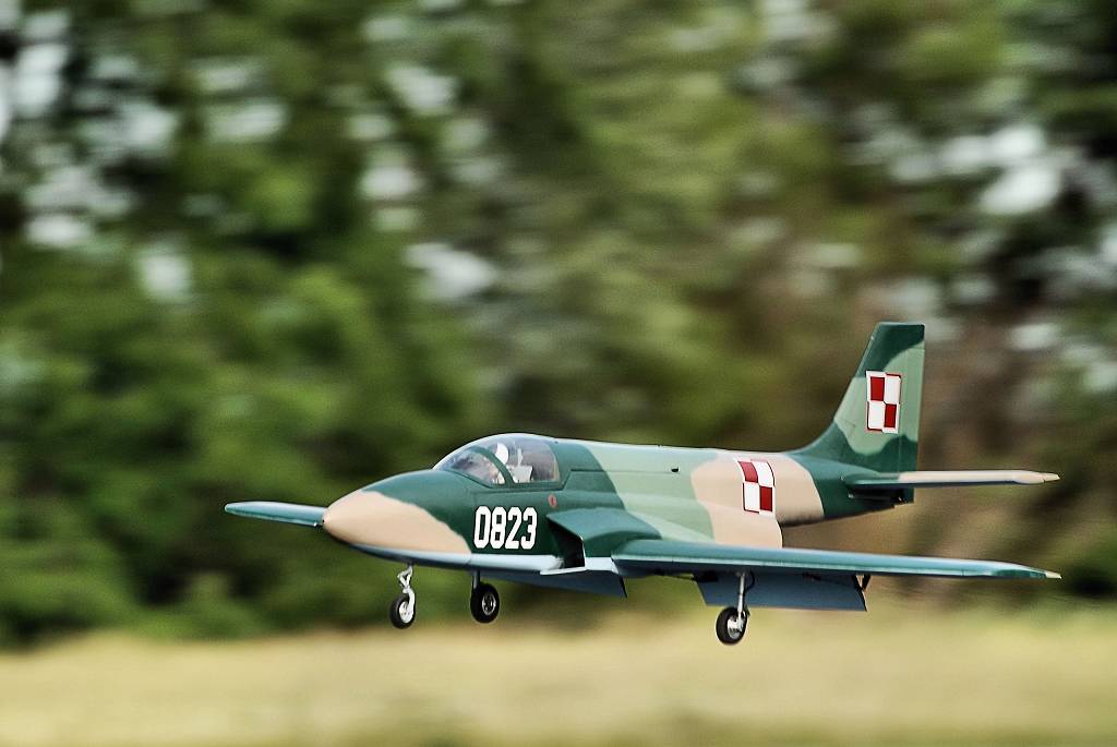

because I modified mine a bit I added some weight to it. It weighs about 23lbs without fuel. I run a jet Central Rabbit in mine (19 lb thrust) and it is about right. Good for about 140 mph (nose down) and plenty of power for quick takeoffs. I used Robart gear that's made for the Top Flight Beachcraft Bonanza. It fit with little modification to the plans and allows the plane to sit lower for the appearance I was after. I have over 50 flights on mine this year, and it has proven to be an excellent first jet. It comes in very slow if need be, and flies great. Here's a rough video of a flight at my home runway showing how slow it can land.
[link=http://www.youtube.com/watch?v=9rdq6NFpvPA]Iskra Flight[/link]

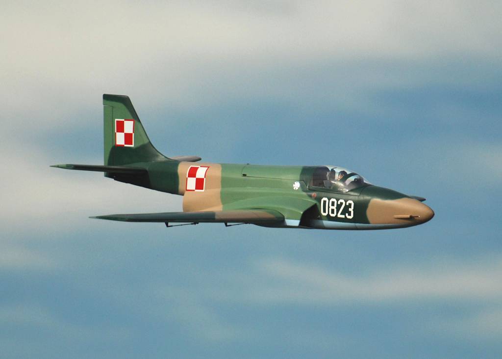

Finished Turbinator this afternoon. Jetcat p-70 Pro link gear, weight with uat full tank empty, 23 lbs
All dressed up and no where to go..........
Shep

Your plane looks great Shepp, I like what you've done with the wing tips. I'm sure it will fly as good as it looks. Make sure you post a flight report this spring. I got 75 flights on my Iskra Turbinator last year. I hope to make it to some jet events this year. Here's a couple of in-flight photos to get you in the mood to fly (like you need any help).

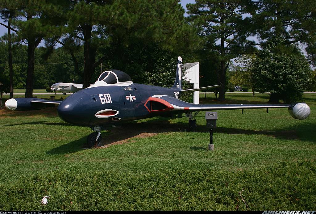

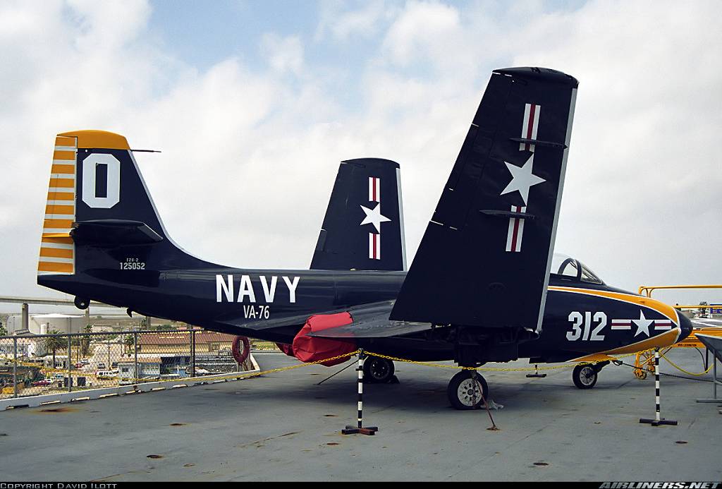

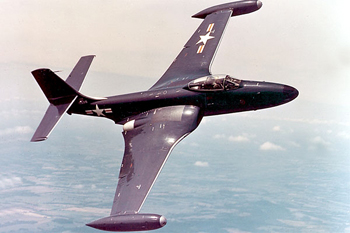

I hope you can make it down to Kentucky Jets, its well worth the 8 hour drive (about 9 or 10 for us). We'd love to see your Iskra Turbinator there. My son and I are building one that hopefully will resemble an F2H Banshee when we are done...

The banshee would look good. The wing has a distinctive look that would be hard to duplicate without a major change to the turbinator wing (straight leading edge, tapered trailing edge). The pods on the wingtips would be a bit of work but would add to the effect. Of course the Banshee was a twin, so you could make "fake" outlets and hide the actual turbine outlet under the fuse in the stock location. The elevator is quite a bit higher, the wing is up in not so low. With a bit of rounding and the right paint scheme it looks like you could get the desired effect.

We're going to leave the tail in the stock position and also leave the wing in the stock shape - I'm no aircraft designer and I don't want to change the flying characteristics. Our changes are mainly going to be rounding the fuselage, making the inlets look more like a Banshee - with the "fake" twin and the engine in the stock location as you said, adding the tip tanks (from a Ziroli Panther), and changing the canopy a bit.
That, and a Banshee paint job, should make it look "cool" and different enough that Louie will be happy with it. Oh, and we're also going to add BVM dropable bombs - for the "cool" factor too...
Bob

It does fly... and land too. Shepp

It has a Jetcat P-70 for power and I'm not sure why it weighed out at 23 lbs. I really don't trust my scales, but that is all I had.
First flights were performed by Scott Harris and he did have a few issues, all traced to the construction engineer and his apparent inabliity to follow the designers specifications
I built the stretch wing version ( extra 6 " span) plus tip tanks, and it looks like it is going to be a floater. You may note in the photos the two mounting holes for the tip tanks , these are removable and I have built winglets to go in their place. They look good and we may try them next.
