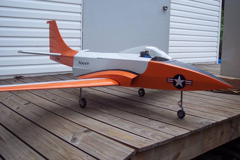

ok here are pic

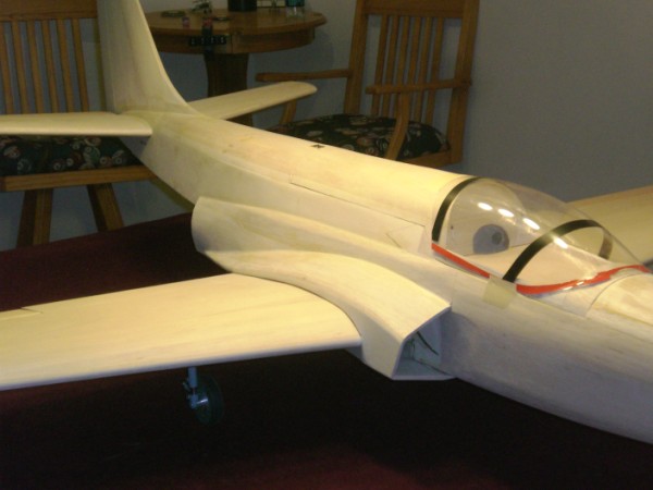

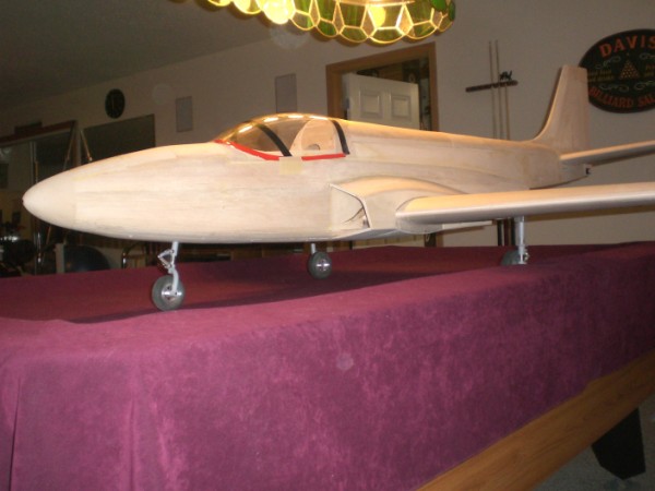

I'm switching mine to split flaps. I like the drag they provide and I am familiar with how they feel.
I mentioned I'd drop some photos of my modified turbinator and here they are. First you can see the significant change in the look by moving the canopy and rounding the plane out. I still have to add some balsa to the bottom to give it the proper look. Once I get the fuse done I'll sheet the wing and get the scoops put on it. I'm modifying the scoops quite a bit also. I moved the wing up 1/2" into the saddle which will allow me to bring in some of the air under the wing in a belly pan. Some of the air will still go over the wing (as per original). As you can see in the rudder photo I have shrunk the vertical stab and rudder quite a bit. I provided the stock rudder profile for comparison. I'm confident my rudder will be plenty to keep this plane stable. I hope to have it finished before spring, so I'll continue to post some progress photos.

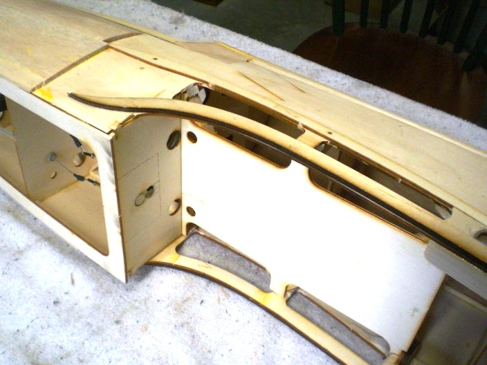

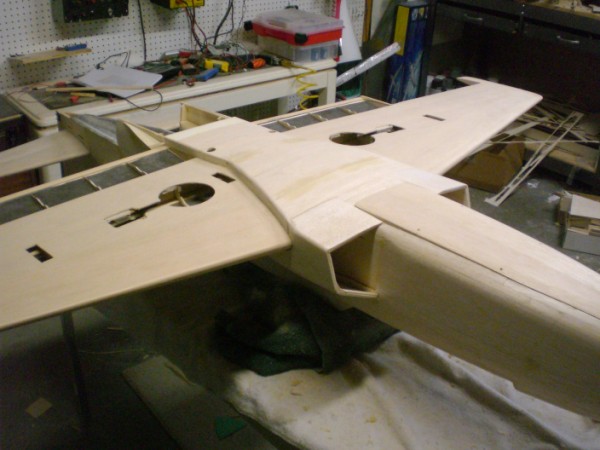

I'm making some good progress on my modified Turbinator. I need to get the wing saddle and scoops mounted, then add a bit more balsa to the fuse to get the scale shape I'm looking for. Here are some photos of my progress so far.

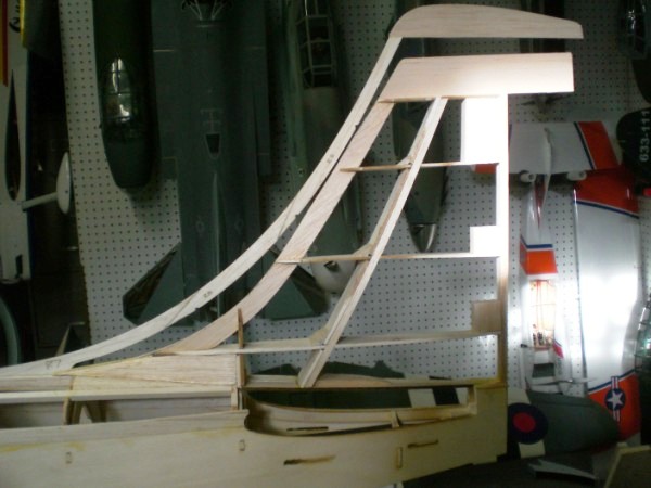

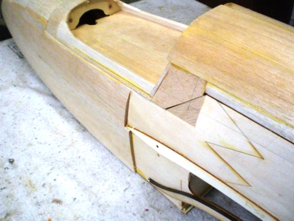

Here's a shot of the tail showing the modification I made to give it a more "scale" look. The Hor. Stab on the TS-11 is higher, so instead of trying to make it look perfectly scale I just made what I had look good.

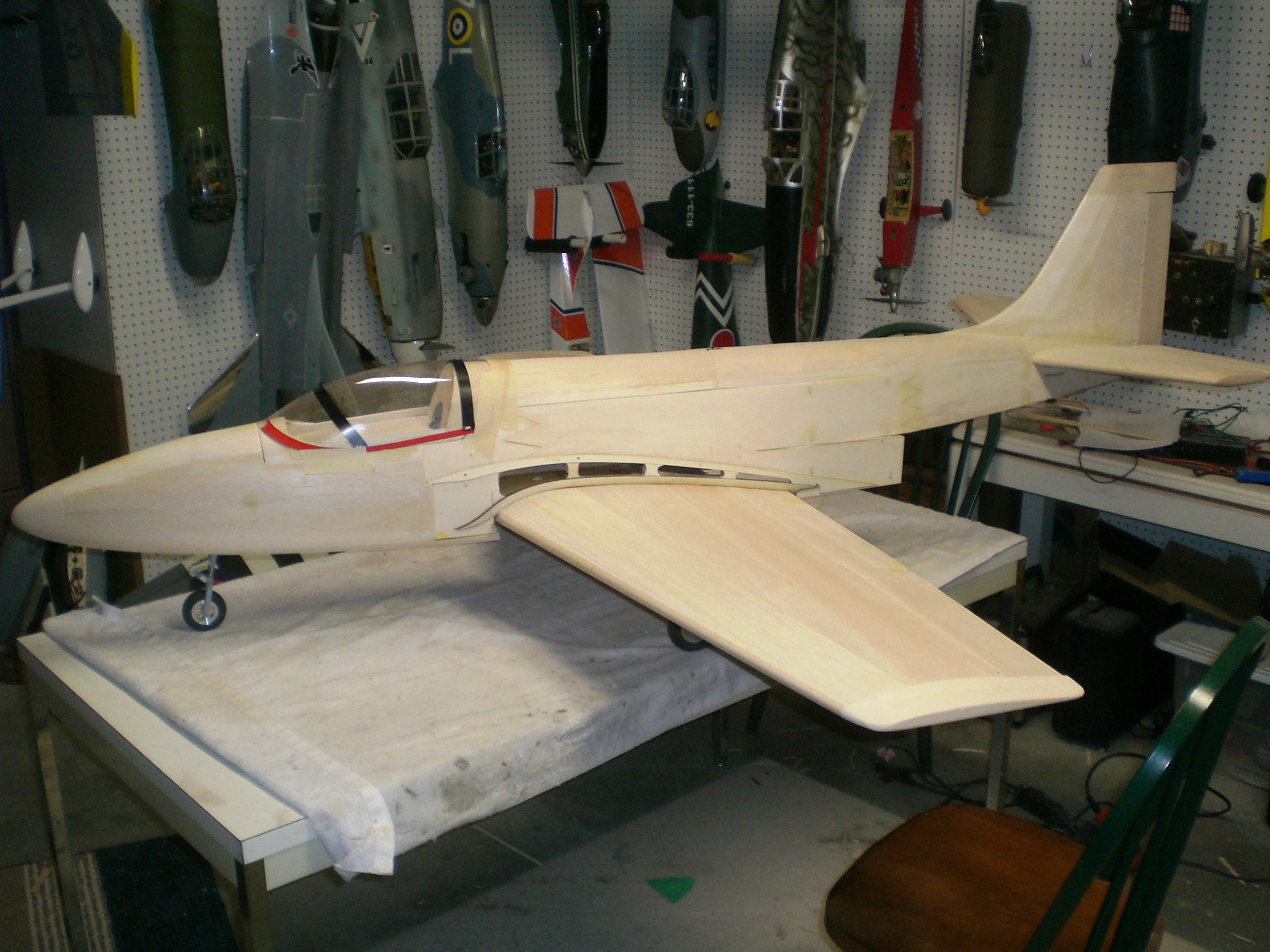

Making good progress on my Bash of the Turbinator into a semi-scale Ts-11. I have to do a bit more sanding to get everything the right shape, but the structure is done. I have to decide how I'm going to round off the leading edges of the intakes. I think the intakes and extra balsa near the jet exhaust add quite a bit to the scale appearance. I moved the wing up into the fuse 1/2", so I added some intake through the belly pan to compensate. Because it is a straight shot, I think I will have more air available than stock. Not much else to show until I get it painted. The next photos I post will likely be of the completed plane. I weighed the total bare plane with retracts and it came in at about 12 lbs. I should be able to hit my 21 pound dry target.

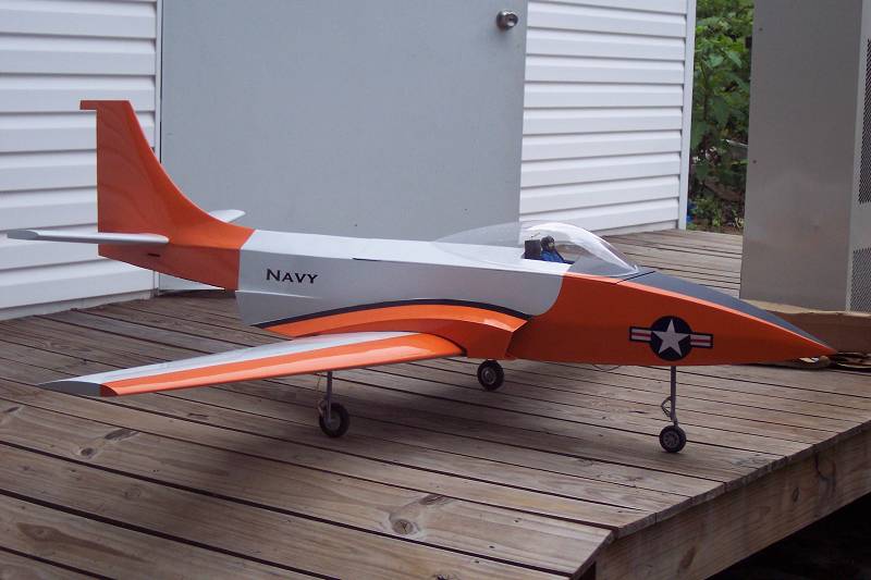

There was only one 200BR model, so I'll go with the scheme it had on it. Here's a profile and a photo of a model so you can get the idea.
