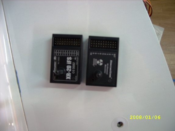

Hi,
I am sorry for my bad english language...
I have problems with the combo Graupner iFS... for my mx-22[&:]
After 10 minutes of operation the RX heats, she jams and any connected servos doesn't work.
Turning off and turning on the system TX and RX they don't bind him, it needs to wait at least 30 seconds because to bind.
I was effecting her first earth tests with the RX installed on a model without engine.
I have effected different tests both with the connected servos is without connected servos and the result it doesn't change, after around 30 second of use the RX heats especially in the inferior part of the case; I have connected a temperature probe on the case and after 30 seconds the temperature it reaches the 42-43° C.
I have used batteries Duralite LiMn 2S 3.800 mAh. connected through a regulator Duralite 5.1 V., batteries Sanyo NiMh 5 cells 6.0 V., Futaba, Hitec e GWS servos.
I have wanted to make other two tests...
I have turned on the alone RX, the TX was turned Off, first fed to 5.1 V. (Duralite Regulator) and then directly with a Duralite LiMn 2S 3.800 mAh to 7.4 V.
The RX heats however, after 10 min. of operation the thermal probe has marked 40° C. with the tension of 5.1 V. and 50° C. with the tension to 7.4 V.
Incredible...
The RX jams when it heats while when it is cold it perfectly works.
I have Effected a nth test...
I have used a damaged package batteries that at the most it gave 5.0 V. almost immediately gone down to 4.8 V.
I have left him connected to the RX for over a hour, the display of the digital battery voltage monitor has come to read 3.76 V.; everything has gone smooth as the oil, the RX has not heated.
In all sincerity I have to say that to the beginning the servos for some instant have started to go for their account and extinguishing and relighting the system the alignment is not gotten but the thing has lasted only some second.
I have repeated the test and when I have noticed that the servos began to go for their account I have had a strange idea and I have removed the antenna from the module; the servos have started over correctly working and so they have also continued after having put again the antenna at the module..
I don't know however if the resumption of the correct operation were to attribute to the lack of the antenna or to the tension of the batteries of the RX that kept on going down.
Certainly it is that the RX feeding to low tension, 3.6-4.8 V. everything has been all right and I has not found any malfunction.
Then I have contacted Jim Drew of the Xtreme Power Systems through his Forum of assistance ( [link]http://www.rcgroups.com/forums/showthread.php?t=777314[/link]) and him has recommended me to return the RX for the substitution.
Best regards
