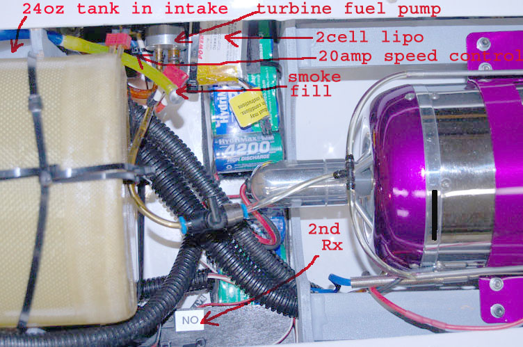

I built my own system. I had an old fuel that was not working for one of my smaller turbines and it will pump as much as 15 oz. a min at 7 volts so a 24 oz. tank will last less than a couple of minutes. I also have a second receiver that runs the system to avoid glitz interference on the main Rx system. I have the pump set up on a slider switch on my transmitter to vary the voltage so it will pump as slow as a couple oz. a minute which gives a light density smoke. A few clicks more and I can get a medium density smoke and of course at full voltage, it makes a lot of smoke. I am running dual stainless steel tubes from Tam with this set up on my Big Boomer. Most of my flights last 6 to 9 min and I have smoke on at least half the flight. I have been using SuperDri but I just bought a 5 gal. can of Freedom Form Release Oil to try. As you can see it puts out lots of smoke.

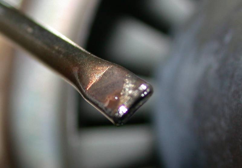

Thanks guys for all the responses, I should have made myself a little more clear when I said plumb the smoke system. What I need is a picture of the tubes going back to the turbine. How far away are the tubes from the exaust and how flat should I make the ends of the stainless tubing? Thanks again for all the good suggestions..........

Here is a picture of mine on the Big Boomer. I used the stock crimp that Tam puts into his tubes and it works fine.

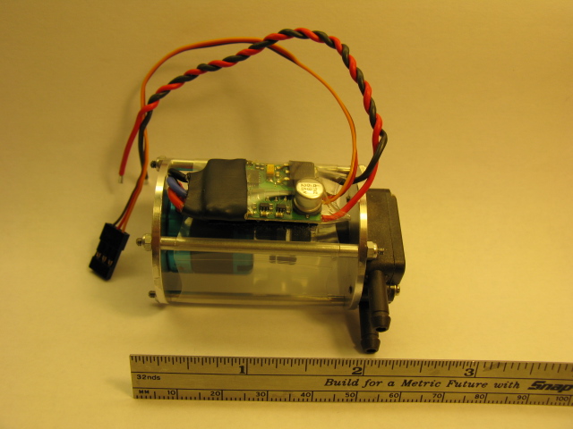

Old 02-05-2008 | 11:48 PM
Joined: Apr 2006
Posts: 40
From: Meadow Vista, CA
Default RE: Smoke system question.......
Hey guys, I have a smoke pump that might interest you. my father Don Harris manufactured the Don Harris Smoke Pump for over 20 years and retired 2 years ago. With the help of my father, I have engineered a new Harris Brushless Smoke Pump. It is the smallest and lightest pump on the market. weight 2.2 ounces, programmable flow rate. Please check out my website (pics and more info) www.harrismodelproducts.com The pumps retail for $160.00. I am offering a february special. please email me at [email protected] for more info.
Thanks, Chance Harris
