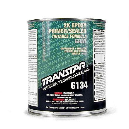

This methods works well.
Final sand surface with 400 dry.
Remove all dust and the go over surface with a tack rag.
Spray a light coat of flat lacquer (rattle cans work great) over entire surface.
When dry ( almost immediately), lightly dry sand again with 400 paper dry.
Again remove dust and tack surface.
Apply glass cloth and resin of your choice just enough to penetrate the glass and leave a dull surface.
Let this dry completely. The lacquered surface will prevent over penetration of the epoxy into the surface.
Next apply Transtar Epoxy surfacer either by brush, roller or spray. 1 to 2 wet coats. let dry overnight.
Rough sand with 320 dry and the 600 wet. Nice filled and primer surface with minimum weight gain.
