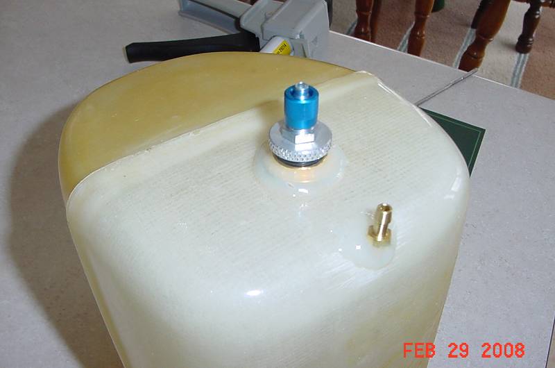

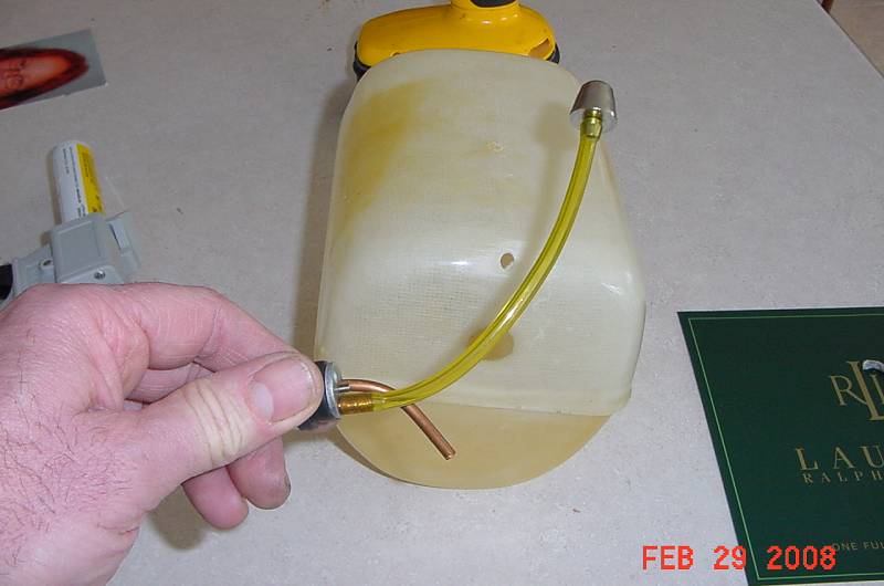

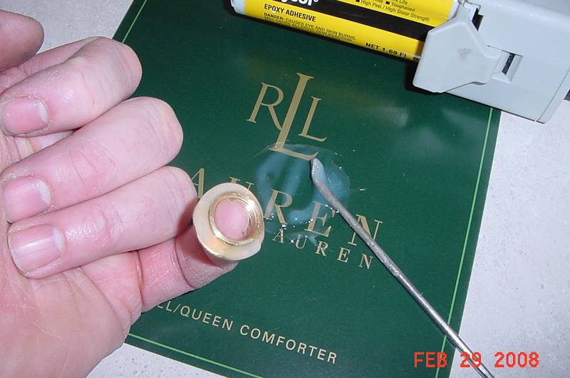

I am doing service on an f18 and noticed the clunks were not moving. So I took the tanks apart and found that the tygon supplied with the kit got super stiff and they would barely move. I decided to put some new oring type fittings in and get ride of the leaky black ones. The fittings fit the hole with out modifying the tank.

Yes, the so called tygon supplied by Skymaster and some other manufacturers are crap.
They are really stiff even when they are new, so most throw them away and installs real quality tygon during the buildig process. I also throw away the supplied black stoppers and use Du-Bro's instead. Don't know if it's nescesary though....
Liked the fittings very much. Looks nice

I thought that it was generally recognised that the tubing supplied with most Chinese ARF's is not real tygon and is too stiff for clunks. I always throw that stuff away and buy real tygon.
Most hobby shops stock Dubro Tygon, which is Tygon F-4040-A. Even F-4040-A should be replaced every two years.

Last month when I was there we tested the supplied tygon and found that it get stiff in two days, so Fei Bao is now supplying teh tanks with a new silicone fuel line (dark color) that is very resistant, we left in kerosene for 15 days and it was very soft, so if any Fei Bao customer need to replace their inside tank fuel line please contact me at [email protected] for the replacement.
